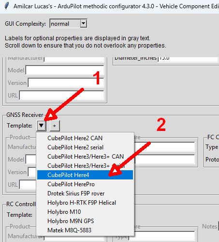

its not letting me post picture.

Yes, all looks correct
I never had the pull down menu to configure the Here 4
Am i suppose to be setting up from a blank template ? or Infer Component spefic?
The guy I purchased the drone from says it was already setup to fly and programmed. Not sure whether to start on blank template or not.
Thank you
Infer components from an existing correctly pre configured vehicle. Like explained with pictures some posts above.

Now I’ve watched the tutorial about AMC and I think my problem was that I was using the linux version and there were no templates populated. For some reason the installation was broken and the program asked about the template files and I did not know what this was about. So use the windows version for the starter to avoid these problems.
