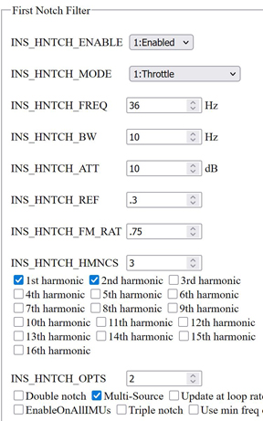

Nice work, it’s looking pretty good! The vibration levels are higher than desirable but based on what we know of the craft it’s not clear what you could do to reduce them.No clipping though.
You could give this Notch Filter configuration a try. I would suggest another review after setting it before a Quick Tune or Auto Tune attempt.
I think I can solve the vibration level. Balancing the propellers isn’t possible, but solving it mechanically shouldn’t be difficult.
thanks for filter settings. i will try asap. if it works, can i do quicktune with default quicktune parameters?
Yes.

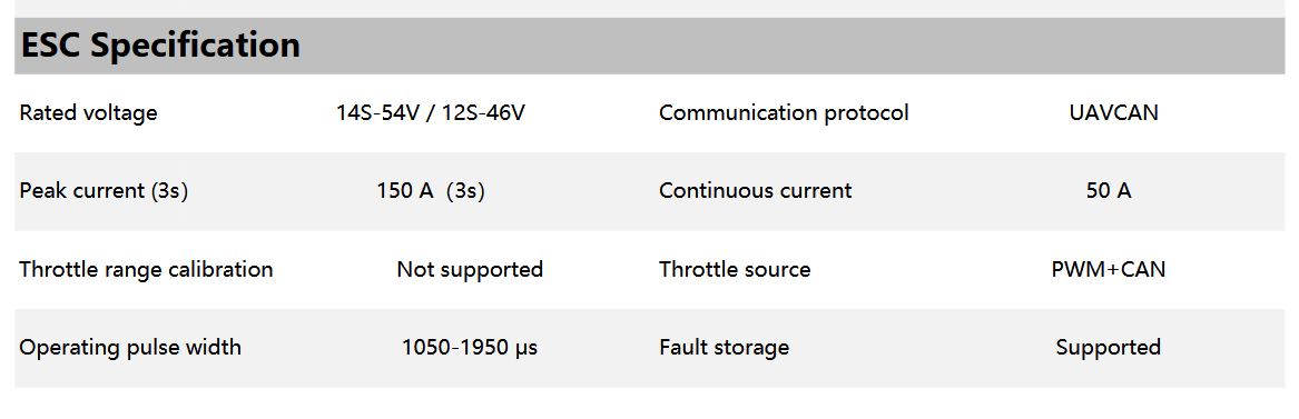

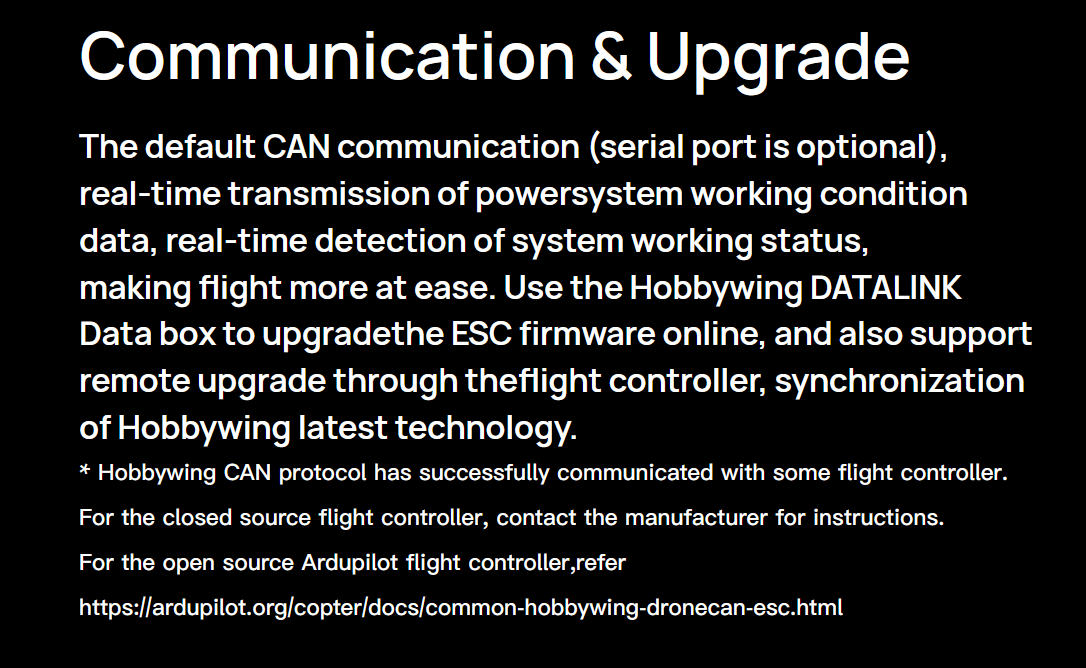

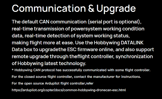

You don’t need datalink, CAN connection from FC is enough.
@mike_tk AFAIK the X11 need a datalink and will not just work with droneCAN. Have you tested them?
I haven’t seen anyone do this before without a datalink.
Not tried exactly with X11 plus but there is a reference on hobbywing website to use ardupilot
datalink must be used for firmware upgrade
