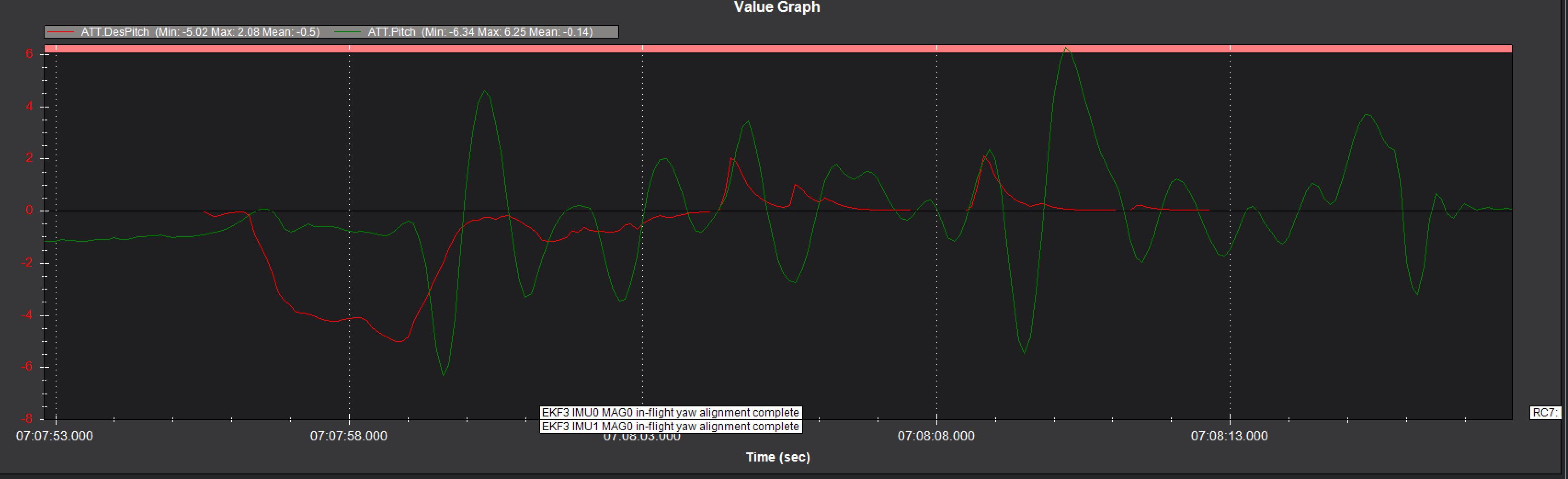

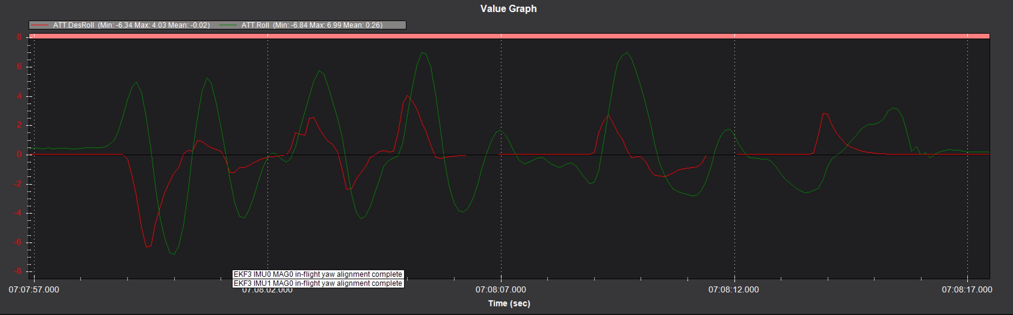

Unstable take off. Hexacopter with X11 Plus
İ created vehicle without fc and set parameters manually. İs there any way to create zip file from fc or i can send my amc vehicle without fc. İ set all parmeters same as hoverit x11+.
İ will try althold for hover throttle learn. Than i can start autotune. It was maiden flight and I was so excited I couldn’t keep my hand steady.
I would not recommend that. With this poor attitude control oscillation can reinforce and get out of control very fast.
A craft in a flyable state of tune will follow your excited and unsteady hand… That’s not what’s happening here. I think running Auto Tune in this state of tune would be a bad idea.

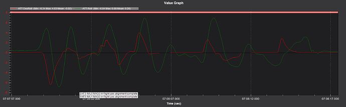

It’s not very useful, but it has a log of the first takeoff. It was not stable. what do you recommend?
The first flight can be done with default PIDs (skip step 16 completely)
The first flight is just a hover, no maneuvering at all. once that is done, follow instructions on section 7.1.1
