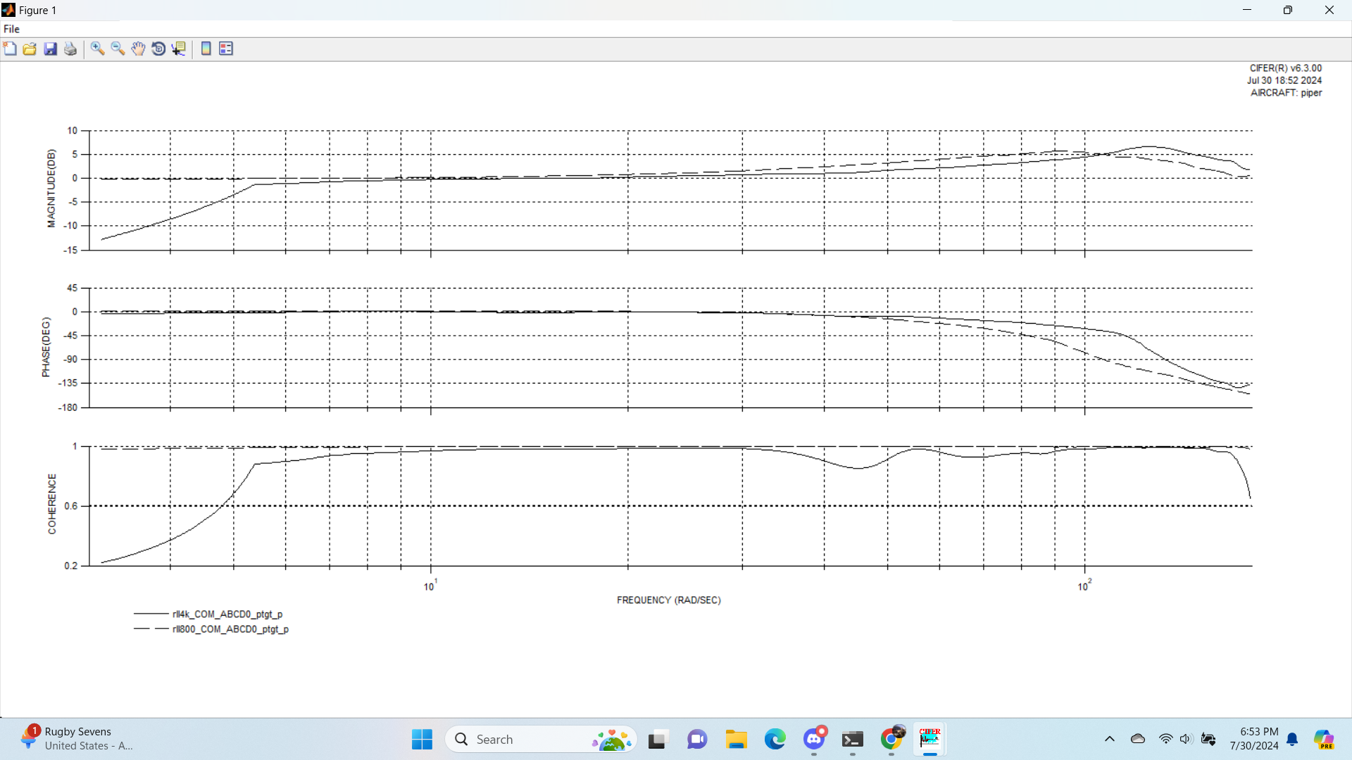

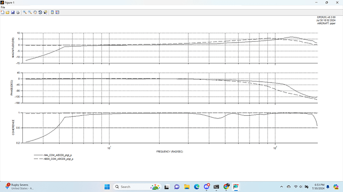

Andy provided logs containing Sys ID of the roll axis for me to analyze. The rate controller loop rates were 800hz and 4khz. It appears that they were both optimally tuned.
Here is a comparison of the frequency response of target rate (RATE.Rdes) to actual rate before filters (SIDD.Gx). Those were the parameters I used for the frequency response, but I am showing the target rate to the roll attitude in this plot. This is what is used to calculate the bandwidth for both phase and gain.
4khz:
Gain Bandwidth: 35.6 rad/s
Phase Bandwidth: 115.1 rad/s
800hz
Gain Bandwidth: 39.8 rad/s
Phase Bandwidth: 81.6 rad/s
The current practice used for manned handling qualities evaluation looks at the lower of the two bandwidths. In this case we gain bandwidth is the lowest bandwidth and would be considered the limiting factor for pilot in the loop flight. It is interesting, though that the lower loop rate has a higher gain bandwidth and the higher loop rate has a higher phase bandwidth.
I just wanted to get this out there. I think there is some benefit but it is mainly out a high frequency
above 15 hz.
Here is the plot of the target rate to actual rate. You can see that the tune pushes the rigid body mode to have some overshoot. You can also see the 800hz rate loop (dashed line) has more phase loss at the higher frequencies.

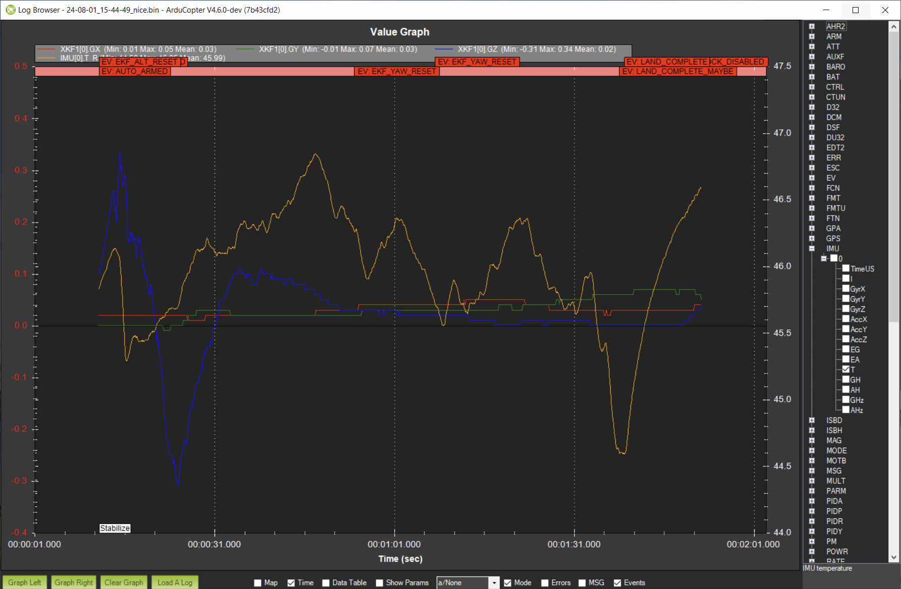

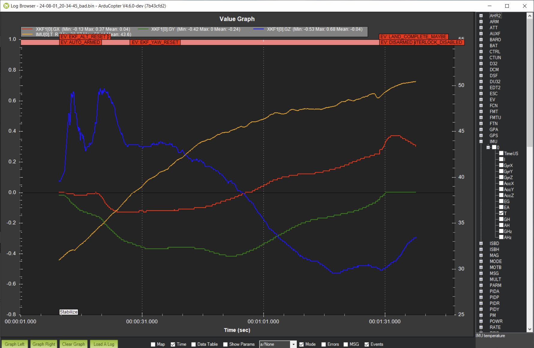

@andyp1per, how likely it is to accidentally ignore or misread AHRS_TRIM values in some of the flights with these changes?
I have calibrated trims of my copter quite well, even to the degree of compiling firmware for my 1Mb board with IMU temperature compensation and performing calibration. In >50% of starts it behaves nicely, drifting only slowly when sticks are let go (for autotune). In some <50% of starts, it starts up to four degrees off. In this case, power cycling typically make the next flight nice.
I don’t remember this to happen before I started to experiment with fast attitude rates.
Can you provide a log? Sounds like the EKF is learning bad offsets
I will try later in the day. I’ve had yet another case of this behavior earlier today, but the log was overwritten by a subsequent too long flight.
Here are two logs with rather nice behavior, and one log with a difference of few degrees towards the end of the flight.
Though I’ve spotted some unusual noise though at a frequency just below the propellers’ RPM, and I wonder whether this is responsible in any way. “Unusual” means that in some previous tests with higher (!) filter settings there was no such clear peak…
Your EKF is learning bad gyro biases and I would say its temperature related:
Okay, so fastrate is out of question, and I should attempt a better TCAL, right?
Certainly better TCAL. It’s possible they are related because the MCU will be working harder and therefore getting hotter.

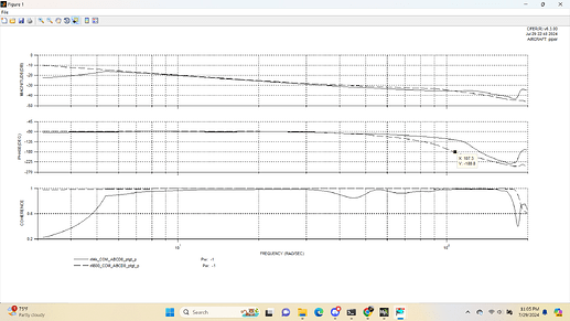

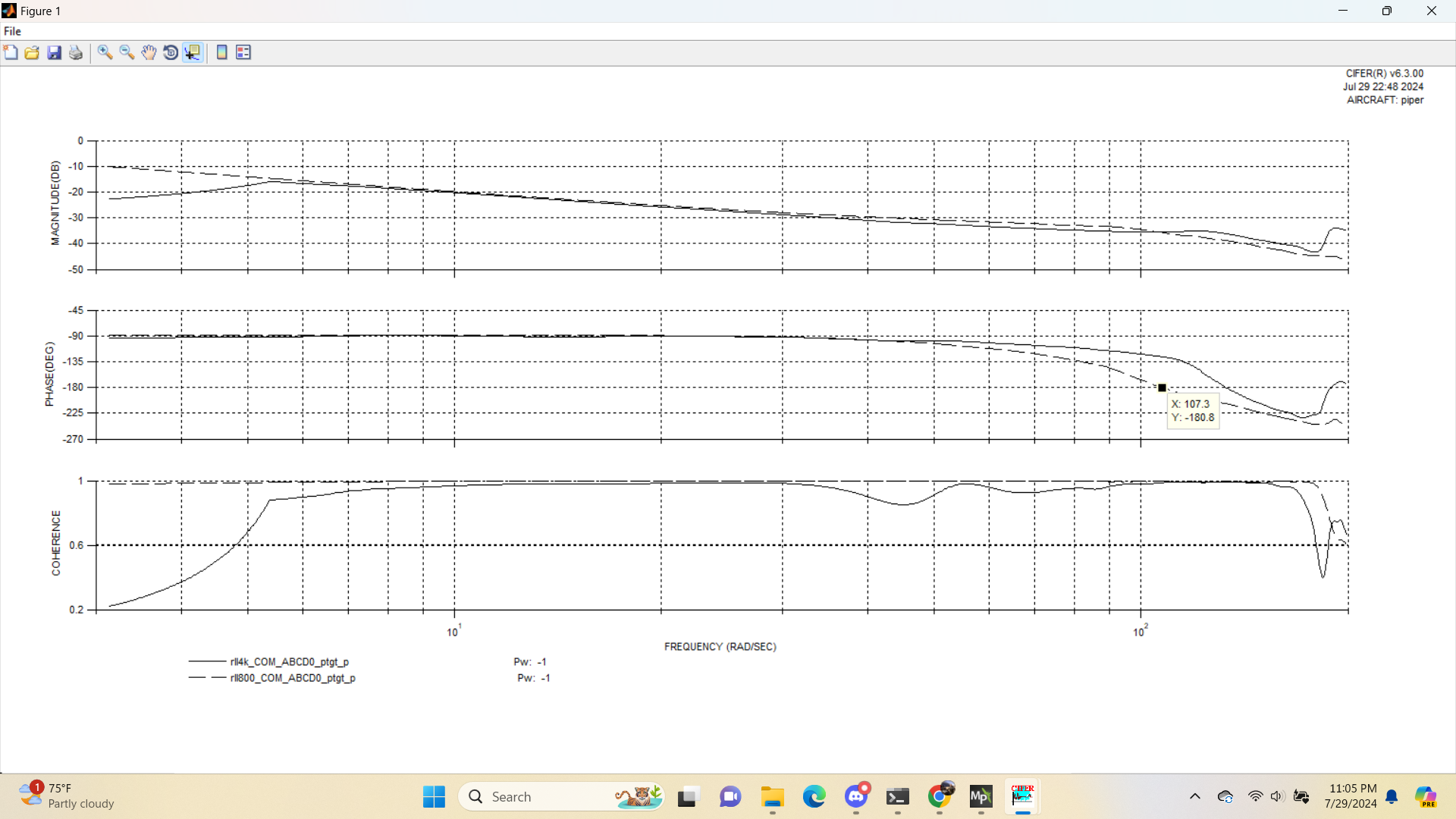

Here are some updated results. I’ll confess that I made a mistake in my previous post regarding the phase bandwidth. I’ll correct that and add an run that @andyp1per performed with the 4k hz rate controller using the same tuning gains as the 800 hz rate controller. This will provide a better comparison of the response difference with loop rate.
4khz with the same tune as 800 hz:
Gain Bandwidth: 46.4 rad/s
Phase Bandwidth: 87.4 rad/s
800hz
This shows that for the same rate controller gains, the 4k hz loop rate would provide a better response both in gain and phase out to higher frequencies. Thus being about to push the aircraft harder which is shown by the ability to tune out to higher Rate P and Rate D gains for the optimal tune.

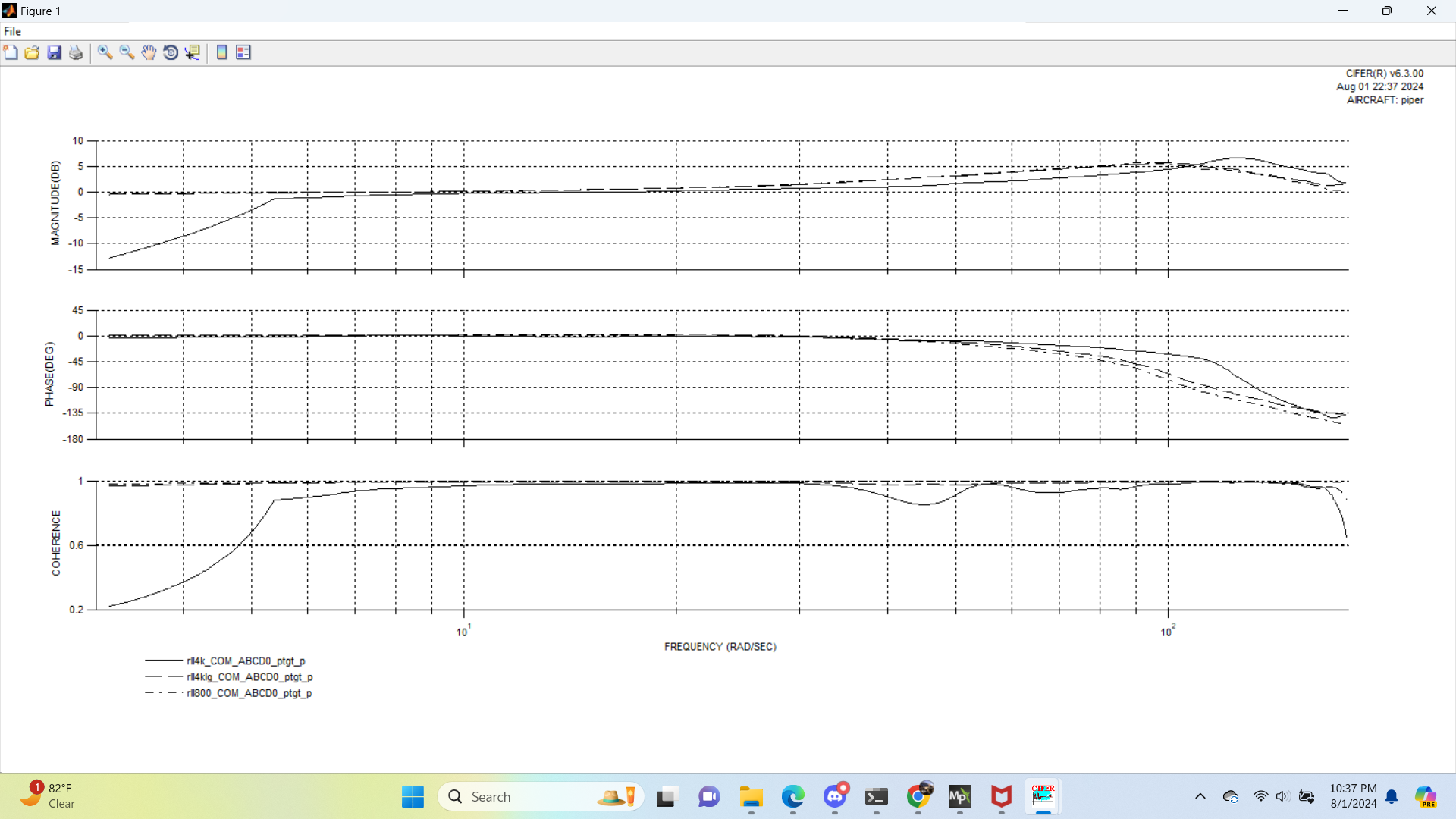

Here is a plot of the three for the target roll rate to actual roll rate.
4k loop rate with optimal gains - solid line
4k loop rate with 800hz loop rate gains - dashed line
800 hz loop rate - dash dot line
You will notice that the 4k hz loop rate gain trace matches the 800 hz loop rate. the benefit of the higher loop rate is shown in phase as there is less phase loss by the 4k hz loop rate. This demonstrates the reduction in time delay by 1.9 milliseconds. For smaller copters with high frequency dynamics, this shows a definite improvement. I don’t think this would be as big of a benefit for larger aircraft.
