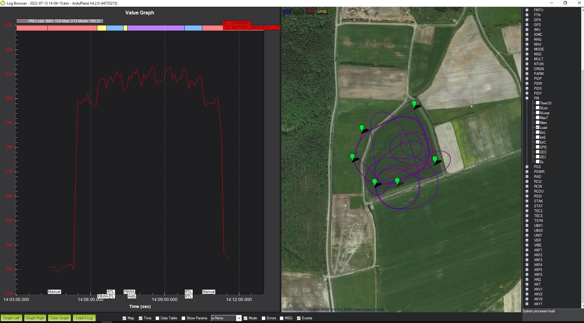

I also have a question regarding the units of measurement. In the screenshot, my aircraft’s flight is displayed with the Pixhawk 4 Holybro flight controller. I didn’t enable advanced features in the controller configuration, such as multiple cuts, FFT, fast loop speed, etc., or if you leave batch logging or other high-speed logging enabled.

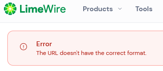

Please take the look at my file. https://drive.google.com/file/d/1FSolubgAjBbpixNlsSiY396m0OJX9bbZ/view?usp=sharing
Try if this one works

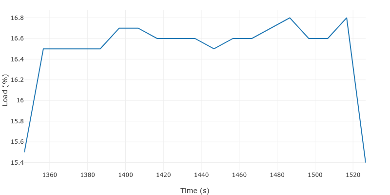

Looks like 16%. All good.
The scaling is percent * 1000. So both of you have logs that peak at ~20% CPU load or less.
You can use this tool as well:
