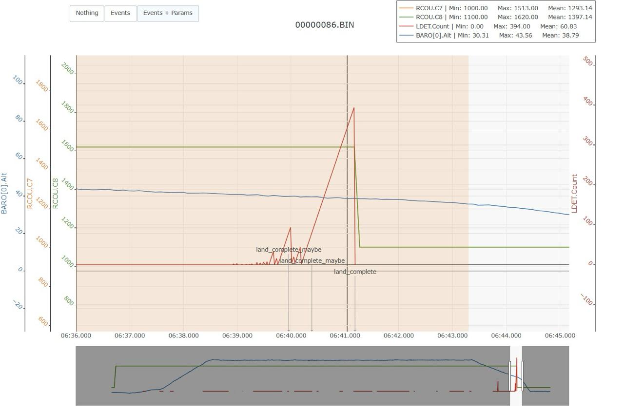

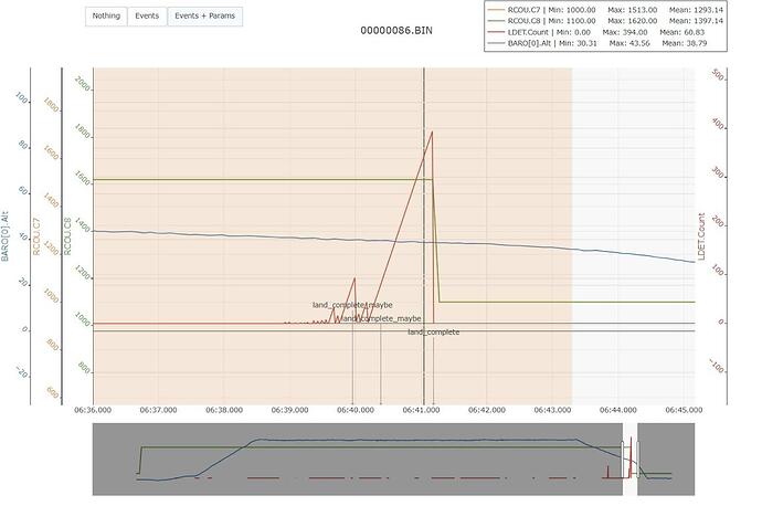

Hi , I’m experiencing an unintended landing detection during the RTL phase of an auto mission and would appreciate any insights from the community.
Flight Summary :
  • Mission type: Auto Mission with RTL as final waypoint
  • RTL initiated at: ~80m AGL
  • Descent rate: 1.3 m/s vertical speed
  • Unexpected landing detected at: ~35m AGL

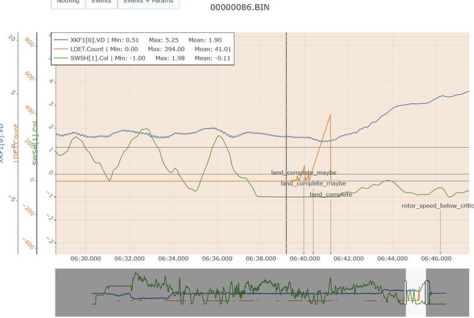

As per Log Observations: During RTL descent, the flight controller triggered a landing detection at 35m AGL. Reviewing the logs, I found that the collective pitch held at -1° blade angle continuously for 3–4 seconds prior to the detection event. It appears the land detector interpreted this sustained minimum collective as ground contact.
Should i put more than -2 or -0.7 in collective blade pitch angle minimum when landed or Is there a parameter to increase the minimum duration or add altitude gating to the landing detection logic during RTL?
Firmware version: 4.6.2
Frame: Heli

I looked over the log. During the descent, the collective is at the lower limit. That along with the slow descent rate (< 1m/s) caused the landing detector to meet the criteria to declare the aircraft landed. It is odd that you have a collective value of -1 deg that produced a descent rate of only 1 m/s. I agree with @LupusTheCanine that you should check your collective values to ensure they are accurate. Are you using asymmetric airfoil blades? Based on your hover collective setting, you are hovering with only 2.5 deg of collective. so you either have a very light heli or you are using a high rotor speed, or both.
Sorry again about the crash. please adjust your lower collective limit and the land collective min value to lower values so you don’t get into this situation again.

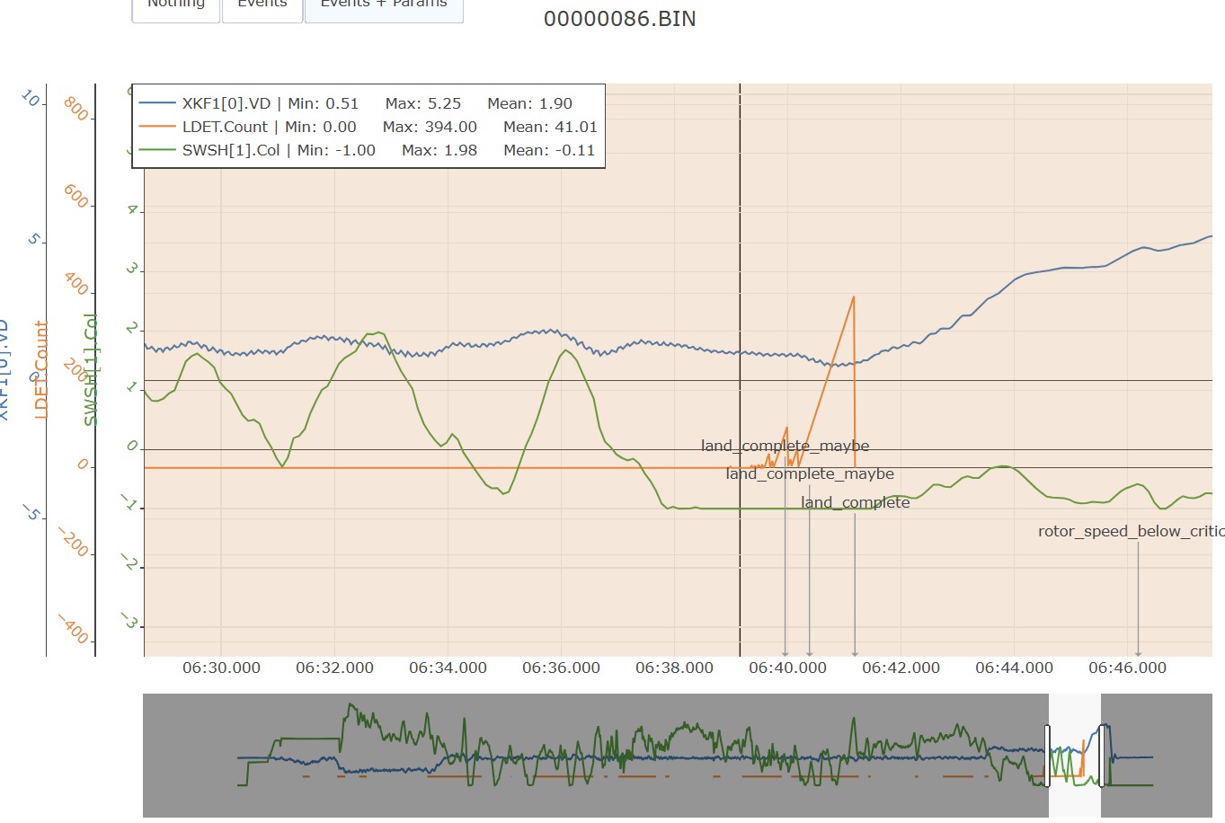

Unfortunately, despite these changes, the issue occurred again during today’s test flight. while testing i again faced the unintended landing detection during the RTL at 98m ALT and recovered the craft by again arming the craft in mid air at 8m from the Ground. the specification of the helicopter is as mentioned above in the same thread.
Unexpected landing detected at: ~98m AGL
As per Log Observations: During RTL descent, the flight controller triggered a landing detection at 98m AGL. Reviewing the logs, It appears land detector count was established after approximately 1 second while the vertical descent rate was around 0.7 m/s.. kindly review the log and give me a suggestion do not encouter this problem again.
Log file drive link - Flight log - Google Drive
collective angles are still not correctly set up. I strongly agree with @bnsgeyer suggestion on how to set those. I see also a major flight safety hazard in your procedure right after the FC disarmed: you switched to Loiter flight mode. In that situation (which should not happen once the setup is rectified) you should switch to Stabilize mode to regain manual control over the collective and cyclic.

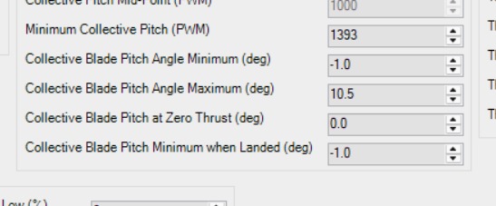

Hi @bnsgeyer and @lupusthecanine @Ferrosan As suggested in the previous replies, we thoroughly reviewed our swashplate setup and verified that it is configured correctly. We have attached the swash setup images below for your reference.
We have also attached the flight log from our latest test flight. From the log, it can be observed that the swash collective demand during the RTL descent never exceeds the configured landing collective limit of -0.8, indicating that the flight controller is not commanding additional negative collective beyond this threshold.
Based on our discussions and repeated flight testing, we suspect that the helicopter is entering turbulent or recirculating airflow during certain descent conditions. In these scenarios, even -1° of collective pitch does not generate sufficient descent, resulting in a low vertical descent rate.
From the logs, it appears that because the descent rate remains around the landing detection threshold for a short duration, the landing detector counter is satisfied, causing the flight controller to falsely declare a landing.
We have attached the relevant flight logs, swash setup screenshots, and other supporting information for your review. We would greatly appreciate your analysis and recommendations to help us resolve this issue.

When we configure the minimum swash collective to -2°, the helicopter experiences severe ground resonance during landing, making this setting unsuitable for our airframe. Based on extensive flight testing, we have found that a minimum collective range of -1.0° to -1.5° provides the best compromise between flight performance and landing stability, while avoiding ground resonance.
Because of this limitation, increasing the negative collective further is unfortunately not a practical solution for our helicopter ( 2.2 m blade wingspan)
We would appreciate any recommendations or guidance from the developers on how best to address this scenario.
