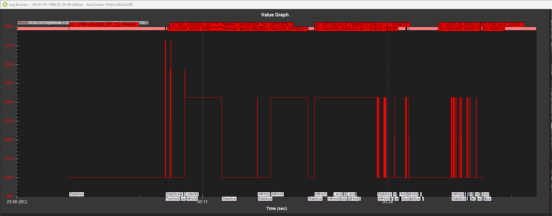

It looks like you lost your RC control but I see noise on your rc inputs. It doesn’t look like your rc connection is working correctly.

You can see there are a huge number of mode changes. And they are all being commanded by the RC.

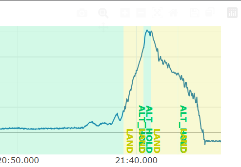

I have a separate AUX switch for Land mode on channel 12. Although it was in Land mode for a short time, the drone continued to climb in altitude and eventually crashed. To locate the crash site, I kept switching modes to trigger the buzzer sound and help me find it.
Also in the graph there is continuous data for all the channels. So it must be controllable manually but it didn’t : (
here image shows height claim in land mode:

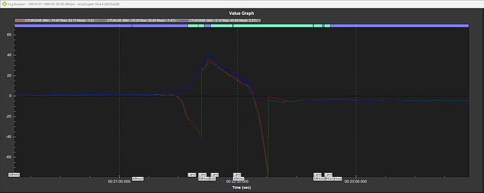

The EKF thought it was going down at that time:
Your configuration has messed up the EKF pretty seriously.
