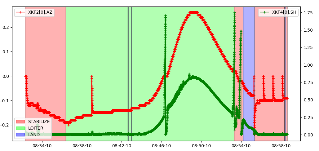

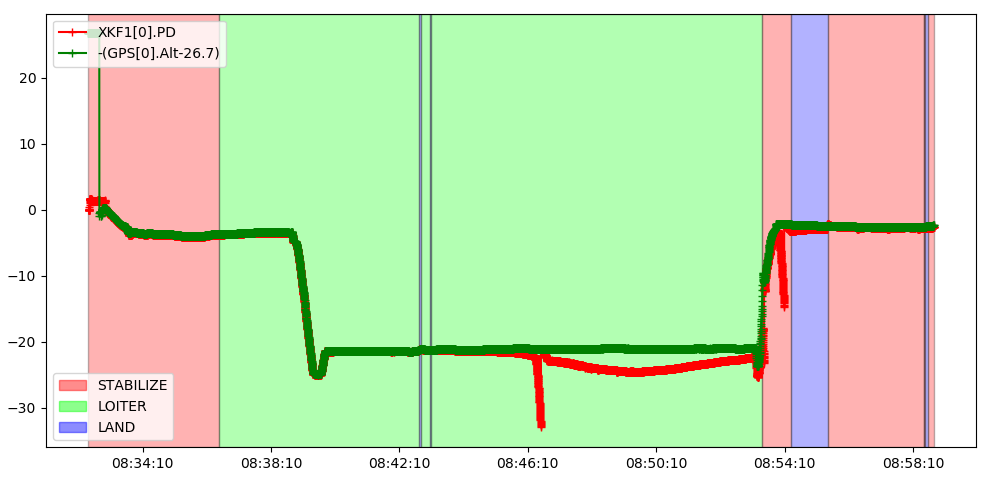

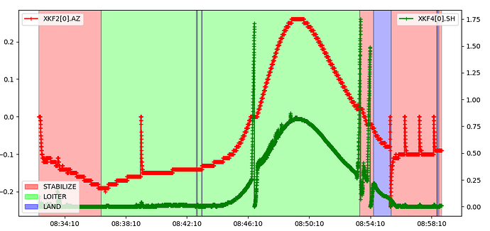

We observe that the altitude reported by the GPS is indeed correct, but the position estimated by the EKF still drifted:
The altitude variation appears to correlate with a drift in the estimation of the accelerometer biases, and also consequently with the vertical position innovation:

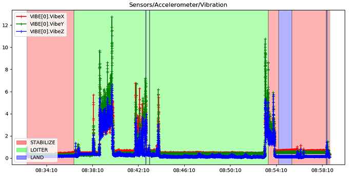

Since the drone was disarmed, vibrations were practically nonexistent:

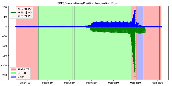

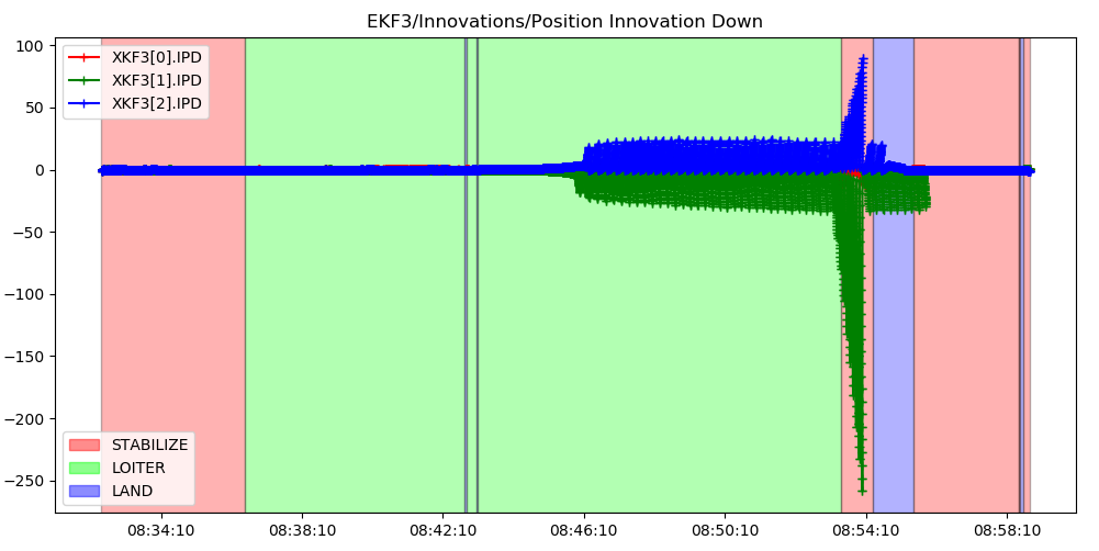

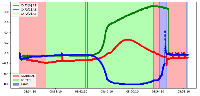

What is also concerning is that all three EKF/IMU cores experienced this drift, though not necessarily in the same direction:
With no vibration, I find it difficult to understand how the accelerometer biases could have diverged so much. Perhaps I’m on the wrong track and this drift in bias estimation is caused by something else?

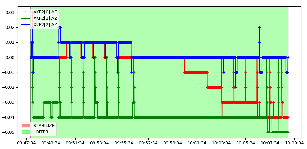

I did more test flights today, and unfortunately, we are currently unable to reproduce the issue we had. However, I still wonder if the problem is lurking around the corner. One thing I noticed during the recent tests is that the accelerometer biases are nearly zero:
whereas they were quite significant during the flight where the EKF drifted:
Dataflash log or recent flight without issue: Download
