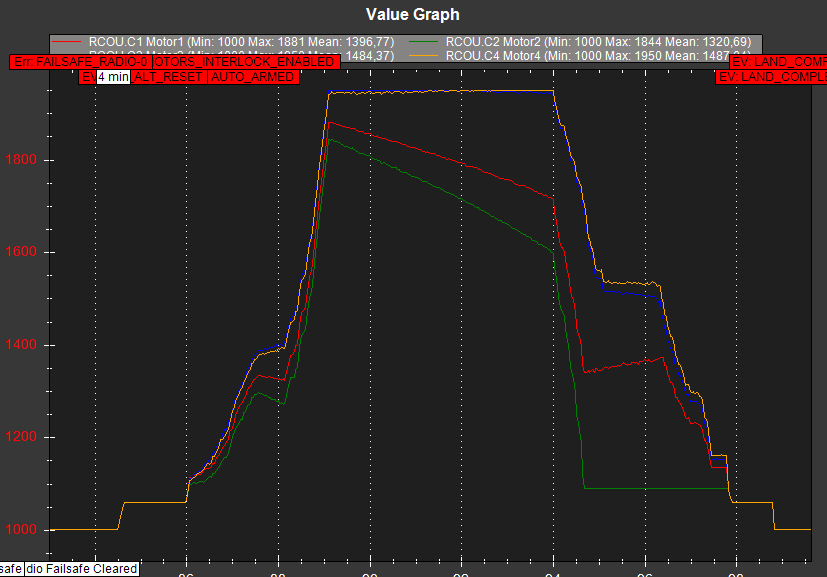

It’s a fresh 4.6 beta4 build almost ready for first hover.
What I observed is that the motors exhibit uneven power on take-off attempt.
The drone is on a flat, level surface without propellers.
What’s your opinion?

There is no expectation of even motors outputs in that situation. That topic has been beaten to death on the forum.
The situation being “no props”?
yes, the situation being open control loop: “no props” and/or “tied down”.
The methodic configurator documentation explicitly tells you to not do this. It adds NO benefit, nor valid information. If you had read it, you would have known.

In this case yes. Some have tied their craft down with props and produced the same expected results. Or flipped the props around to reverse thrust.
Sorry, it is the recommended method, I read it in the docs.
Do not remember what was the test point, but it’s was stated to push drone with props to the floor.
The only place I have seen that is to run Compass Motor Compensation. And that’s a needless and potentially dangerous method when we now have Magfit. Which will produce better results as it’s real conditions.
Sorry, it has no place in testing motors. That’s what Motor Test in Mission planner is for as it is not in the control loop looking for sensor feedback which is static.
Yep, it was Compass Motor Compensation.
Ok, so we are after first after 13 years hoover and the old grandpa acts exactly as it used to take-off.
First it take two right (1,4) engines of the ground then left two (2,3) gain more power.
So it’s not related to the picture above. (If numbers correspond)
It has to be a matter of engines … Anyway. Mission accomplished, it was in the air again!
(But needs new batteries)
