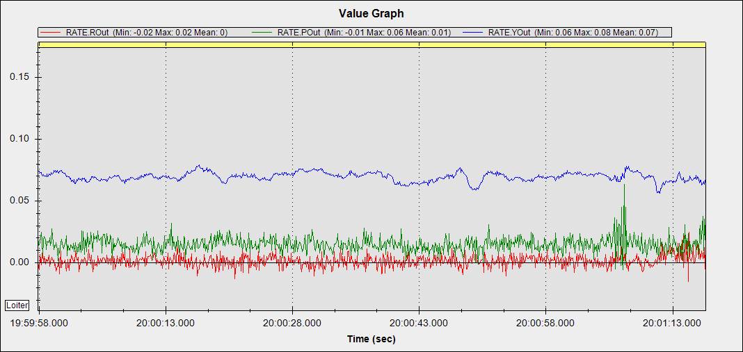

I don’t have the logfiles with me, but I checked motor RPM on MissionPlanner dashboard: there was no significant RPM difference between the 4 motors. I can provide logfiles later today, when I arrived home from work.
https://drive.google.com/file/d/1ITJq1gIH_tpIH4jD6y9J2wr7o110LIii/view?usp=sharing, https://drive.google.com/file/d/1QqrJgC_aE_TA_jJcwOnb-YakTP4yVMfs/view?usp=sharing, https://drive.google.com/file/d/1bQY1k5jUHQ2DRHcmKOcAIRzsptjz_UJE/view?usp=sharing

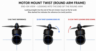

Regarding mount twist illustration: Do I understand correctly, that the best would be 1, but #2 is also acceptable?
From @dkemxr ‘s image, only number one is correct. 2 & 3 will both result in a torque split.
Make sure when you’re aligning the motors you check both X and Y axis. For example compare motor 1 against motor 3 and motor 4. In a perfect world you would compare all four motors, but most of the time that’s not practical. And if you have motor one level with 3 and 4, and motor 2 level with 3 and 4, then it should be fine.
Yea, what @Allister said. I see from your photos there is a good flat area on the prop hub to use, so that should work. If it’s not repeatable with the arm folding/unfolding then it’s just the issue always seen with those mechanisms. The joke is it can easily be remedied with JB Weld…
Alternatively if the arms have to be foldable, motors can be deliberately twisted so positive correlation between drag and thrust torque is always maintained.
Provided the motors are assigned correctly you can avoid confusion by looking at the pre motor mixer roll pitch and yaw outputs in the RATE message.
If the CG was perfectly in the middle we would expect roll and pitch to average 0 and if is no yaw imbalance the yaw output would also average 0.
In this case the yaw output is by far the largest. A positive number means the copter was trying to yaw clockwise, so its CCW motors would be at a higher throttle level. Pitch is positive nose up and roll is positive roll right. So we can also say that the CG is a little forward of ideal as there is a constant nose up pitch output.
In general you want roll/pitch/yaw outputs to be of around the same amplitude, if one is dominating its worth either aligning the motors or shifting the CG.
