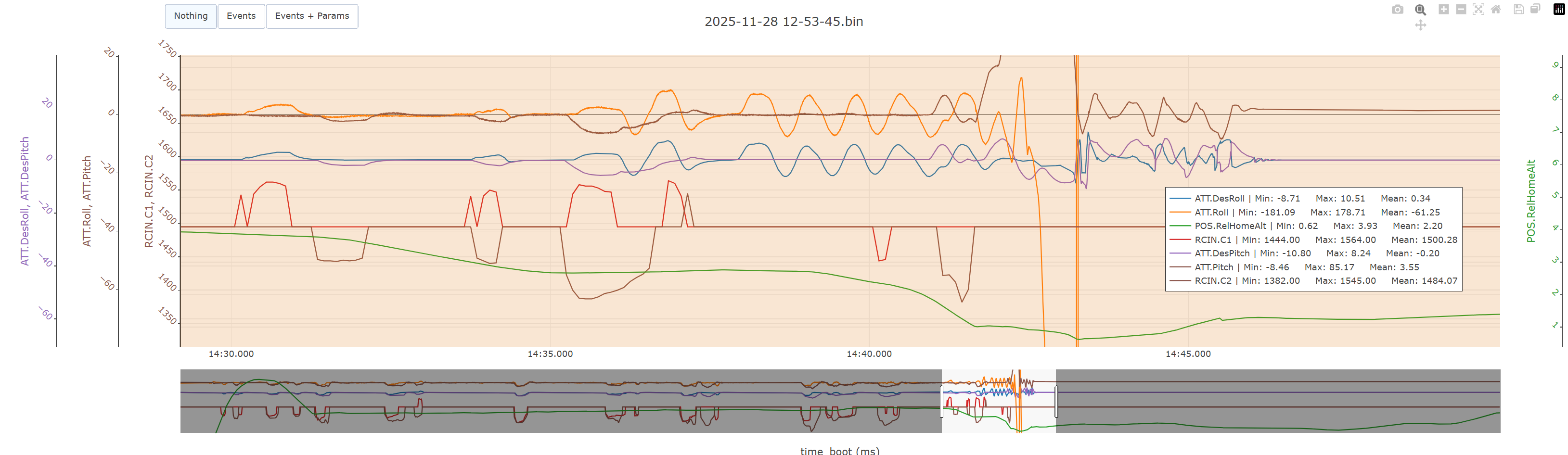

Hello all, I have tuned the Rate PID values of Roll and Pitch of my quadcopter (“CUBE Orange+” FC) and it flew well in all modes. After few days suddenly it started twitching (undesired Roll and Pitch movements) in Alt_hold and Loiter modes. The Loiter mode has control over horizontal movement, but the Alt_hold mode doesn’t. Even then, recently my drone oscillated in Roll axis without any Pilot input when in Alt_hold mode. The Des.Roll plot showed Left and Right Roll values when the RCIN1 is flat at 1500. It also took a small backward Pitch input and gave momentum to the drone by the time it touched ground. This caused the drone to flip back upside down and crash.
Need some guidance on what might have caused such undesired roll and pitch movements by FC.

There seems to be a very slow change in the drone. I can’t put my finger on what’s going on. How are the propellers mounted? Any chance one could come loose?

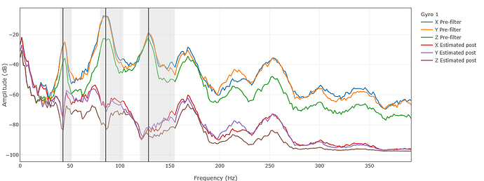

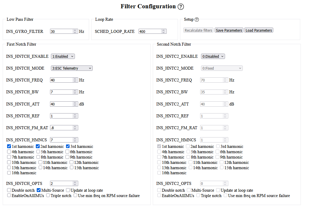

I think you have too much filtering. Try this:
Also set:
ATC_THR_MIX_MAN,0.5
ARMING_CHECK,1
Might help to run MAGFIT on both compasses but there’s not enough data in this log for a good calculation.

  3. Our motors occasionally spin slower when weight is less, if i increase the HNTCH_FREQ to 40 Hz, it will prevent the notch from filtering the propeller noise under that. Hence, i considered 30Hz.

This is very rarely a parameter or software issue if the drone has been flying in a steady state in a mode such as AltHold with no significant inputs. In the short time I looked I didn’t see any smoking gun, but I’d still try to rule out everything mechanical.

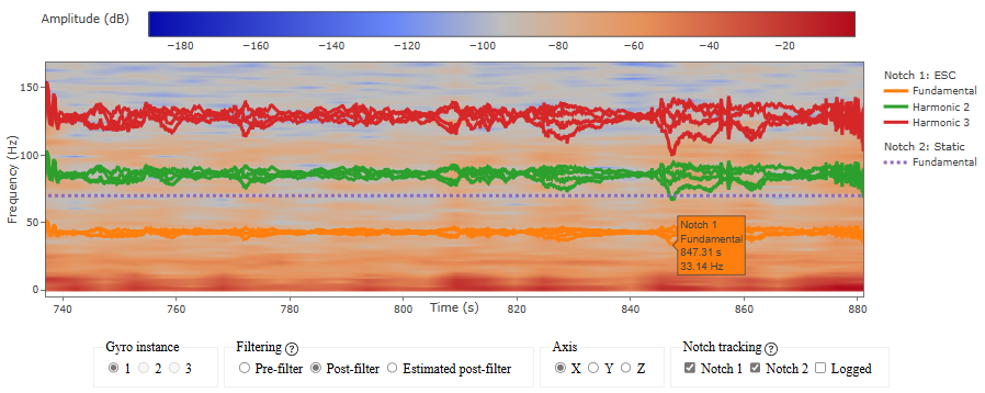

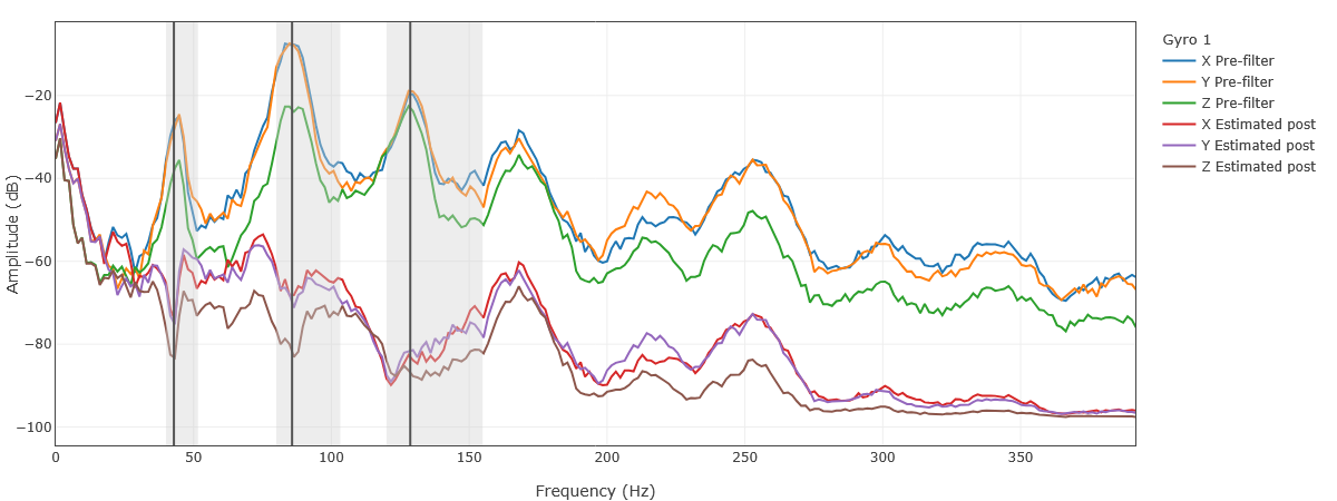

Not correct. You are using ESC telemetry, and that will move the filter as required. Also by setting INS_HNTCH_FM_RAT to something below 1 it will go below the specific notch frequency. Most times 0.7 or 0.8 are the right place. You can see in the graph I posted that the black lines indicate where the center point of the filter is targeting and the grey bands show the range the filter is working in. The goal is to have peaks below -50db, and with the settings I suggested that is possible.
