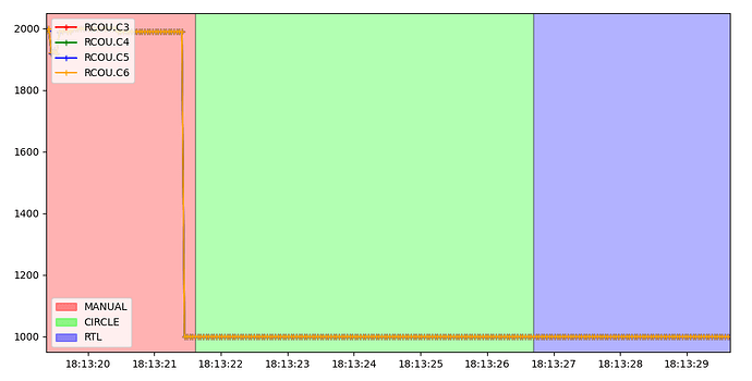

However, this time, because it was armed I have a log file that I’d appreciate some help/advice in analysing. These are the relevant start, max and last throttle inputs I can find:
1970-01-01 02:13:16.61: AETR {TimeUS : 4396615479, Ail : 115.0, Elev : 196.0, Thr : 1.0, Rudd : 0.0, Flap : 0.0, Steer : 0.0, SS : 1.6699999570846558}
1970-01-01 02:13:17.21: AETR {TimeUS : 4397215427, Ail : 115.0, Elev : 196.0, Thr : 5.0, Rudd : 0.0, Flap : 0.0, Steer : 0.0, SS : 1.6699999570846558}
1970-01-01 02:13:17.33: AETR {TimeUS : 4397335428, Ail : 115.0, Elev : 196.0, Thr : 0.0, Rudd : 11.0, Flap : 0.0, Steer : 11.0, SS : 1.6699999570846558}
1970-01-01 02:13:19.33: AETR {TimeUS : 4399335220, Ail : 115.0, Elev : 196.0, Thr : 3.0, Rudd : 244.0, Flap : 0.0, Steer : 244.0, SS : 1.6699999570846558}
1970-01-01 02:13:19.37: AETR {TimeUS : 4399375140, Ail : 115.0, Elev : 196.0, Thr : 100.0, Rudd : 1534.0, Flap : 0.0, Steer : 1534.0, SS : 1.6699999570846558}
1970-01-01 02:13:21.45: AETR {TimeUS : 4401454960, Ail : 0.0, Elev : 0.0, Thr : 0.0, Rudd : 0.0, Flap : 0.0, Steer : 0.0, SS : 0.6741989254951477}
But I can’t find anything obvious why it went from Thr : 3.0 to Thr : 100.0 in .04 of a second!

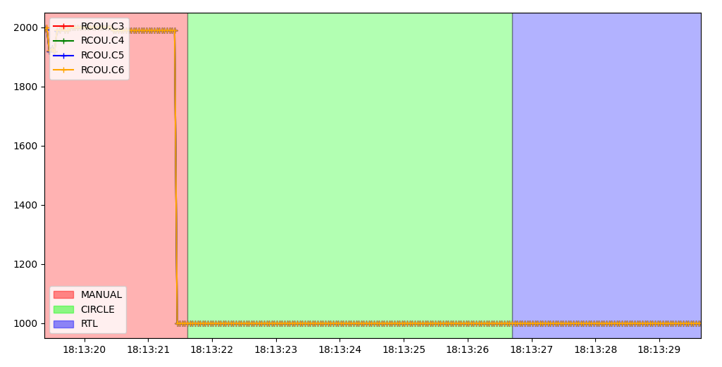

The plane was armed in manual mode, with full throttle. Things will happen…
Then had an RC failsafe, so it started switching modes based on the configuration for RC failsafe. Circle mode then RTL.
The four motors were all went from full signal to min when the fail safe occurred.

However, both batteries had BATT/2_FS.. set to None, THR_FS_VALUE was left at the default 950 with my TX min throttle at 990us and the RX was responding correctly. So I’m not sure I understand why a 100% throttle would be commanded when I set throttle to ~3%.
It’s also worth pointing out the motors didn’t go to min, I had to disconnect the flight pack from the ESC to stop them.

The challenge is, from listening to your comments, it is something to do with a failsafe, after it was already armed. The batteries and RC were in good working order when the vehicle was armed, so I’m not sure I see it would make any difference.
My suspicion is that my enabling BATT2 also enabled a failsafe I wasn’t aware of, and that I spent so long with it on the bench, that either that BATT2 FS or me changing TX/RX packet rates for the Yaapu telemetry caused a radio FS, and the mode change that you pointed out. With telemetry not working correctly I never saw the alert and wouldn’t have realised the significance anyway.
