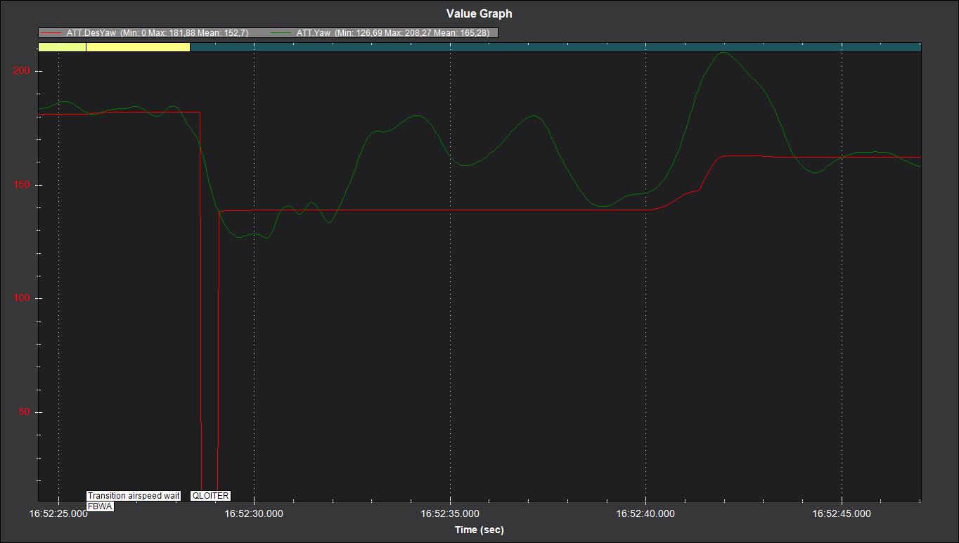

However, at some point when I engaged today FBWA mode and after less than 3 seconds back to QLoiter, the VTOL almost crashed, veering to the left and descending sharply. I checked that the desired Yaw was changed by 180 degrees, and the real yaw followed quickly to that direction, which looked like very sharp turn to the left and strong roll to the left.
y1
y11364×772 53.2 KB

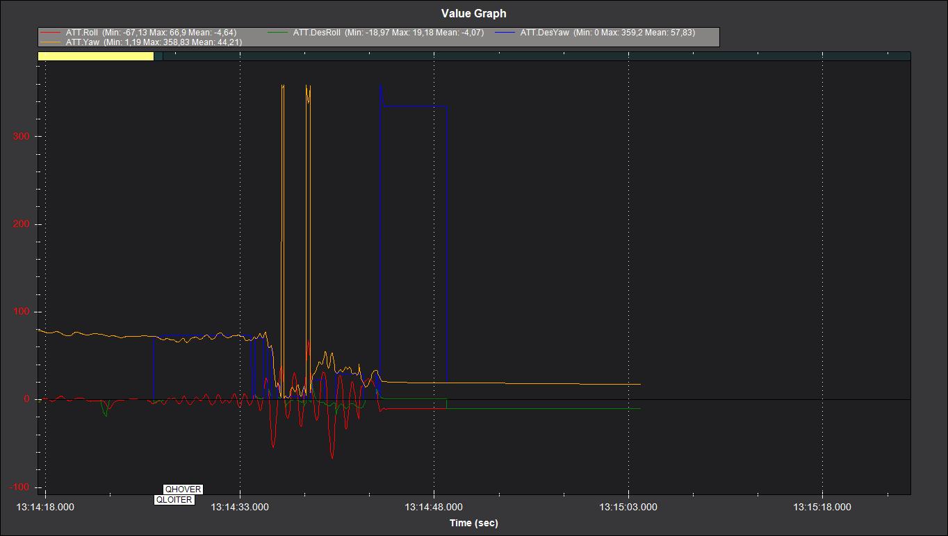

Two days before I was flying with 4S and different PIDs, but basically the VTOL semicrashed, descending rapidly with oscillations after the transition from FBWA to QLoiter. Again, the desired yaw changed abruptly, this time by 90 degrees. Also, when I was transitioning from Qhover to FBWA, during the transition the plane was very unstable in yaw, with a tendency to turn left. However, when hovering, it was very stable.
y2
y21364×772 60.2 KB
