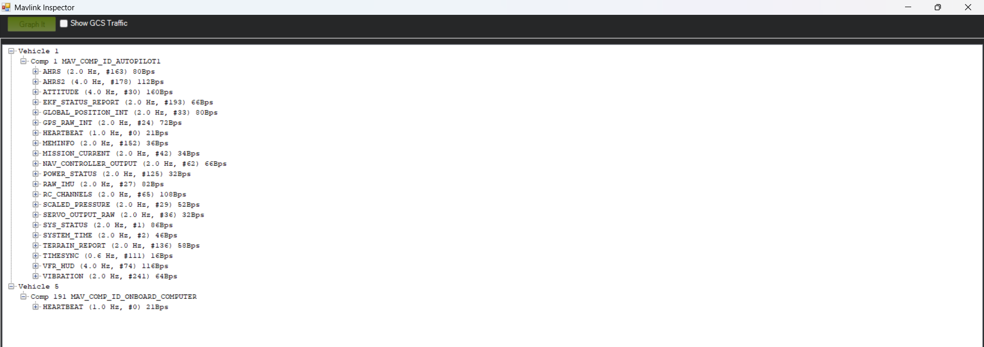

i can monitor heartbeat properly in the mavlink inspector in mission planner but there i cant see any initialization or any message highres_imu being sent . For reference i have attached a snapshot of mavlink inspector
i tried using an external led on stm32 to trigger when the after function call and it glows as expected after the function call but the highres_imu can never be seen on the mavlink inspector
i even tried with the existing message that is already being set by FC i.e. RAW_IMU to just change the interval to 100000 microseconds and not completely ask new message id but it had same issue the rate in the mavlink inspector never increased to 10hz

uint16_t maxvalue = 65.535 < 100.000
