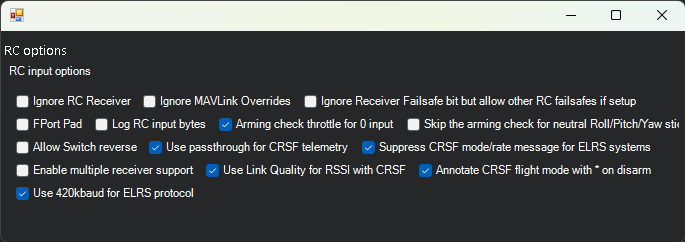

Hi, I am currently trying to connect my ELRS receiver to my H743 FC, I have connected the pins based on the Matek page and the documentation, receiver’s RX to TX6 and TX to RX6 (even flipped to test).
Set
BRD_ALT_CONFIG = 1
SERIAL7PROTOCOL = 23
RSSI_TYPE = 3
and still unable to make it work (the bar doesn’t move on radio calibration),
I have tried using this receiver with my transmitter on speedybee wing mini on INAV and it works fine.
TX: Radiomaster Pocket
RX: Happymodel EP1 ELRS
Thank you for any comment.
Do You have RC_OPTIONS set?
Also… Mateksys H743-Wing/SLIM/MINI/WLITE — Copter documentation
SERIAL7 = USER = UART6 (TX only unless BRD_ALT_CONFIG = 1, then RX available also)
Hi i manage to get it working with the rc option setting. Thank you very much!
