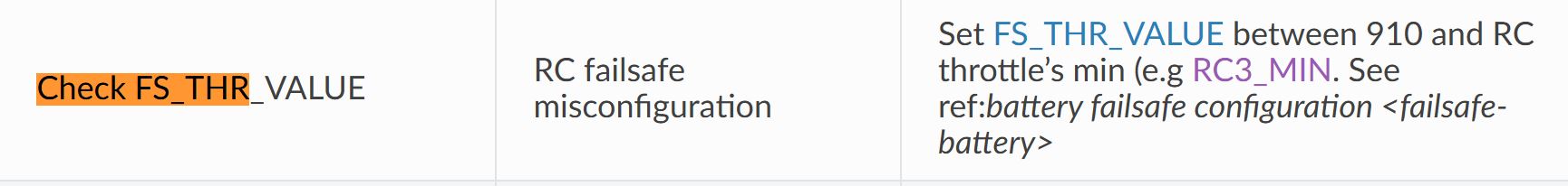

What did you have for FS_THR_VALE before you updated? Surely you saved the parameters file before updating. For future reference Pre-arm check messages and their definations can be found here Pre arm safety checks
The default value that you have should work based on your log but I have had to lower it a bit in some cases.
