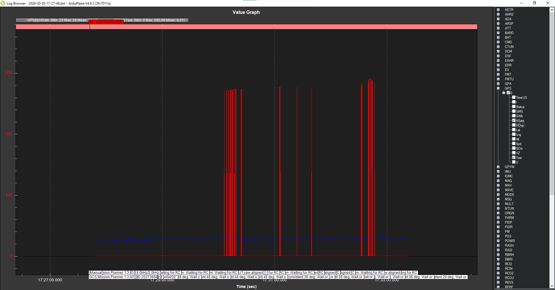

When looking at the Mavlink data, the GPS_YAW value stays at 655,35 whereas all the other ones are valid. I am not sure what I have done wrong. The GPS_Type is set correctly to 25 (Moving Baseline Unicore) and the antenna distances are also setup correctly for now. Auto config of the gps is also enabled, nonetheless I have set the UNIHEADINGA and AGRICA in Uprecise to output also at 5 Hz.
Is there a way to debug where the issue is coming from? The logs I get from downloading don’t really show anything. I had a look at the source code but could not find any obvious mistakes on my side.

This is the log, red is GPS Yaw. There is sometimes data but most of the time the value stays at 0.
