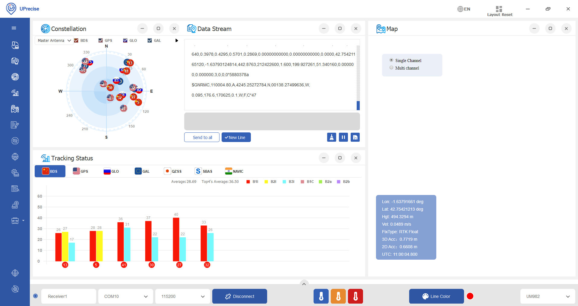

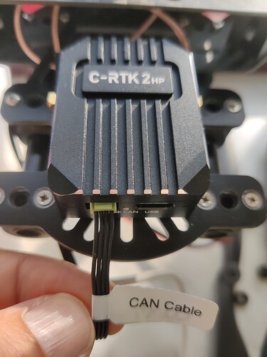

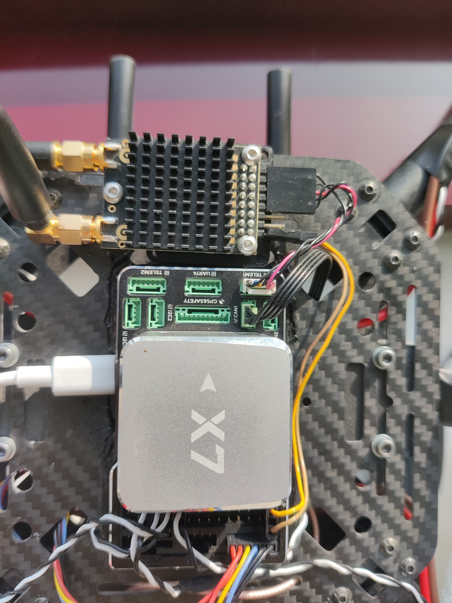

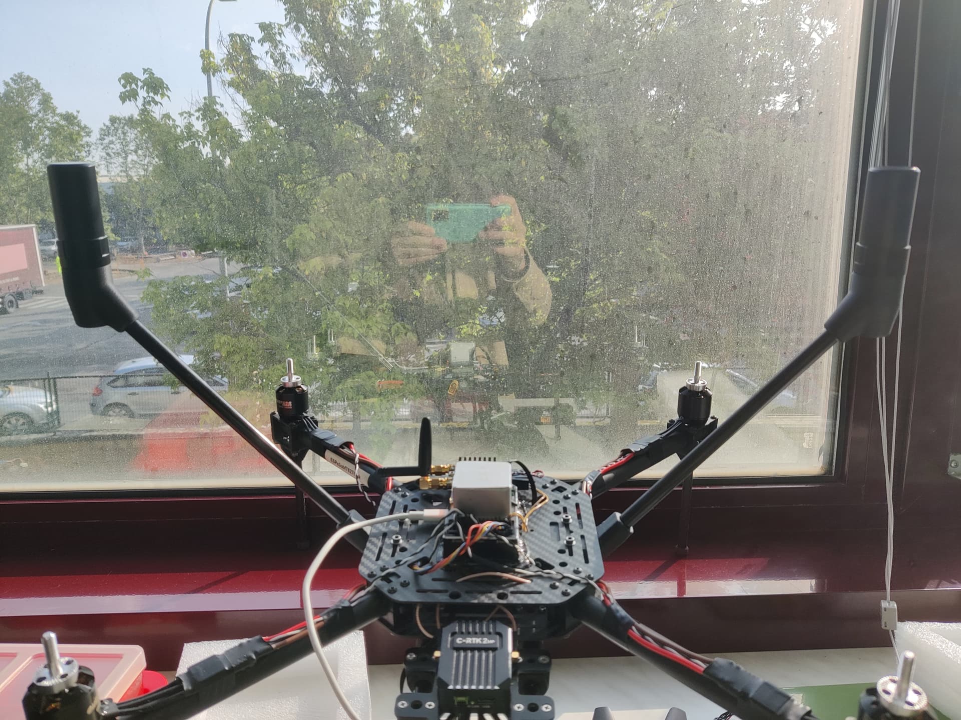

Been trying to achieve GPS yawwith an UM982 from CUAV (cuav 2HP). GPS position was easy to achieve, RTK fix with no issues, but when it comes to obtain the direction I am not able to do it.
Of course (tryed to) followed the guide to install and configure the receiver.
When connecting the GPS through USB to UPrecise windows app, the settings apear OK, and phisically switching the antennas still shows RTK fix.
In the photos you can see the overview of the drone setupp, and also a screenshot of UPrecise app, showing Heading (UNIHEADINGA).
Here you can have a look at a log where i walked on our parking lot, trying to mantain heading straight to the moving trayectory. Yaw stays very consistent (may be due to the giros doing their work properly) BUT with a big offset around -95º.
Im absolutely stuck, been banging my head for weeks, please hlp.

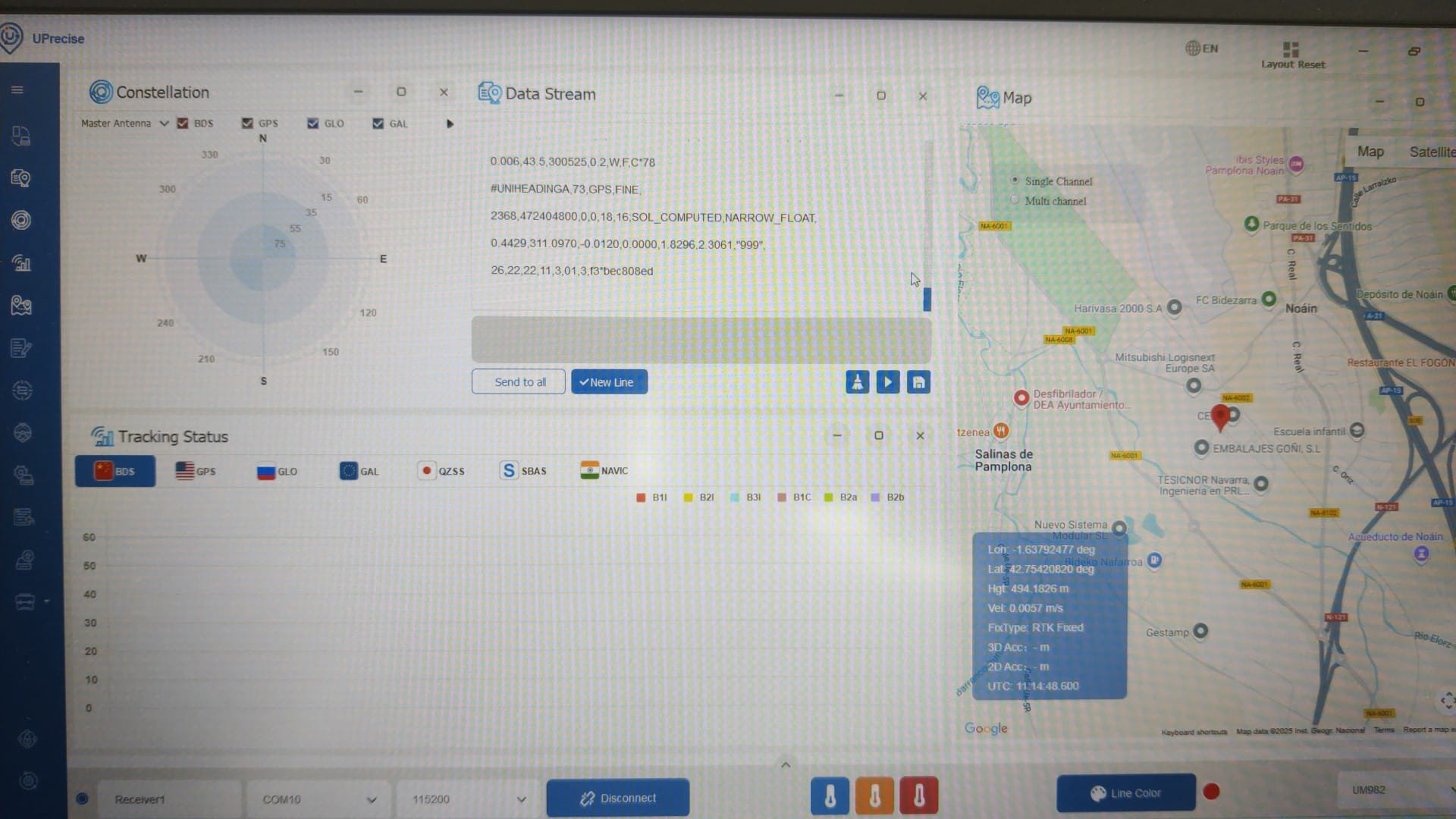

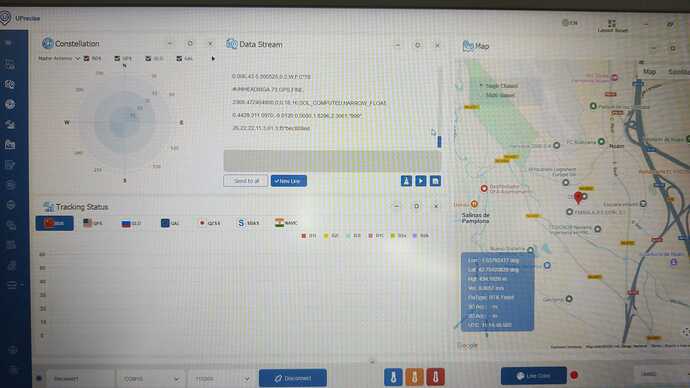

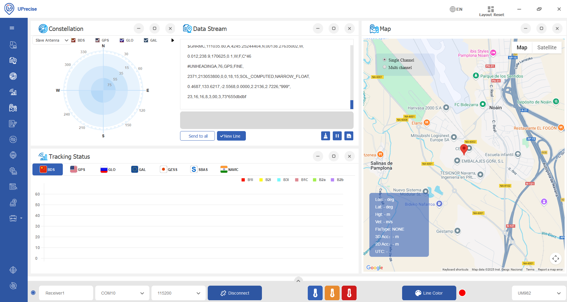

OK, after updating the GPS receiver it seems that its a defective unit. Now it shows in UPrecise app more data, and the Slave antenna seems unresponsive. Swapped the antennas and still no data from the Slave antenna.
I still want to confirm if anybody has this unit and can confirm that the slave antenna not showing data is not a fault, if that’s correct behaviour.
To display data from the [Slave Antenna] in the UM982 software, specific commands must be entered—please refer to the command manual for details.
The [GPS FOR YAW] function should be tested outdoors in an open area, as it is unlikely to work properly near a window.
Thanks for your response!
I am not interested at all in obtaining slave data in the UPrecise app, was just throubleshooting trying to find causes of my main problem; drone not obtaining GPS_yaw data, but thanks for the tip about the commands.
BTW, the GPS has been properly tested outdoors as can be seen in the logs.
