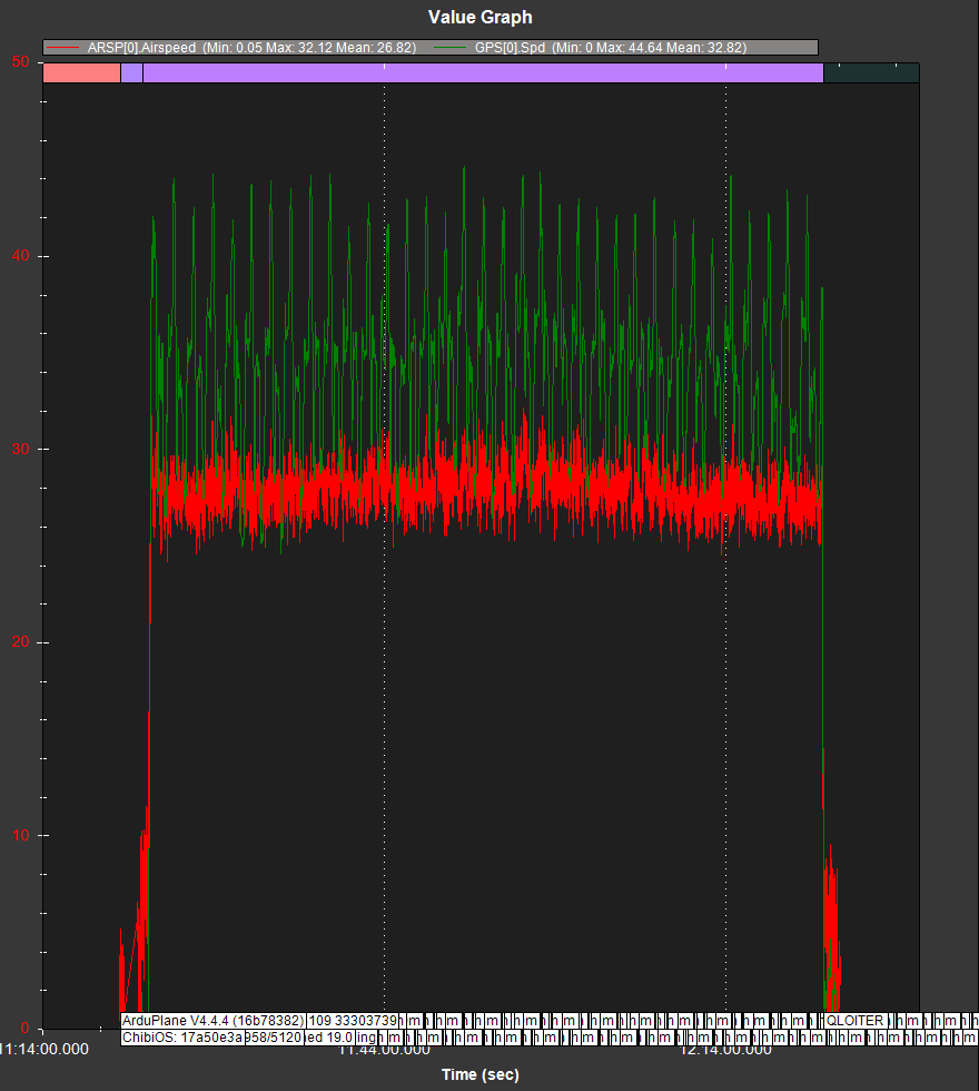

I’m having two issues related to airspeed.
First, even in low-wind conditions, there’s always a 10 m/s difference between GPS speed and airspeed. GPS speed is consistently higher. We’re using a CUAV airspeed sensor with a Pitot tube. Is it normal to have such a large difference?
Second, I get the error message [Airspeed sensor failure disabling] on every flight. Could this be a software issue? Or is it more likely a problem with the sensor itself?

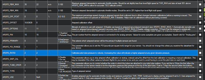

First, regarding question (a):
Yes, we did the Pitot calibration through Preflight Calibration.
The photo below shows the ARSPD_RATIO value you asked about.
As for question (b):
We didn’t cover the Pitot tube when connecting the battery. Also, during the Pitot calibration, we didn’t use a cover either—we just wrapped the Pitot tube with our hand while calibrating.
I might not know enough about this area… would you be able to help me out a bit more?
You have not calibrated anything because Pitot calibration is done in flight.
And the value you indicate for ARSPD_RATIO,2 is the default value due to the lack of calibration.
