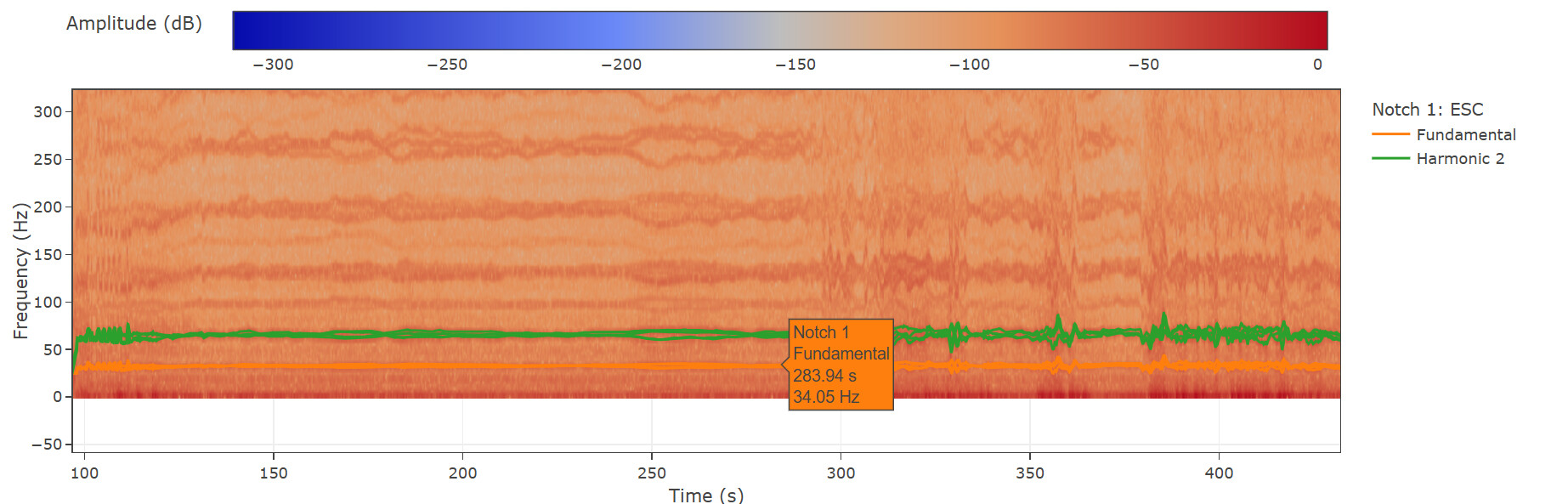

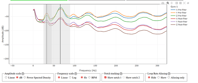

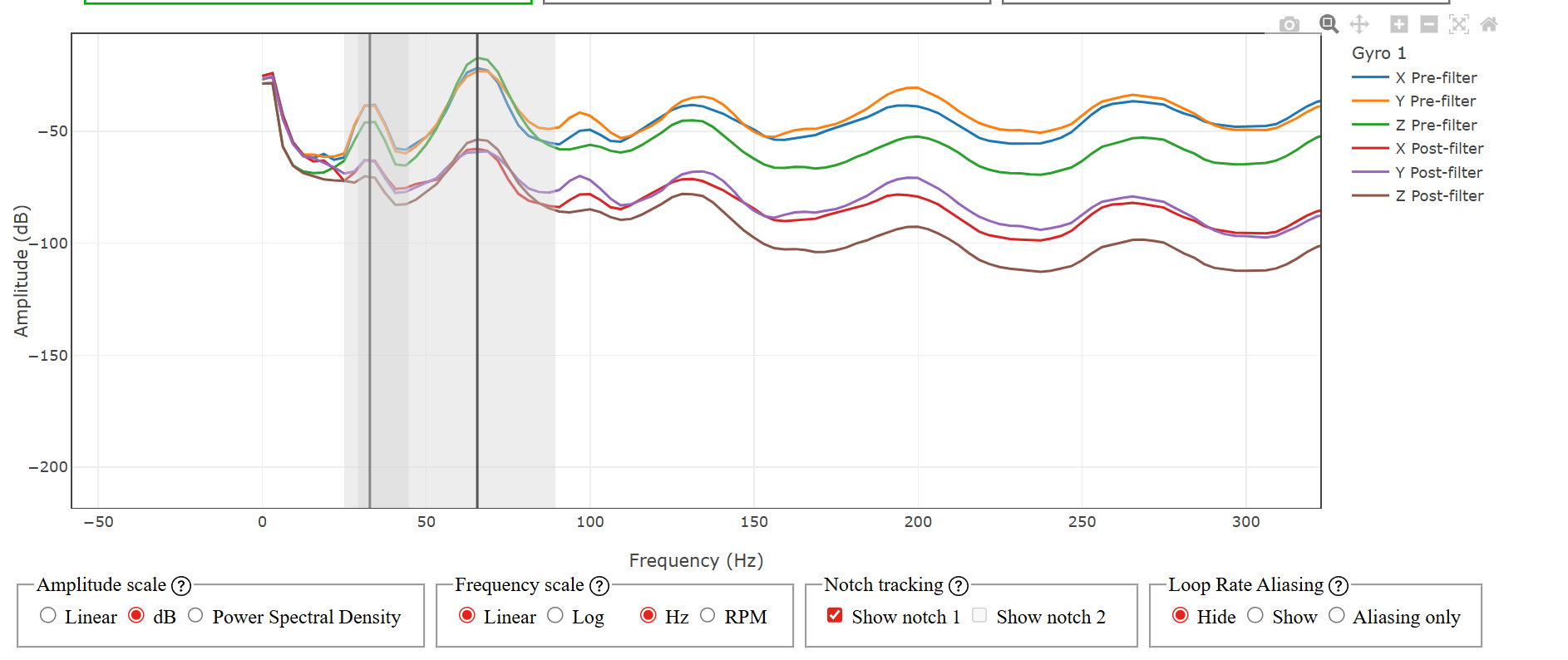

Tuning the notch filter of my 36" drone
Yay?, i think it work. Thank you so much
Click the ‘show notch 1’ checkbox.

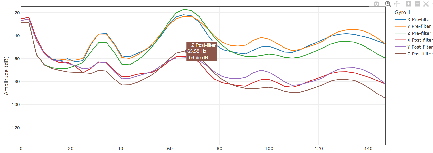

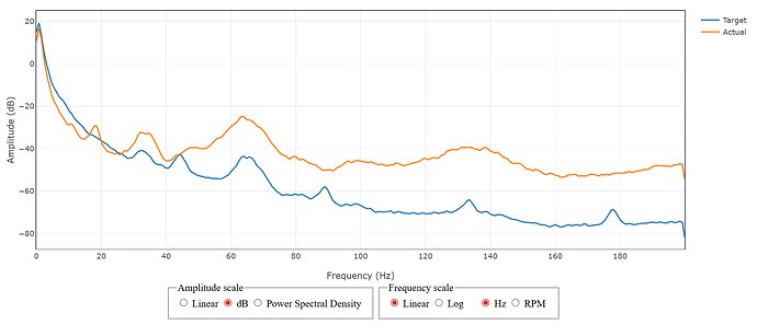

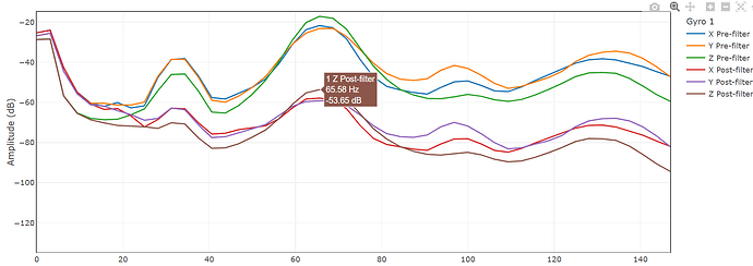

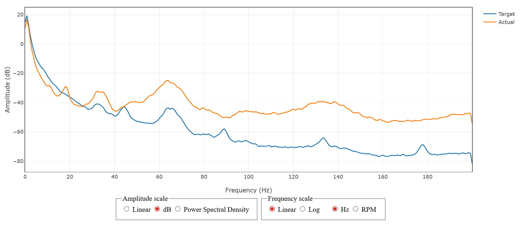

I try doing the frame resonance tuning before going to quicktune, Here is the only roll test :https://drive.google.com/file/d/1Q6hd89JF4TseBE9JUBhxX6CcGeBEwBZ9/view?usp=sharing
Is this mean my frame resonace is 14 Hz at the first peak right? because 34 and 68 is motor and already being notch filter.
To be sure you it is frame resonance and to filter just enough of it without introducing too much phase lag you need to use PID review tool and follow AMC instructions
