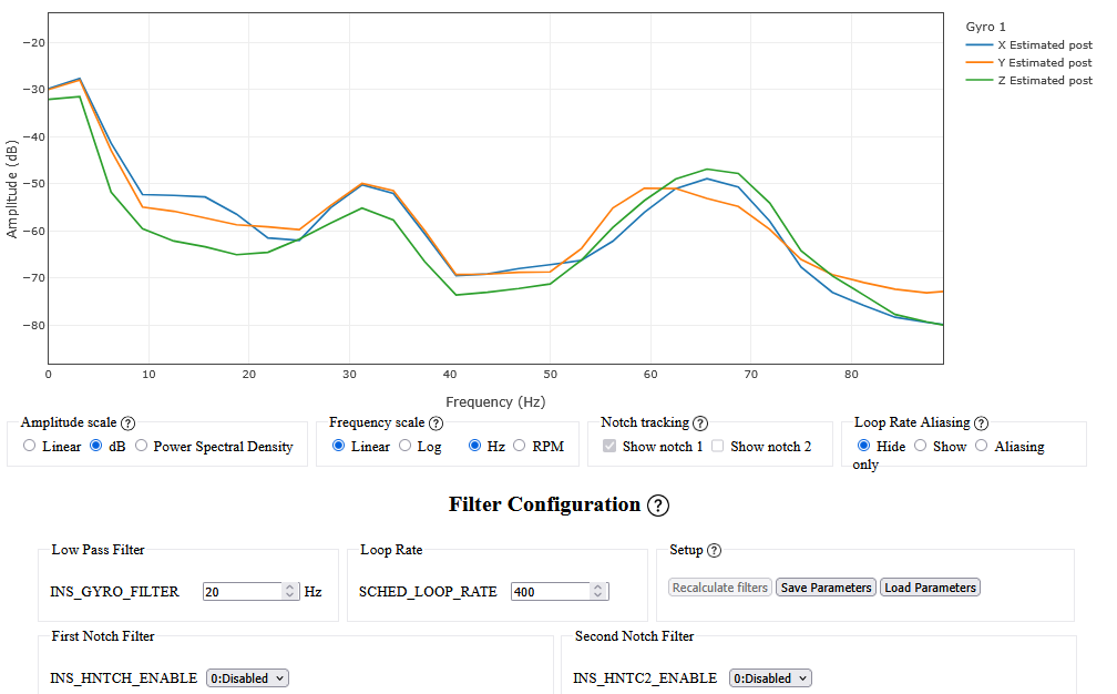

Tuning the notch filter of my 36" drone

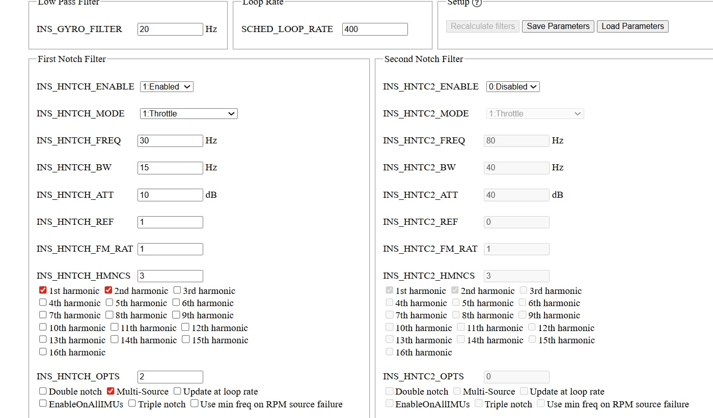

That FFT notch isn’t working for you. Configure a Throttle Notch. The 1st peak ~20Hz may be too low to address with a dynamic throttle notch so set the center frequency on the ~30Hz notch with 2 harmonics. And set the Raw Log bitmask to 9 so you don’t have ridiculously large files, like you do now, that do you no good.

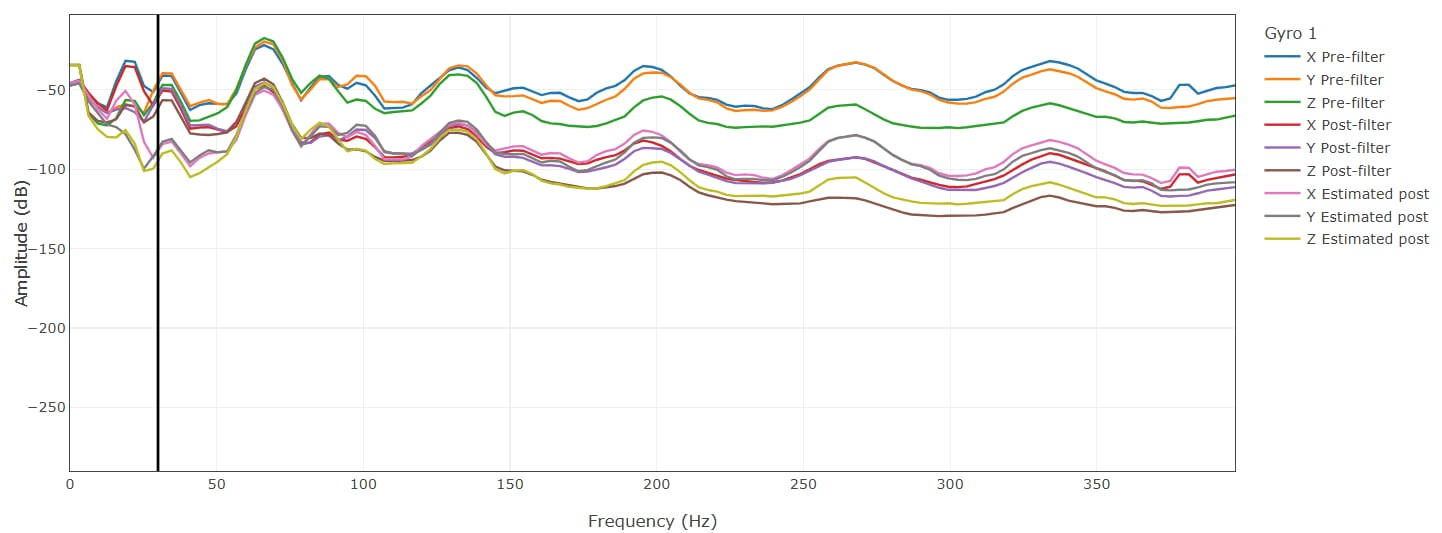

And it’s pointless to show an FFT graph to 1600Hz. Window it to 400Hz so you can see what’s significant.
sorry, i sincerely have no idea what i am doing. I don’t have the esc telemetry data yet,but i have order the hobbywing datalink v2 to look at the current comsumption.

So what i want is to make the low frequency lower and the high frequency higher right?
No, that is not it either.
Stop doing flights until you have the datalink.
In the mean time watch videos about notch filters and read the documentation
Hi, my datalink had arrived. But it seem the esc notch filter isn’t using the esc rpm to track.
Did i forget to configure something?
i have upload my amc,my last flight log,and the filter review result: https://drive.google.com/file/d/12H1vMK2Fp8DiO9QOuWrifBqFd1UtQB2r/view?usp=sharing
Thank you
Datalink is working but you need ESC_HW_POLES, 28
Set filters like this, your current setup is dangerous.
Thank you for helping. I use hobbywing x9 plus motor that have 40 pole, shouldn’t i set the parameter to 40?
And the notch parameter is basically i need to make it more narrow and attenuate less because it already have low amplitude?
I’m not sure but I think not, hobbywing have historically some strange things with RPM reporting, if with current settings you select 2nd and 4th harmonic it attenuates reasonably well. Usually drone this size just don’t use additional RPM notches and have just LPF 20hz or lower. It’s important that it’s not very lightweight, so RPM is not low, than LPF is enough.

Ok, I see now. WIth AMC you need to carefully read and understand what’s written in all docs it’s referred. Besides wrong poles count your error was to keep high attenuation / bandwidth but enabling Multi-source, it gives too much delay - 460 degree at 22 hz which gives at least 60 ms delay only in filtering.
Additional RPM filtering might be helpful but just LPF gives enough attenuation for now - near -50db expected.

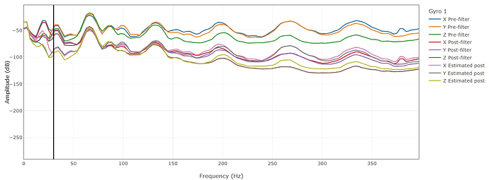

Here is my last flight, https://drive.google.com/file/d/1IqAopbJO1-Hfm-d8IDgKac81NTxYvY0c/view?usp=sharing
it seem that only LPF is not enough? when i fly i hear a high pitch sound, could this be the cause?
That’s correct just LPF is not enough, but with ESC_HW_POLES, 28 RPM is also incorrect. I believe it should be set at 20 (half of motor poles). Than try filter like that, 1st harmonic is optional:
oh i think i might understand a little better, so right now the esc send the wrong rpm because from the prefilter it seem to be that the 1 harmonic is 34 Hz, but the esc track at less than 25 Hz(because INS_HNTCH_FREQ = 25 the notch is stuck at 25Hz). So that would mean that the esc understate the rpm right?(but why we decreasing the pole? shouldnt we be increasing it?) I will measure the rpm using tachometer tomorrow.
So, 40 counts for one revolution vs 20 counts, if you really have 20 counts but your esc thinks you have 40, you will spin twice for every one “revolution” that the esc reports. Hence an under reporting. Adjust the esc counts down.
