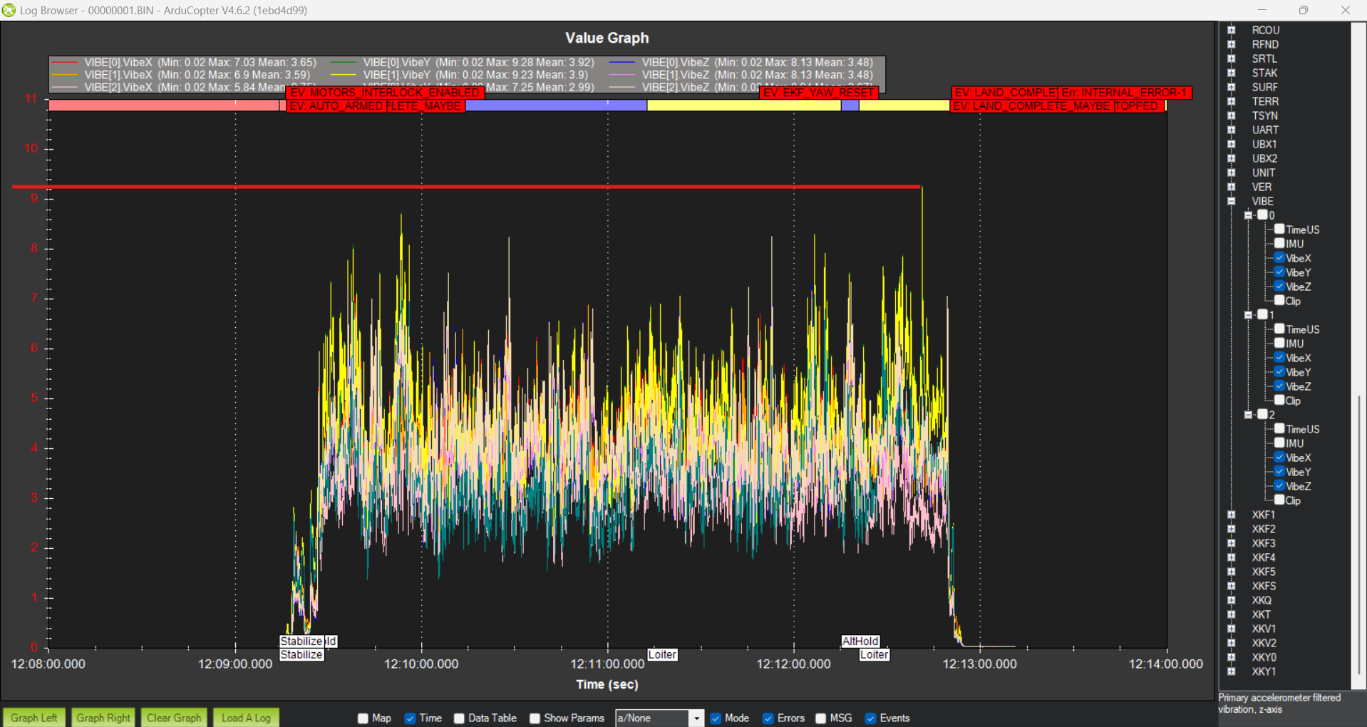

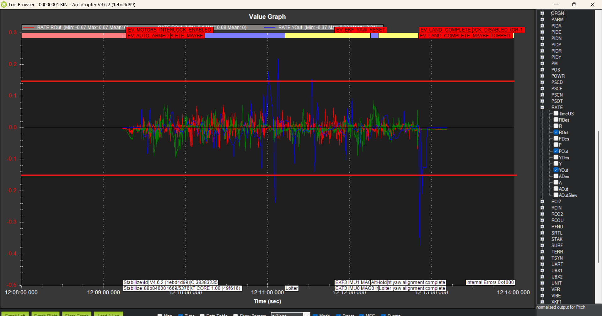

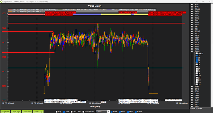

Hi, i am doing the section “7.1 First flight: Motor Thrust Hover and Harmonic Notch data collection“ i think my yaw output have oscillation issues, and after looking at RCOU.C1-C4 it oscillation more than recommended in the doc, can i proceed with 8? ,Can you please help verify?
It could be better. But it’s not that bad. What are the vibe levels?
all the VIBE from the gyros are below 10
but after landing the motor is feeling warm not hot, is that normal?

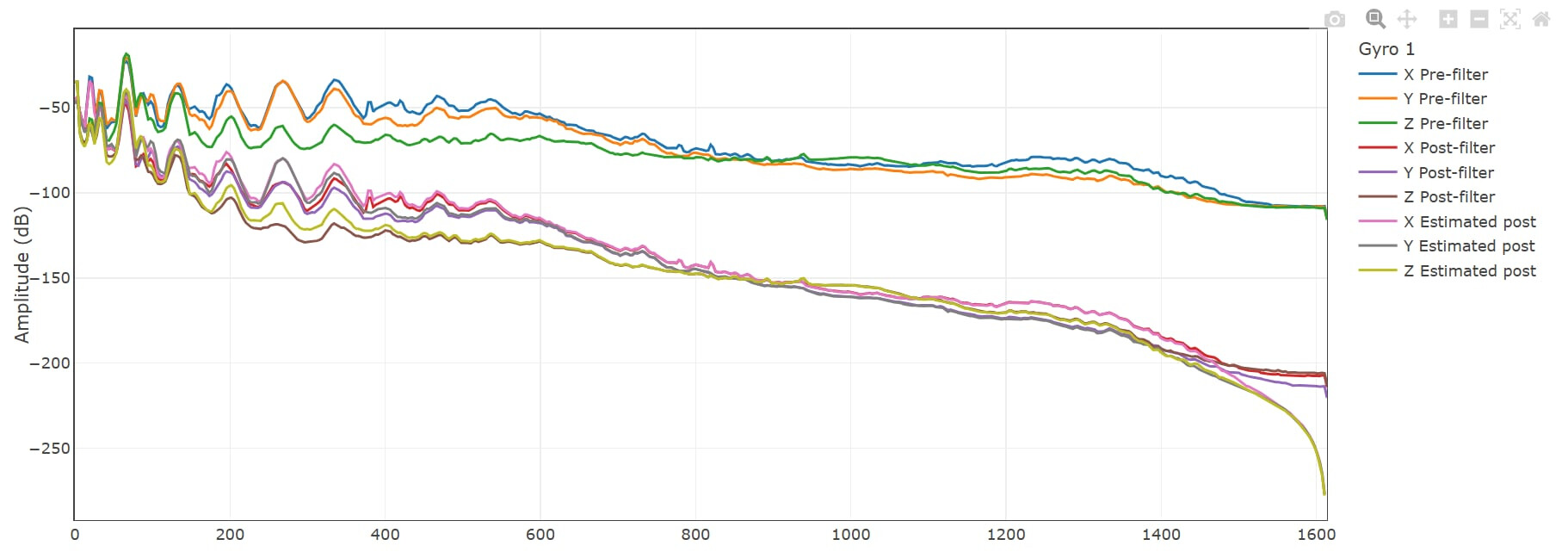

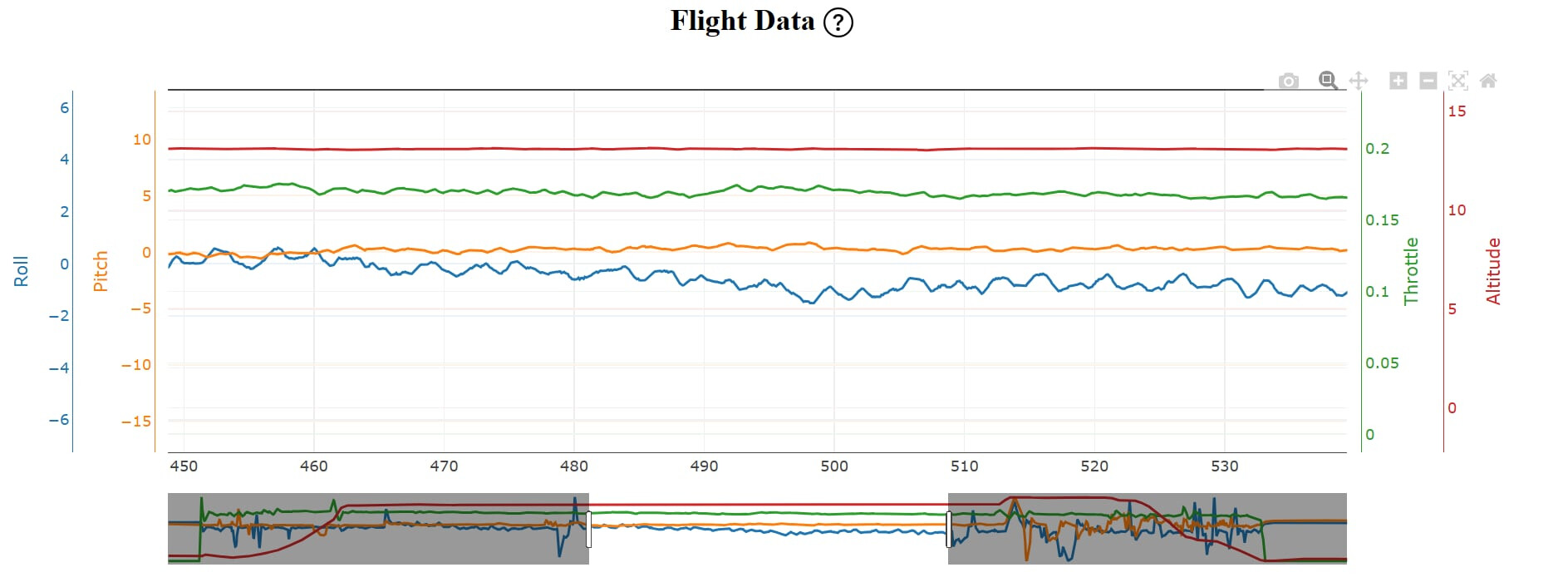

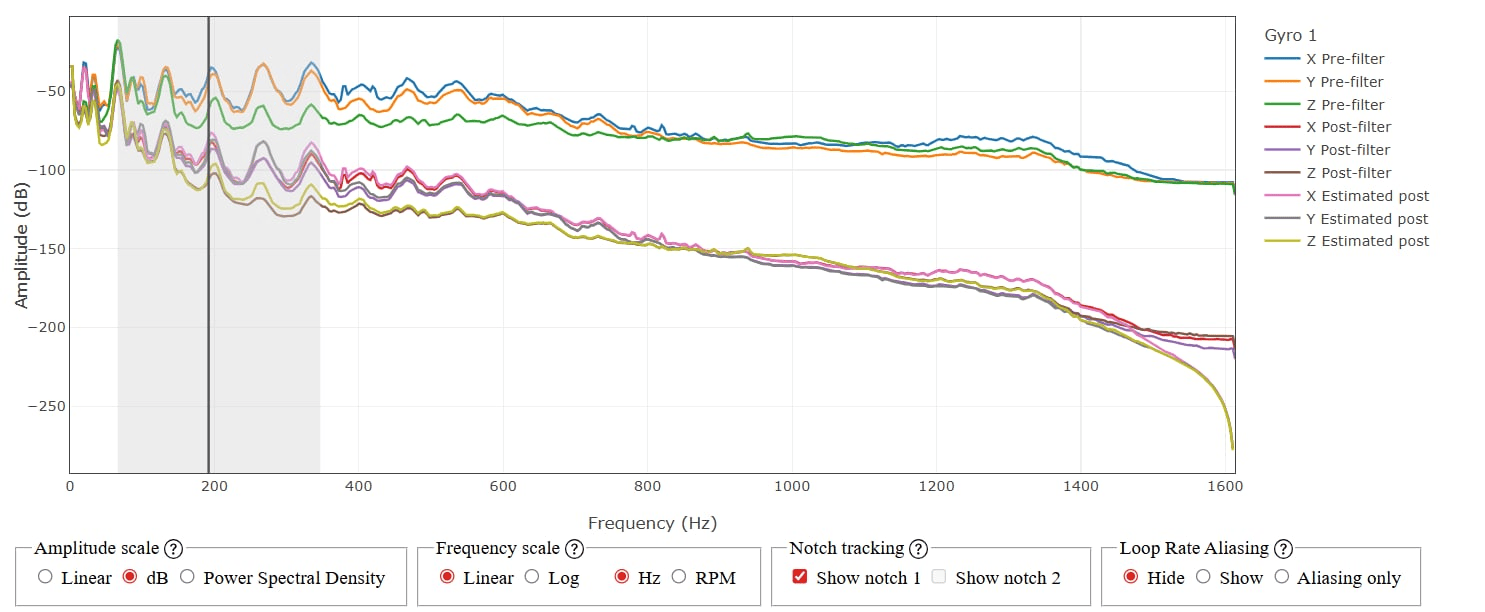

i tried “8.1 Notch filter calibration
my prefilter is already somewhere around -50 dB and after the filter it way below than recommended in the doc, is this normal?
Warm is ok. Hot is not ok.
Having post filter bellow -50dB is the goal. If it already is bellow -50dB then the goal is reached

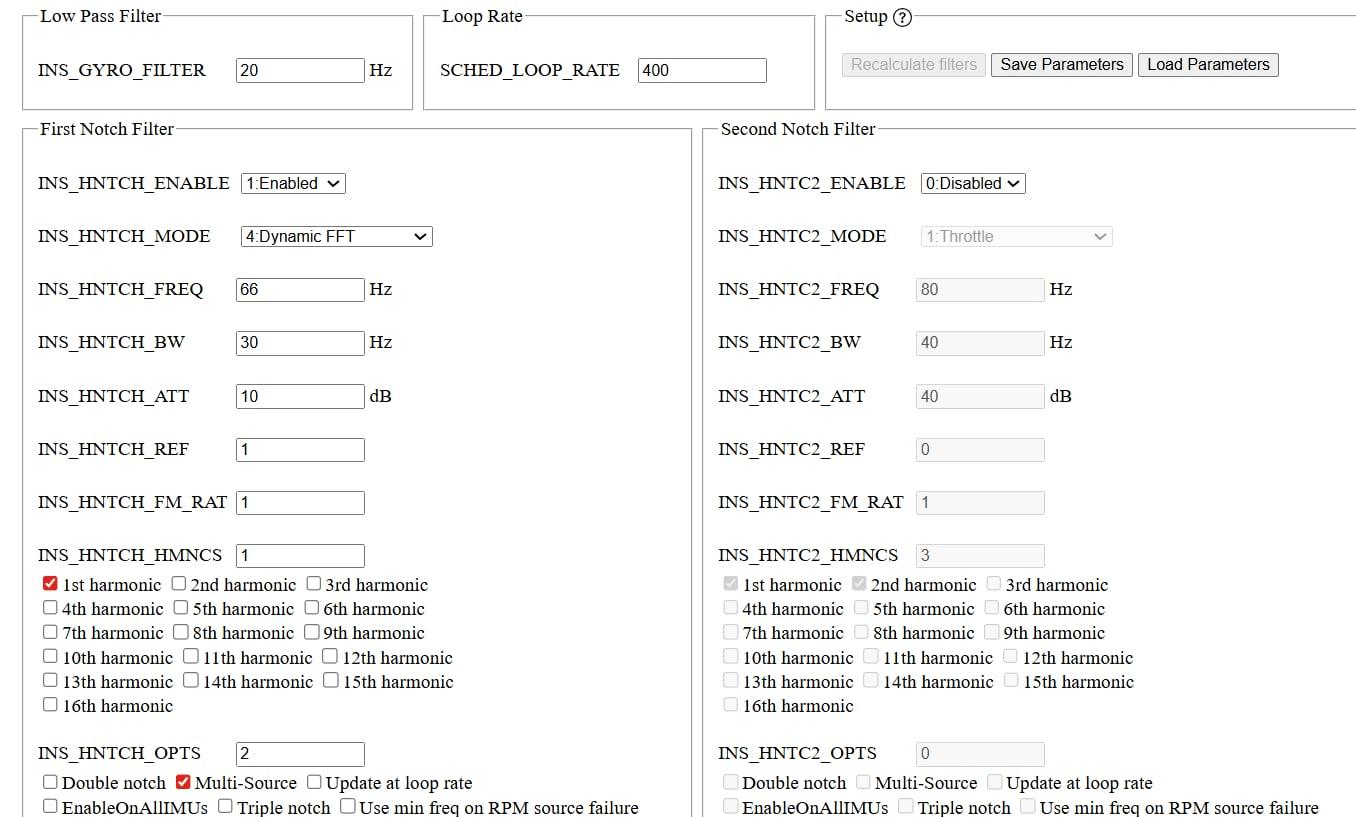

can i just increase the gyro filter to 200 ?

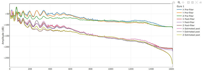

Does not look like the notch center frequency is tracking the noise frequency. Fix that first.
so the notch center freq. is around the peak that the highest right?
will this work? it doesnt seem so different from the post filter
No, that is very wrong. You need to track the first peak. And you should use ESC telemetry data for that.
