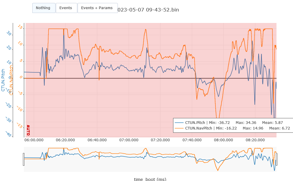

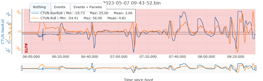

Hello there, I deleted my initial post as it wasn’t really clear about what I was trying to get after, I’m hoping to get some help interpreting my bin files and specifically the PID values. My
project is an electric motorised glider utilising an RFD900x telemetry radio that I use for telemetry as well as control inputs in manual or autotune modes.
Ardupilot 4.3.4 running on Matek H743 Wing. RFD900x. Matek 4525 ASI. Matek 3901 Optical flow sensor. 4S 3500mah LiIon battery. Heron Multiplex airframe.
Unfortunately, I don’t have any RC experience, although I do have flying experience and reasonable understanding of aerodynamic theory. This lack of RC experience has led to a bias towards auto missions that is further biased by what was a very successful first sortie with the auto take-off and land working flawlessly and a sense that even if there are some oscillations, ultimately it will land ok.
There has been a total of 4 flights so far, and the issue that I am experiencing every time is increasing pitch and roll oscillations during part or all of the flight, on flights 2 and 3 resulted in an ugly landing just short of the landing point with no damage, and on flight 4 a
departure early on final and a crash into a lake. I attempted an autotune on the first flight however I was unable to have many inputs as oscillations started and I hit the RTL. In viewing the bin files I believe that the PID settings need to be amended but I am hesitant to fly again without some improvement.

Upgraded to 4.4 beta. Airspeed indicator input disregarded. Long 5% final to try and ensure a stable approach.
Auto takeoff, I input some rudder followed by aileron just to visually see the effect. Shortly after the oscillations started. At some point RTL was triggered by voltage drop on take off or perhaps the oscillations.
In auto for entirety of the sortie, got it self onto final then pitch up and down with some wing drop and ended up in the lake a long way short of the landing point. I did not take over as it previously got back close to the planned landing point, and I backed the FC in over myself.
Looking at the pitch and roll graphs there is almost an 180 degree phase shift in the roll by the end. I am sure that the autotune will be able to sort most of this out but a closer starting point or anything else people might feel important or helpful would be much appreciated.
