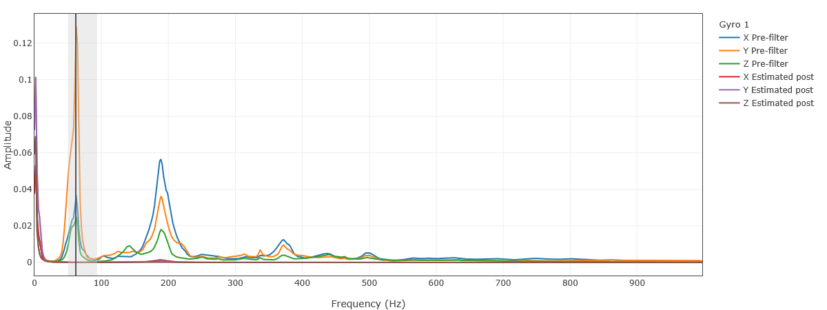

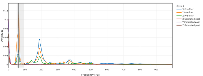

Here is the hover. What is the recommended setting for gyro?
I’ve never seen autotune break an airframe. If it did happen, that’s probably a bad sign for the airframe.
Pre and estimated:

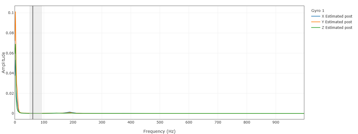

Just the estimated for clarity.

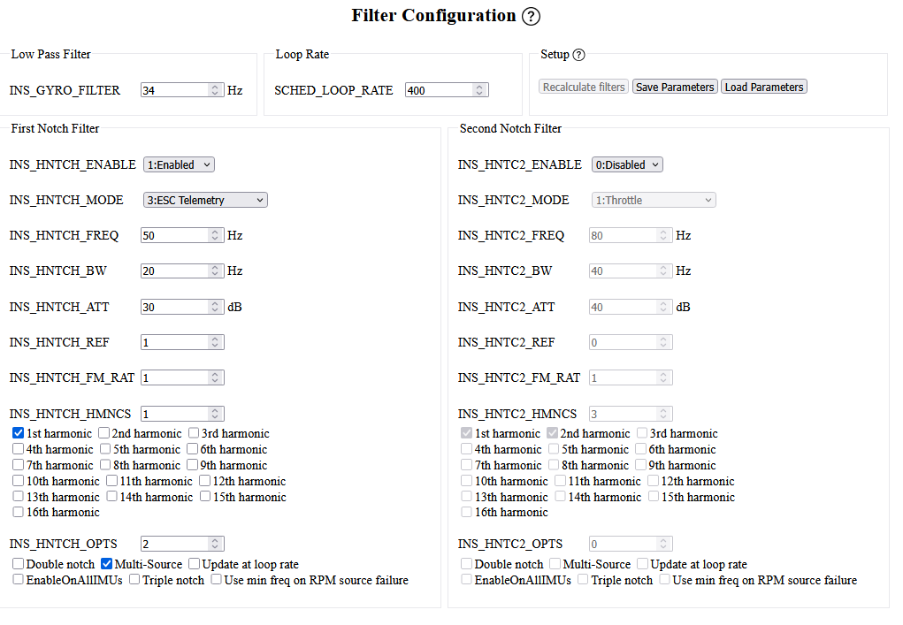

Here’s the settings I would have tried from that log:
You could maybe dial the filter in a little tighter but this would give you the idea. The second peak at ~190 Hz is still below -50db so there’s not a lot of value in using the processing resources for a harmonic so i left it off. It would probably just add more delay. Overall, a single ESC filter does very well on this.
