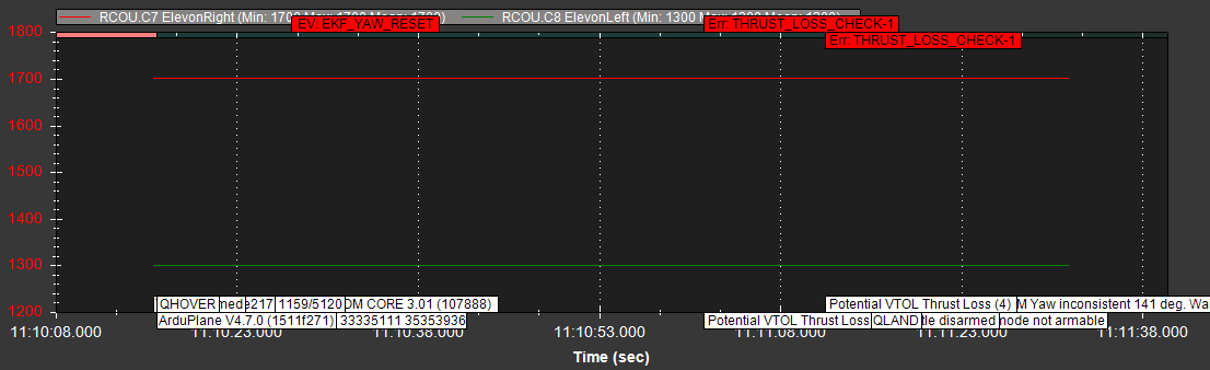

Thank you @iampete. No log yet–I plan to fly later today with the new settings and will gladly post the log. My observation is based on bench test. After setting the parameters to 0, I turned the plane on and moved it around without arming. I expected to see no servo movement, but they were moving.
Well, this is embarrassing. In flight it did exactly what the tin and @iampete said it should and the servos stayed at their trim outputs. I can only assume that when I did the bench test, I had it in one of the FW modes instead of one of the Q modes. #cannotreproduce #worksonmymachine

I am unable to reproduce the behavior on the bench. I can only assume it was user error.
