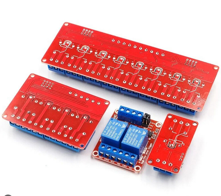

These red relay modules work with a high input with ardupilot. you can’t use a relay directly, The blue modules need pulled low and controllers have some issues with that.

I don’t think I understand what you are saying here. We are using a relay board like that in this project, with the high input. The ardupilot relays are currently:
  • Relay 1 - reads 1.4v-1.6v
  • Relay 2 - Works to trigger an SSR not pictured.
  • Relay 3 - Works to trigger a relay on the board pictured.
  • Relay 4 - reads 1.4v-1.5v
  • Relay 5 - Works to trigger a relay on the board pictured
  • Relay 6 - reads 1.4-1.5v
I have attached a photo of our relay board.

What brand and type is your Relais board.
Is a datasheet somewhere available?
From the picture I assume each Relais has a opto coupler driver stage in front.
Where exactly did you measured the 1.5V to 1.6V?
The relay board is from NOYITO, the 12v version as that is what most everything else in our system uses, also has octocouplers. That voltage is being measured from the AUX signal pin associated relay pin to the system ground rail.

It looks like the Optocoupler are directly connected to the Input terminal. Are an components on the backside? Can you make some detailed macro fotos from frontside and backside.
The datasheet of the optocopler shows a a forward voltage of about 1,2V typical 1,4V max with forward current 20mA. If the optocoupler is directly connected to the FC output without any limiting resistor in between and you measure 1,4 to 1,6V the optocoupler is using more than 20mA. This will cause a over current situation for the FC. To limit the current a serial resistor of 220 - 420 Ohm will help on 3,3V FC output.

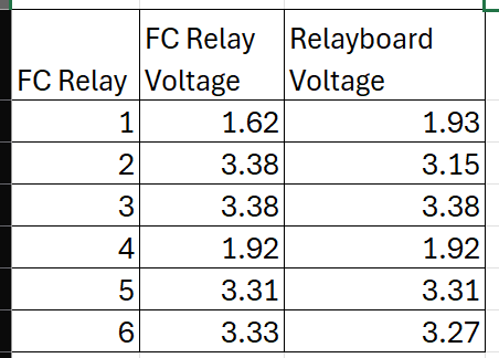

I just tested the relay outputs. Relays 1 and 4 are exhibiting the problem, and it occurs when they are completely isolated, not even connected to that relay board.
And to clarify, FC Relay is the relay being triggered using the mission planner dashboard (completely ignoring a remote control currently), FC Relay Voltage is the voltage measured directly from the Pixhawk’s Aux pin using a multimeter, and the Relayboard voltage is the voltage measured from the signal IN pin of the associated channel on the relayboard.
I know that each channel of the relayboard is working fine, that has been verified using a benchtop power supply.
Do I understand correct that the FC Relay Voltage on Channel 1 and 4 is measured while the pins are not connected to anything.
If it is so and the pin is configured correct as Relay pin, than your FC HW is defect.
You are correct, it is while the relays are disconnected from everything. Thank you for your diagnostic help!

I just double checked all of the pin params, they are each set to GPIO and the respective relay is set to output to it.
If so the FCs output driver stage is damaged. The most problem is that if the pins are set to high level you have a internal shortcut on this damaged stages.
