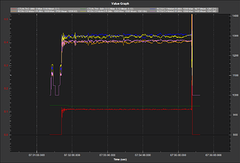

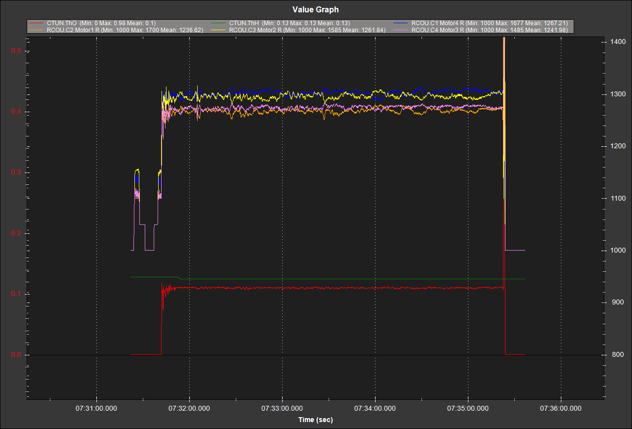

I’m having something similar. Front right motor cutting in flight. Also will randomly not log RPM data for one or more ESCs. Pulling my hair out trying to isolate it. Trying to get through a manual tune but issue persists presenting as a desync on front right motor about 10 times now. Random, no pattern (could be hover within first 60 seconds or hard maneuvering 15 minutes in, totally random. Here’s two from today. Any thoughts?
TBS Lucid 8S 60 amp 4IN1
TBS Lucid H7
Your drone seems to be underweight. You can try a bigger battery or add a dummy weight—Thrust auto learn will not happen if the learned value is below 0.125.

Interesting. Thanks for that. That wouldn’t cause the front right motor to shut down consistently, would it?
What am32 version is used? I had problems with 2.19 while 2.18 was OK.
Although I don’t see anything specific issues you can try other version and play with dshot speed, try 600 and rate triple.

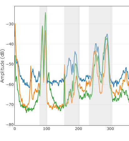

I noticed next things:
  • ESC might overheat - it states near 75c but it also can be wrong readings.
  • Need to address double peaks in gyro log - your props not in level - see screenshot
  • might bee to much filtration - lower att, your rig is not noisy
  • motor PIDs are too low - default are OK for 10"
It does not show either on the Ardupilot RCOU chart. However, your motors are operating at very low RPM.
