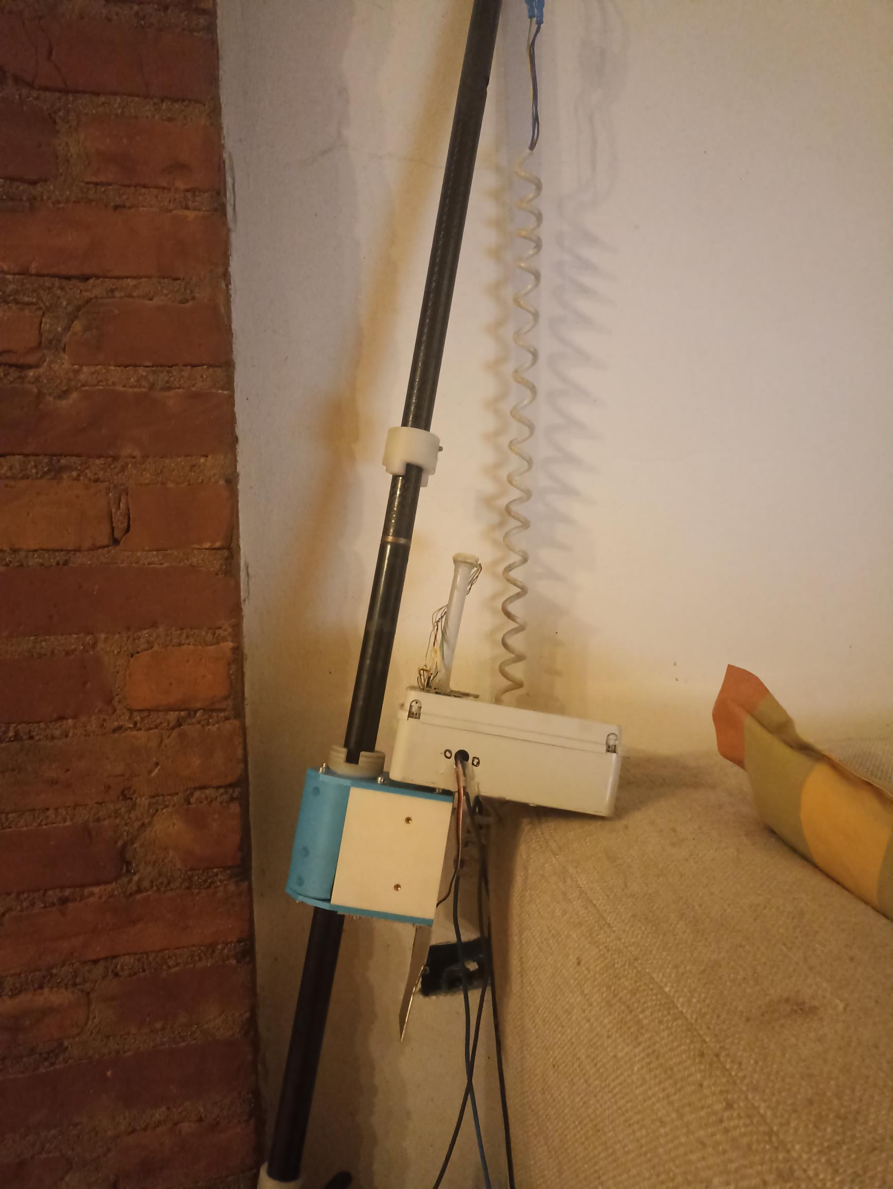

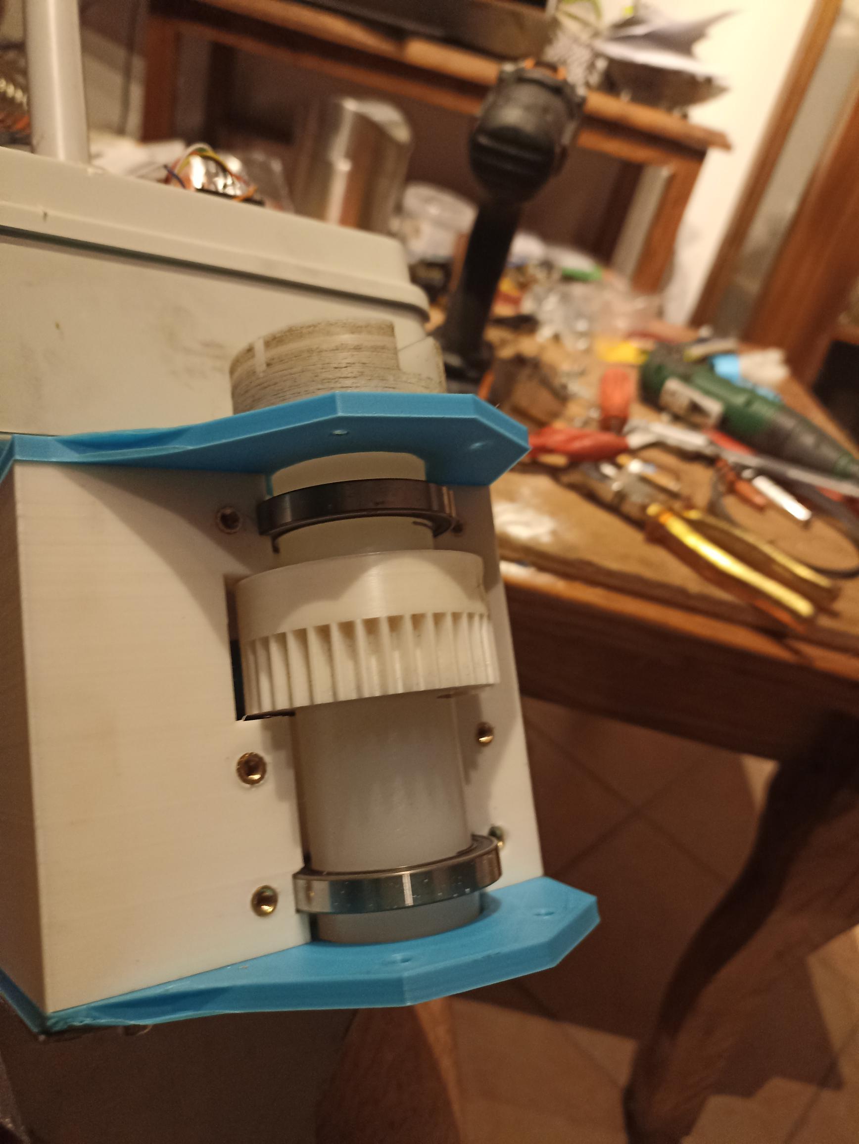

Here is the new steering box-
steering box + flight controller box (which will be integral with the boat)
I agree with you completely
looks good, but the gps still need to on the top of motor, right ?
Yes, it should be on top of the motor but having installed a classic servo, now I expect the steering to turn first (PWM> or <1500 us), then, when the boat is aligned with the steering direction, I expect the steering straighten out (PWM 1500 us). If the compass were above the engine the steering would certainly turn but once the desired direction was reached the steering would return in line with the boat even if it would not have turned at all. Then it would try to turn again but would return to the forward direction almost immediately. Then the steering would continue to turn and straighten.
In the previous setup where I had installed an ESC that controlled the steering, things were different. In fact, once steered (PWM > or <1500) the steering would not return to the position in line with the boat but would continue with the direction taken (since in an ESC with bidirectional motor pwm 1500 us means staying still)
I don’t know if I explained myself well… In any case I will start doing the first tests with the compass attached to the boat. I will see the behavior with the compass on top of the engine later.

Hi, have done this setup to make my kayak autonomous also. Same trolling motor but different steering. I’m using a servo and a steering link to a 3D printed arm that is locked to the shaft for steering. Simple but it works. My tunings is auto mode are not very good, but in loiter there work amazingly well. I have the gps along with the other electronics under the seat of the kayak. Just a suggestion. Maybe the gps being away from the motor helps.
hello El tigre and thanks for the advice. in fact (as per the title) I was convinced that the problem was the compass and the GPS. and in fact I moved it away from the esc. about ten cm no more. I will check your advice.
In that little box is tbe FC, ESC, power module, and even telemetry radio. And the gps on the other end. I put the box under the seat of the kayak and run cables to the battery, servo, and the trolling motor. The trolling motor at full throttle pulls 20+ amps. Are you using yours unamaned? I ride on mine I think the weight helps.
I tried the boat with one and with two people but nothing changed. What esc did you use for the engine?
