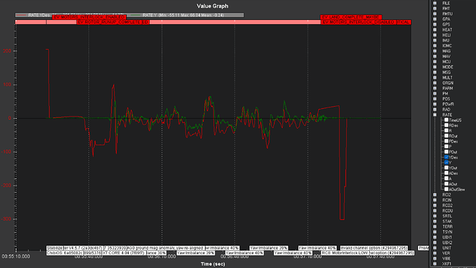

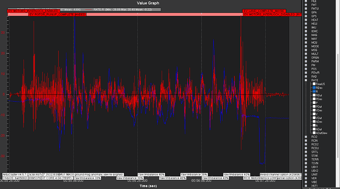

after installing the new Pixhawk 6c mini, and flip the rotation of the main blades to CCW

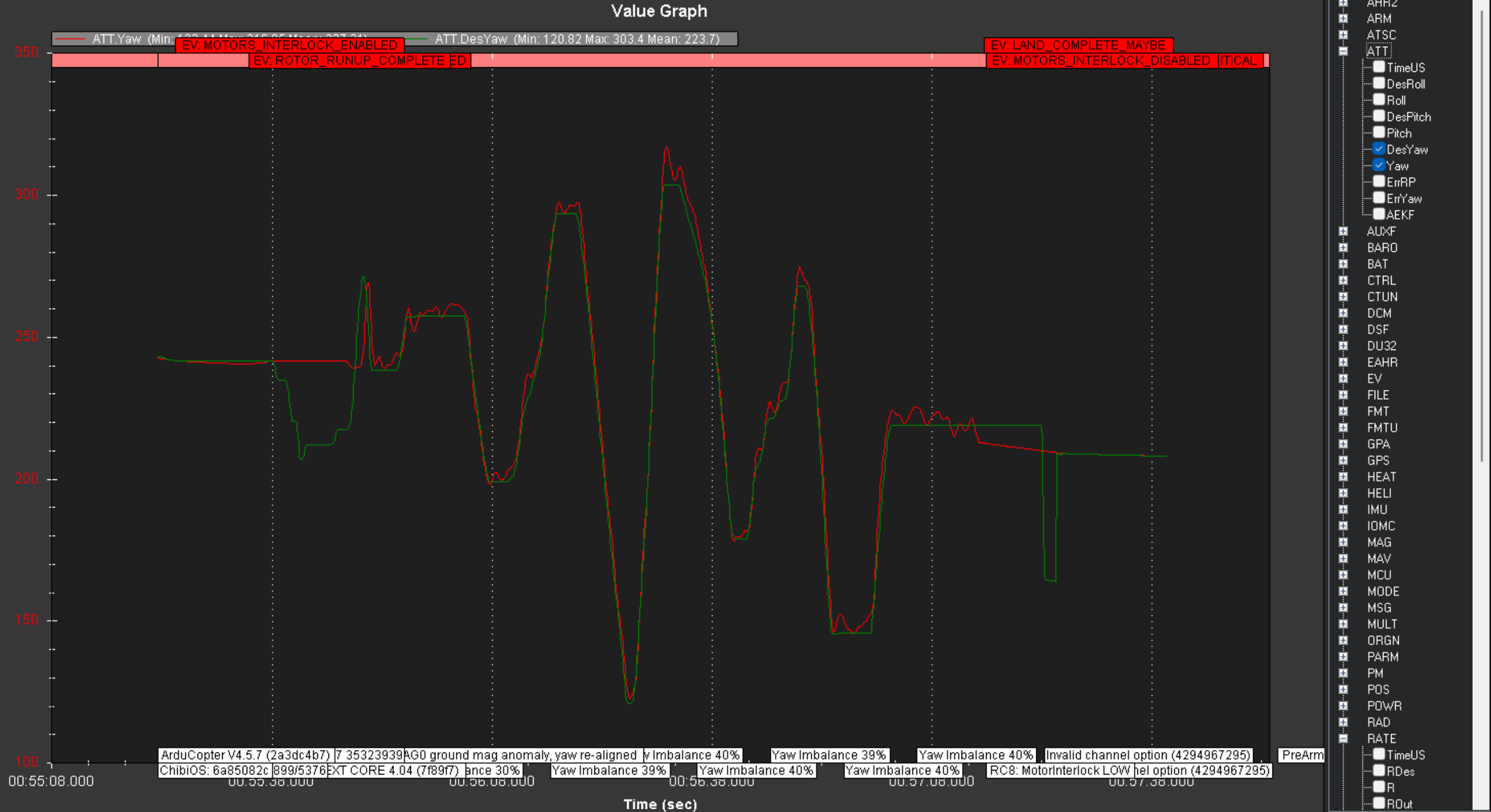

the values in the Rate and and the ATT are now way off, and this is may explain why I see "yaw imbalance of 40% " in my screen!

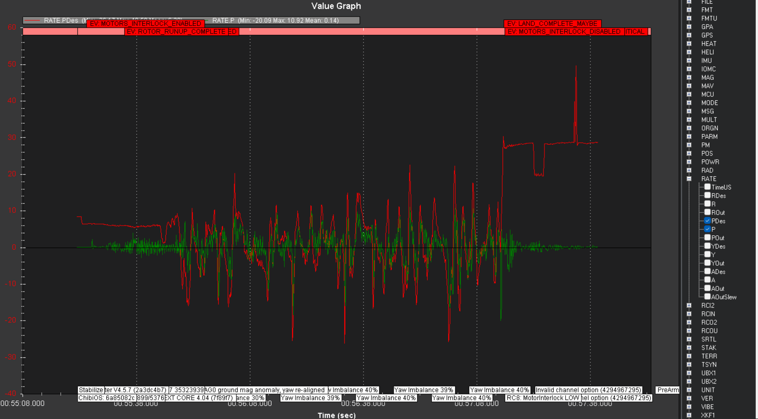

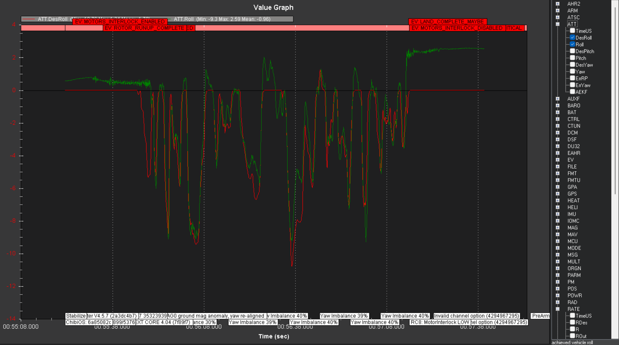

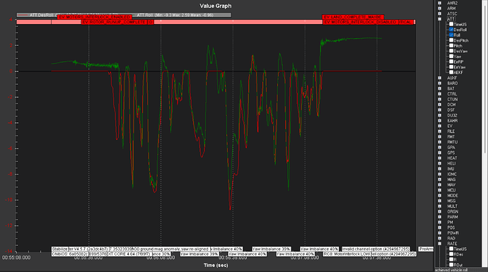

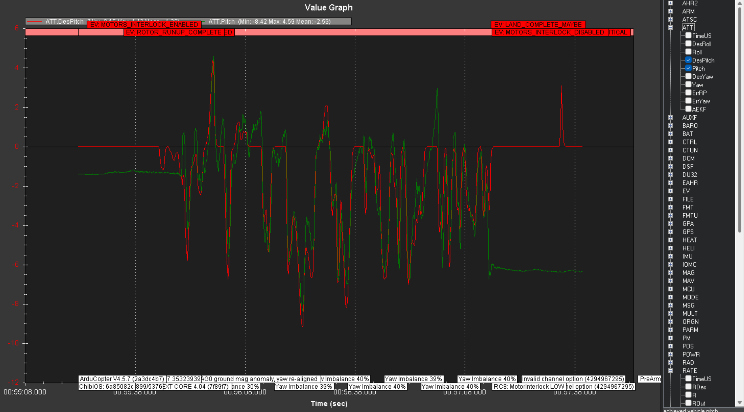

after pulling the logs all the values are not accebtable.. ATT yaw overshoot,
the ROLL also overshoot, and the PITCH too!

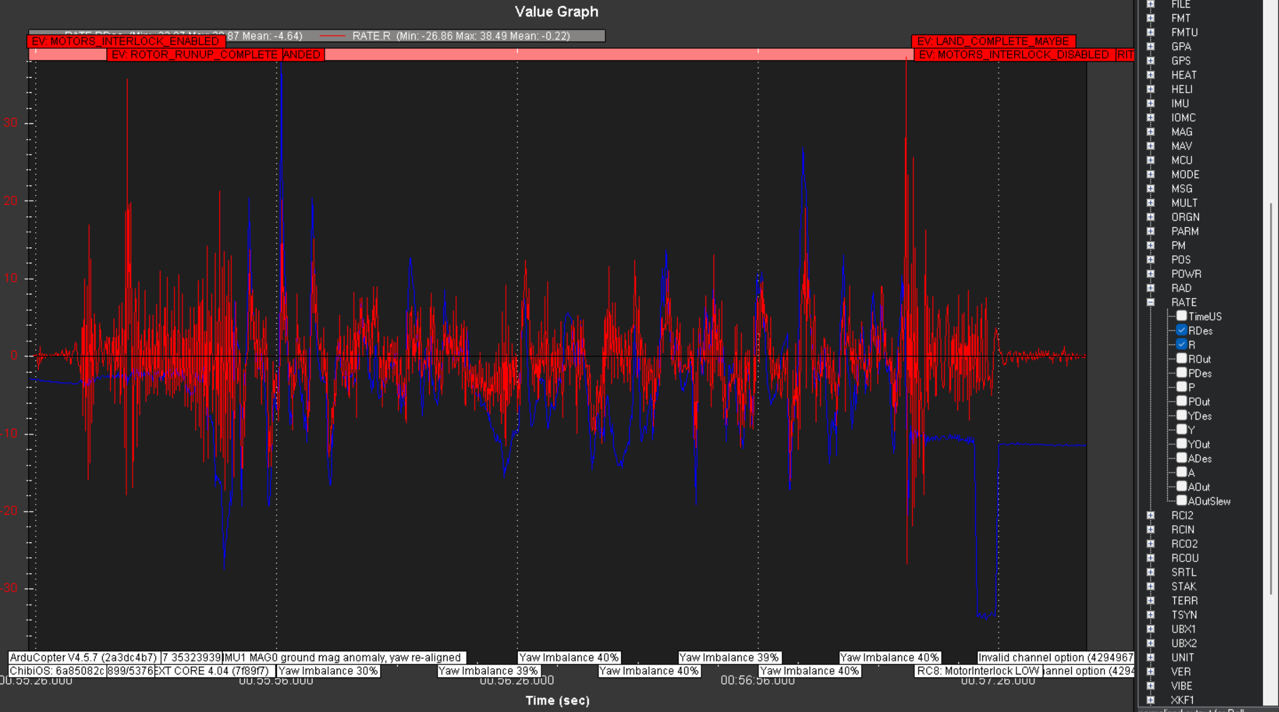

same witht he Rate as its not tracking P R & I
do I need to re-tune the PID from 0 ?

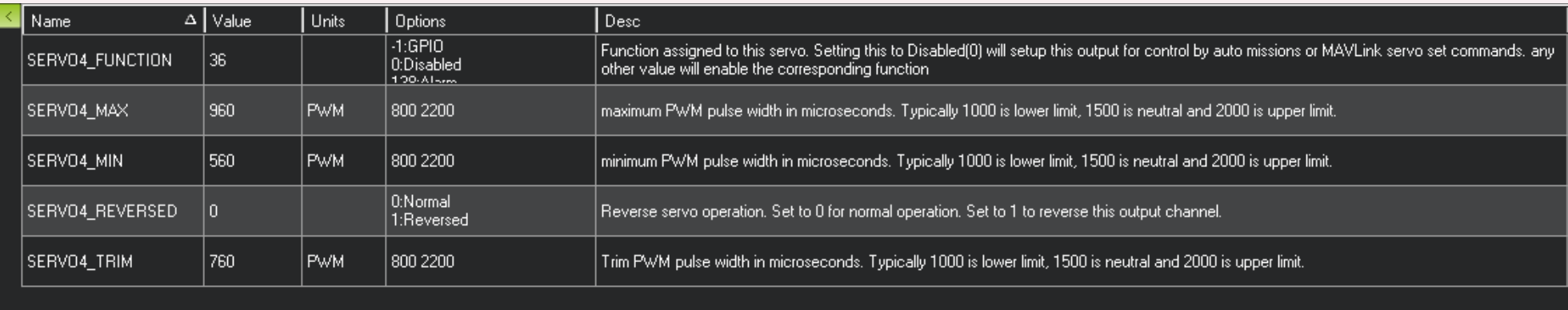

These servos are narrow band servos so they have 760us at natural position and 360us to 1160us
so the natural trim will be at 760,
I have set it to 760 and min at 450 and max at 950

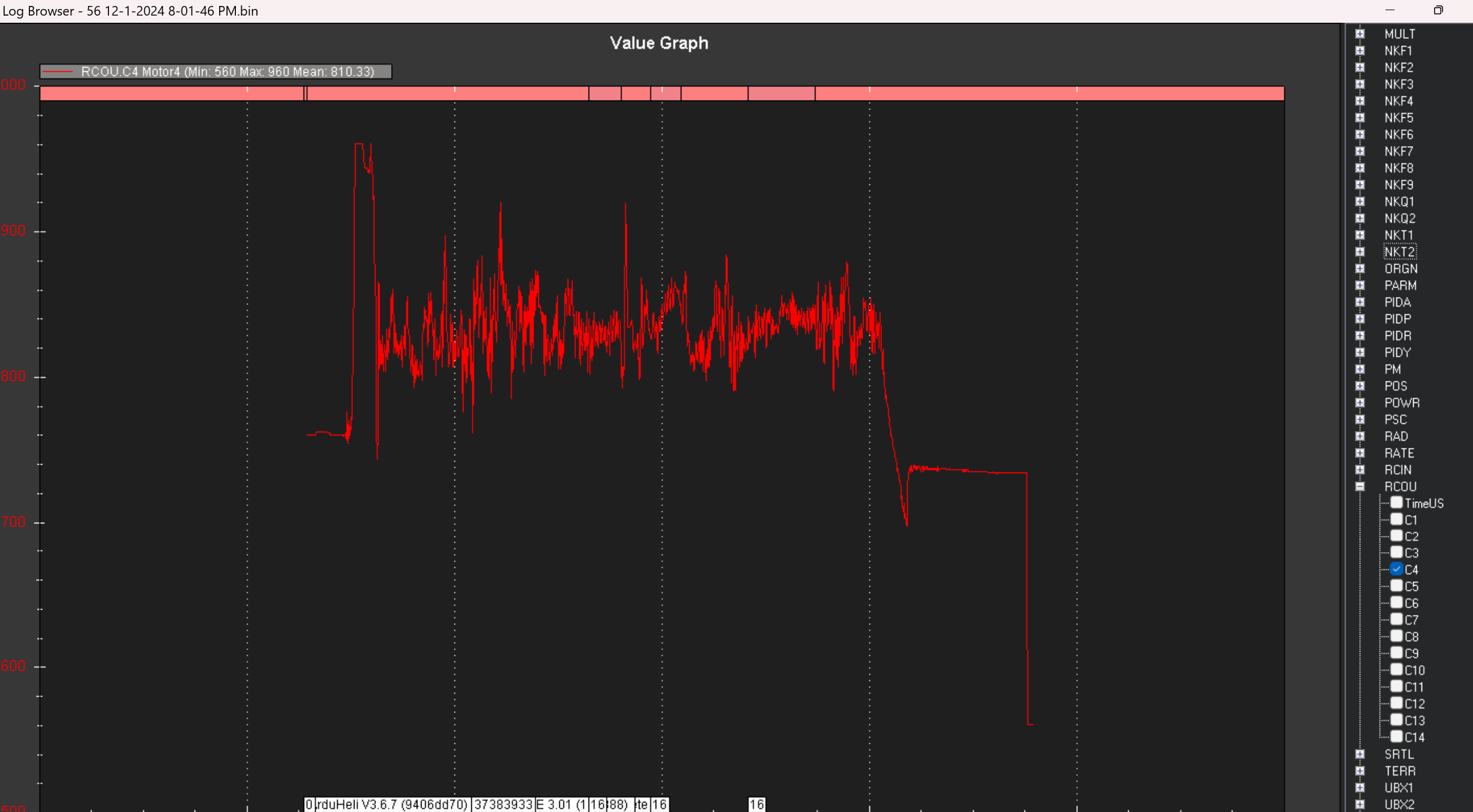

I think the yaw imbalance is tied to the trim. Look in the log where the servo is sitting for a stable hover and adjust it accordingly. That’s why I was suggesting 975 from the first log.
Can you please explain to me where to look, sorry for my dumb question but I m still learning the logs and how to read things, it’s complicated
Thank youn
Ozzy
In the log look at the servo output to the tail rotor. If you have the tail servo on channel 4 it will be RCOU.C4. Try to get the average when you are in a hover. It doesn’t have to be a perfect mathematical average, so don’t get too lost in the details over 1 or 2 PWM.
I tried to understand the way the servo trim working by looking to the old logs before I switched the rotation of the motor, main rotor and the tail rotor.
so here like you see in the pic the servo trim was at 760
I had no problem before, but now even with the same setting I have this issue!
so I am thinking maybe its related to the Motor CCW/CW change.
are you sure I don’t have to change any parameters when I change the motor rotation and the main/tail rotors?

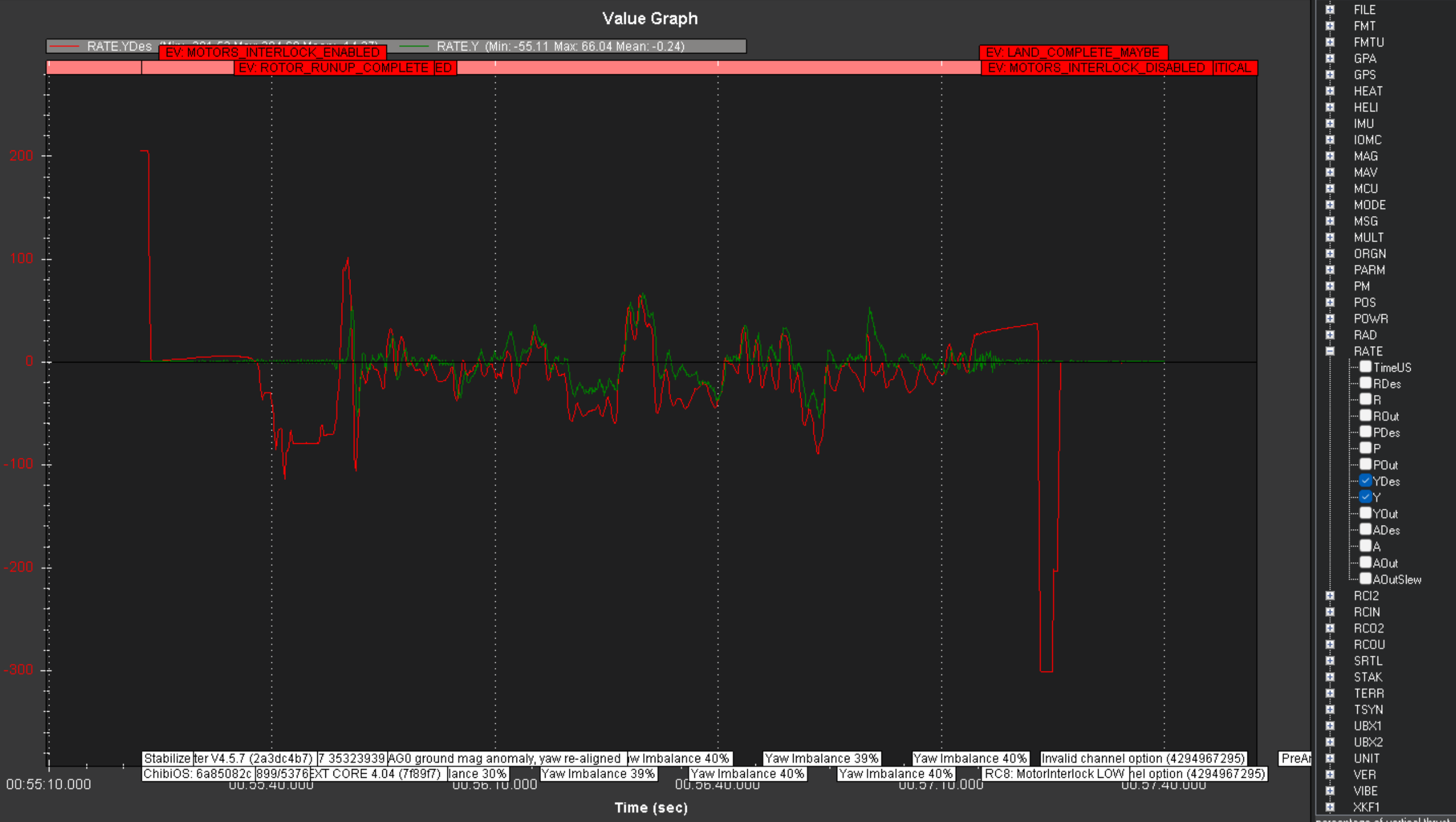

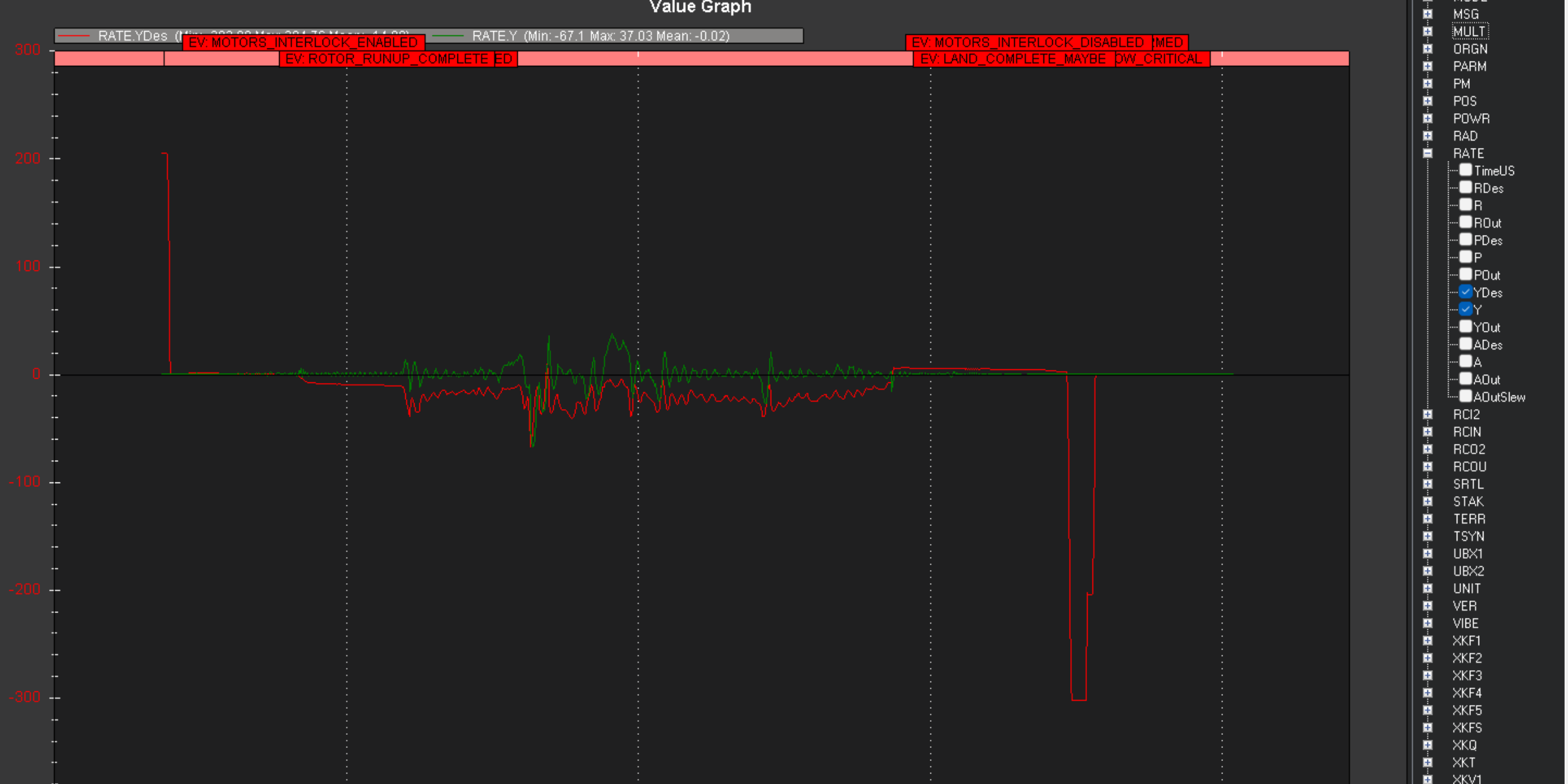

I have increased ATC_RAT_xxx_FF 3.9 and no hope!
the Ydes and the Y is still not maatching,
I will increase the ATC_RAT_YAW_I from 0.12 to 1.8
and try it out.
@flyingdragon
I am not the expert in ardupilot, but i think your servo4_trim should bei about 820 to 830.
This is the point your tail needs to be in balance. You can see it in your graph of RCOU.C4.
