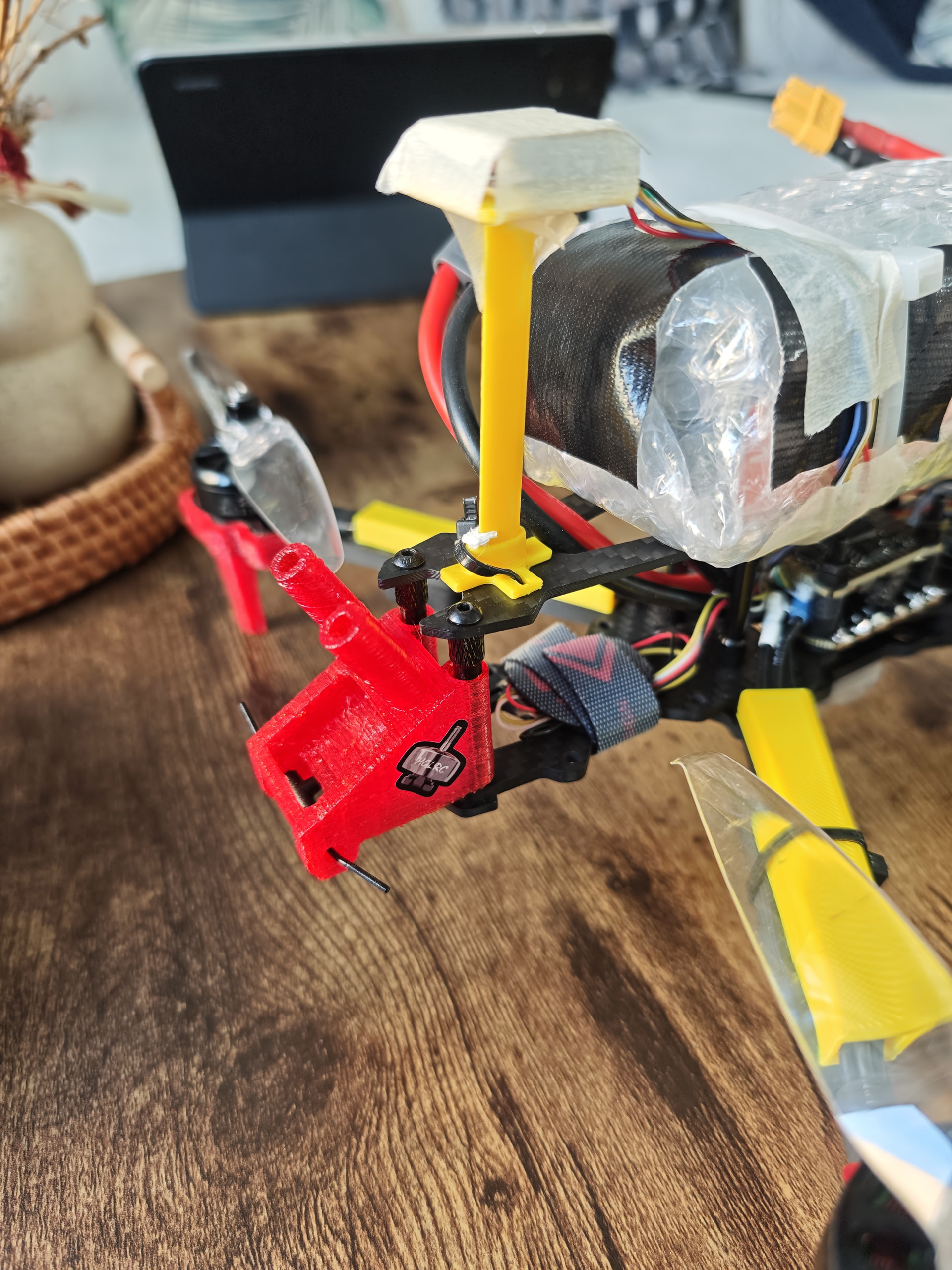

Adding some info here, in case it helps anyone in the future:
I did a test with the GPS +compass module moved to another location & had no luck.
Then I 3d printed a temporary mast & mounted the GPS on it.
Note: calibration done after every new mounting location.
Things noticed after moving onto the mast:
  1. GPS lock was way quicker, AHRS home position locked soon too & the drone went to 13 GPS satellites within a few minutes! This looked positive
  2. GPS compass calibration on “default” went through the first time for every attempt!
  3. Ekf for the compass stayed green, everytime I moved the quad & shows no jitter once stationary. Previously, ekf would go red everytime & jitter seen after being stationary
With the GPS being on a mast, I now have very good performance on loiter & switching between optical to GPS has no trouble.

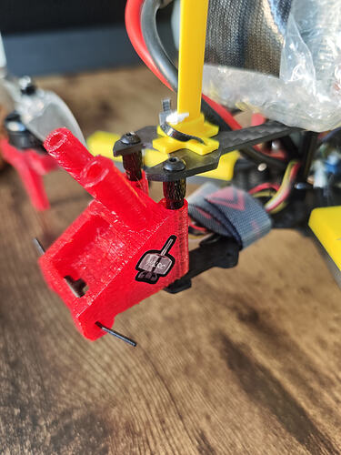

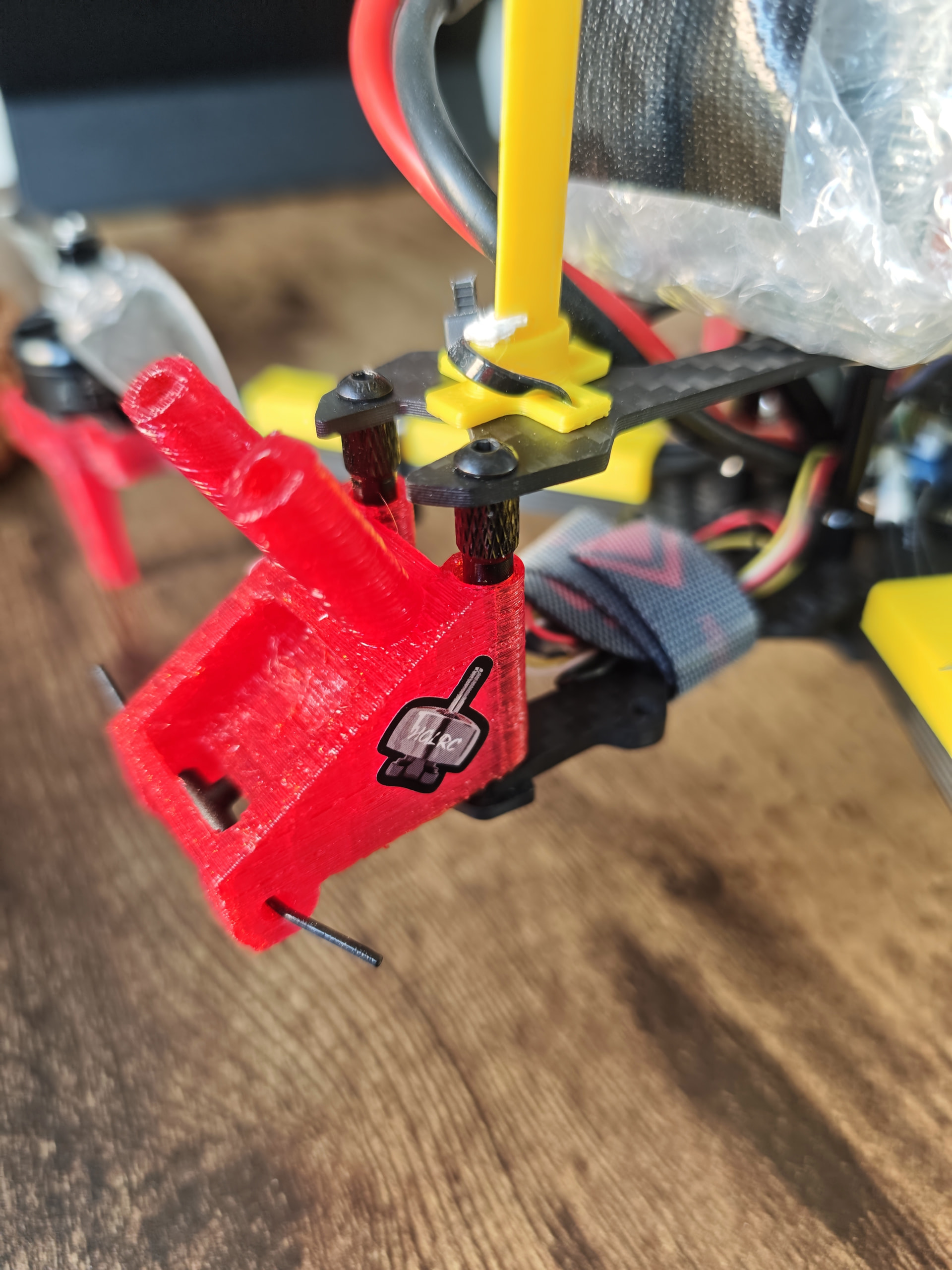

Here’s some pictures to give a visual understanding, in case it helps someone:
The GPS was in the red tpu printed holder which doesn’t seem like a good position for my build.
GPS then moved on top of the yellow mast (GPS taped on the top).
These are only temporary, I need to make the mounts better.
I will also shield the cables with copper tape for further shielding.
