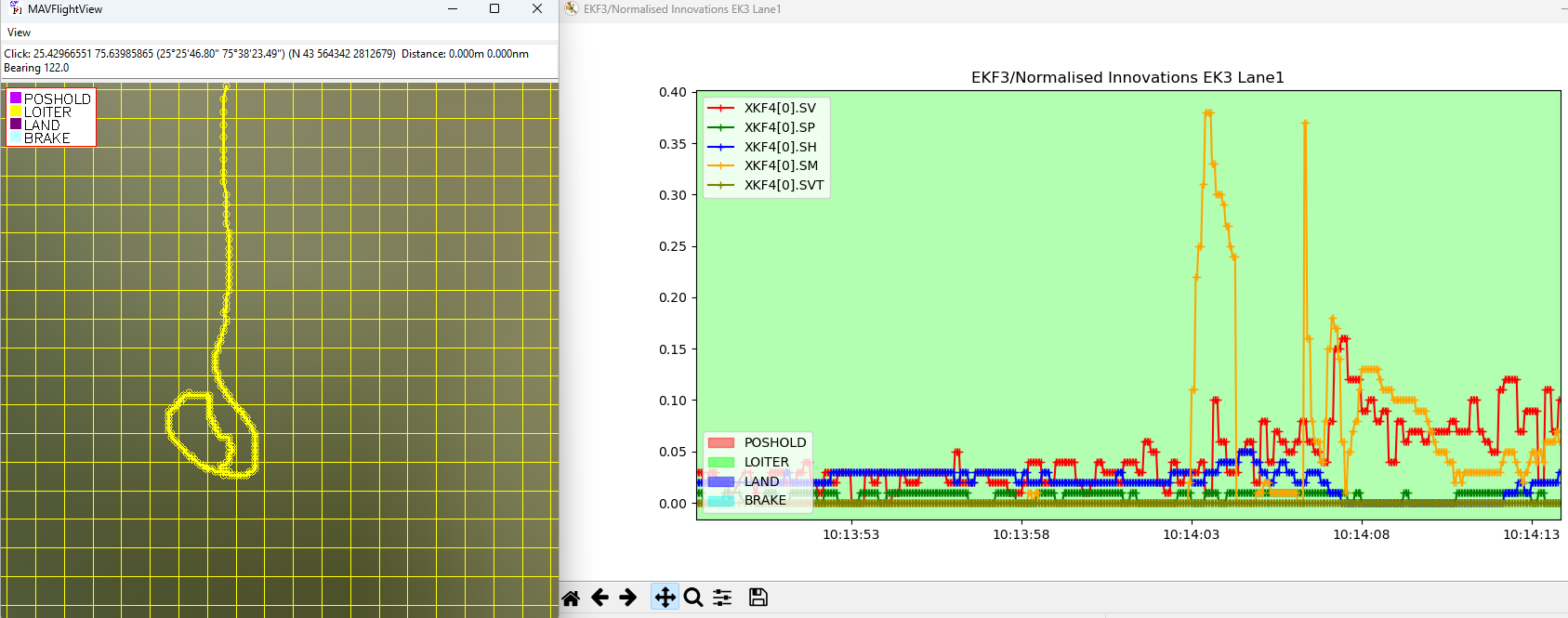

Some of our Agri Drones sent to customer from few days are doing Toilet Bowling after takeoff. They have done multiple times Compass Calibration, but the problem is still present. I couldn’t find out any problem from logs i checked compass offsets,Magnetic interference and mag X,Y,Z all are within the range. I am sharing the Calibration and Flight Logs, Please check if am missing something and any solution for this.

Thanks @Joshua_Kordani, after takeoff the drone moves in circle once the pilot gives pitch or roll,the drone is moving according to the stick inputs.
If pilot is not giving any stick input the Drone just keep circling,instead of hovering.
I see now. I ran your longest flight through magfit. Compass 3 seems to be the most affected during parts of flight, you might consider disabling it. After pushing this to your craft, also consider doing a more comprehensive magfit flight.
When you land, are you near some big piece of metal? I assume you’re refilling a tank with some ground equipment?

Hello. Retired electronic engineer here. I have no experience with Ardupilot but I do have some years of working with multi-axis line-of-sight stabilization servo systems.
Referring to your graph of flight path, I see the circling motion. I also see that the “straight” path before the circling motion is not straight but wanders left-right slightly.
If this were one of my old LOS projects, I would suspect some small cross-coupling of axes.
The circling motion is actually an oscillation occurring in two axes.
Some small part of X axis if feeding into Y axis and vice versa.
Your apparent wandering left-right during “straight” flight just continues when the command for straight flight becomes zero. With no forward flight, the wander becomes a somewhat circular path.
The cross coupling between axes could be mechanical, due to rate sensors, due to accelerometers, or even due to some variable intended for X-axis being wrongly used in Y-axis calculation. Or Y-axis variable being used in X-axis.

Compass 3 is near motor power system, Will disable it. Right Now the Drone is at customer location, might take time to reach to the office. Customer uses the drone for spraying. Can find out tomorrow whether they are landing near any metal equipment? Any particular reason.

While the system was landed both times, there seems to be a large mag field that goes away after takeoff, unless I’m misreading the graphs. I guess it’s neither here nor there, just trying to figure out what I’m looking at
This might be all you need to do and run Magfit. Post a link to a log after doing so.

Thanks Everyone, one of our engineer is on the way to the location, I have informed him to do the magfit flight and disable the Compass 3. Do the test. He is taking extra modules to change if any issue persists. Will share more details.
