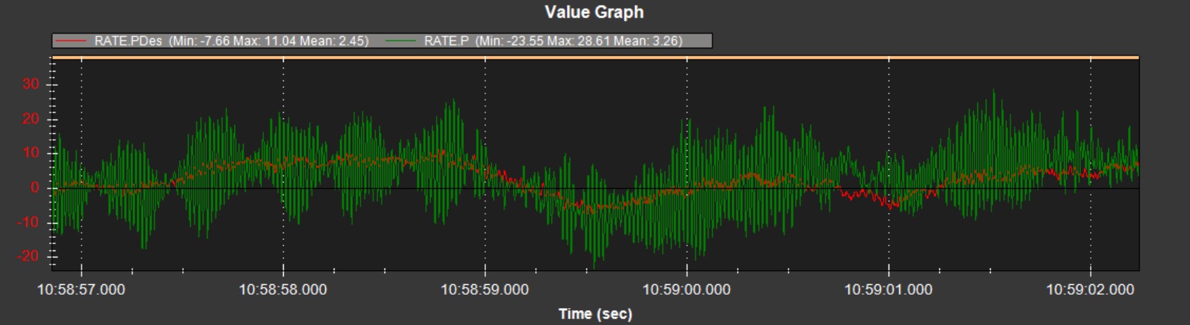

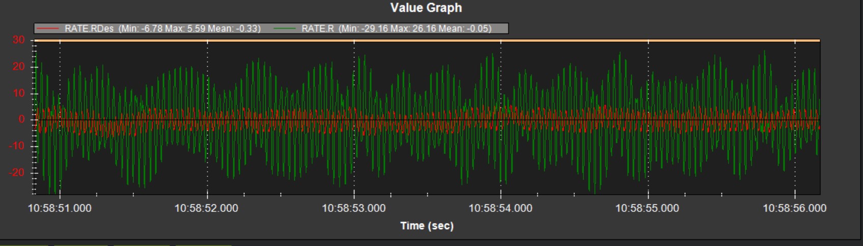

I conducted a short flight and put the 1 folder into Dropbox - I hope that you can access it click here. Also in the 1 folder is my full parameter list called “full list”. In addition, I uploaded a video of the flight - I took off in Stabilize, switched to Alt-Hold and then to RTL click here. Let me know if you cannot access my folder in Dropbox.
Yup, that needs tuning:
It’s not a disaster, but there’s lots of room for improvment.
First thing I would do is try to improve the filtering. I see it’s on FFT and looking at the log it doesn’t seem to be working. I’d try a throttle based filter and get that dialed in. Then go back to tuning.
You have output and Rate oscillation. Rate oscillation is particularly bad.The Notch filter is misconfigured so it’s it not tracking anything.
Set the Vertical Acceleration Controller gains based on hover throttle (~0.13).
Forget the FFT based Notch filter and use a simple throttle based one.
The Rate PID’s need work but Auto Tune likely will error out from the oscillation. Do the above and run Quick Tune which probbaly will run. The run Auto Tune.
Or, you could try the Methodic Configurator again which covers all of these things.

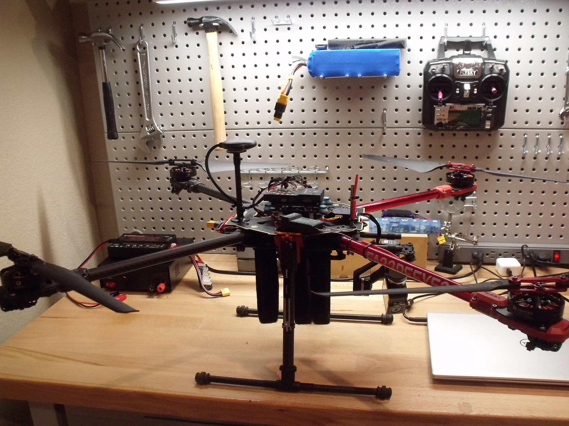

Looking at the logs a bit more, there’s really something moving on the Y axis. The vibration levels aren’t bad but I think it’s creating a resonance that’s showing up in the filter. It’s at a low enough frequency that (just making some guesses in my head) it might be a multiple of the two bladed propellers. Have a good look at the antennas and the mounting for everything. Be sure that nothing is moving or loose.
I differ in some of your build choices: (These are my opinions and advice. Like all free advice it’s worth everything you paid for…)
I don’t like those GPS antennas on the masts. I have always found those masts to be more source for problems than any good they have ever done. If those are the folding variety then that could be contributing to the issues that are showing up in the filters. My choice would be to mount the antenna lower on a mount that is more rigid. Do you have access to a 3D printer?
I also don’t use soft mounting of the flight controller. That too could be a source of the problems. My choice it to hard mount the controller unless I’ve proven there’s an issue or I’m using gas engine.
Of course, your milage may vary.

My default go to for flight controllers (if there aren’t screw mounts) is to use double sided Gorilla tape. It’s ~2mm thick and holds the universe together. Make sure everything is clean and you’ll be fine. (if you re-mount the flight controller don’t forget to re-do the Accel calibrations)
You might even be able to get away with just cutting that mast shorter. Just high enough to get it away from everything. That will take out a lot of the flex.

From the first photo, the center of gravity appears to be located slightly below the flight controller. The GPS also seems to be mounted toward the rear-right side of the vehicle.
Setting these positions correctly first would provide a better baseline before proceeding with the tuning process.
It also looks like the flight controller may not be mounted perfectly level from a hardware perspective.
