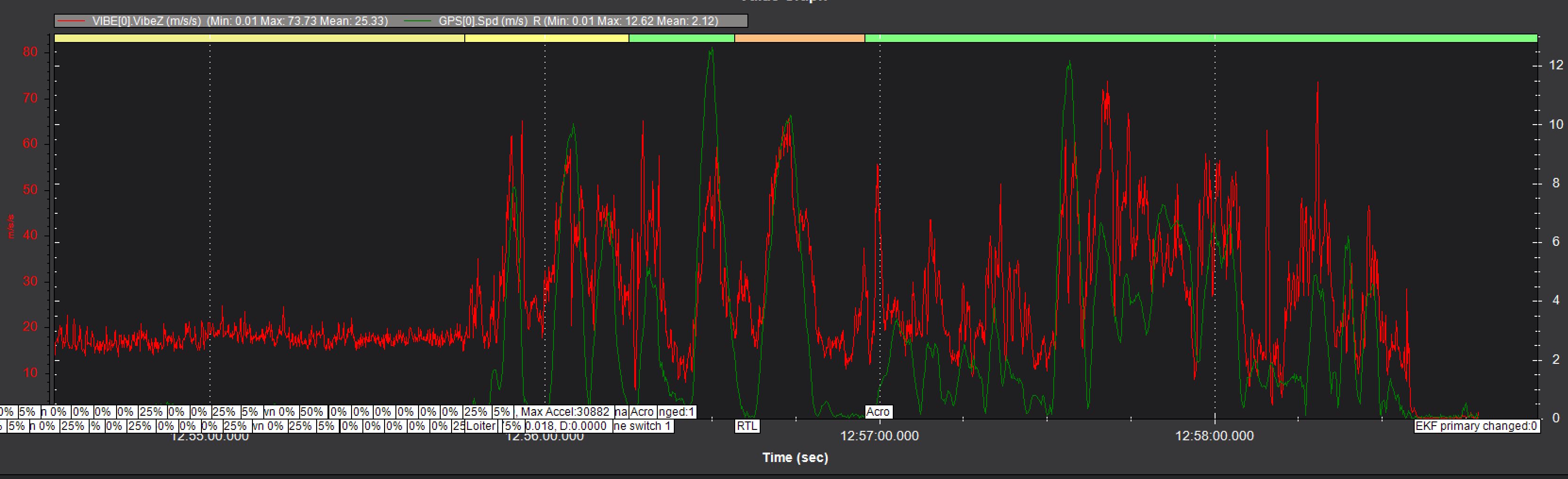

Same problem with 4.2 firmware. i built up new quad with different motors and props but nothing changed. this time 2 motors are getting hot. in acro mode no problem. tomorrow i will try MatekH743 firmware.
Another question Vibe logs show after Autotune vibration levels change. is there any explanation for this?
Thanks.
https://drive.google.com/file/d/1kGqQgmsANJDSUV1-vpOFxeBOaznfDEMj/view?usp=sharing
I think you can see the explanation for that.
