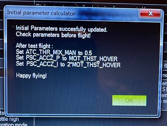

Good evening. I’ve been having difficulty tuning the parameters for my quad. I’ve managed to achieve excellent tunes with 1045 and 1245 props, but the 1147 CF props I have are giving me trouble. I’ve started with initial tune defaults from mission planner, but I can’t achieve a steady altitude in Althold or Loiter. I have harmonic notch tuned decently, but as soon as I switch from stabilize to loiter or althold, the quad will not maintain altitude. It surges the throttle. This is more apparent in position hold so I lowered the ATC_THR_MIX_MAX to 0.15 from 1, but this didn’t seem to help.
Yes, my Z vibe is high. This has not been a problem for the 10 and 12in CF props. When using plastic 11in props, I had to mount the FC on gummies to reduce Z vibration. When using gummies with the CF props, I haven’t been able to get a good tune. Nonetheless, I don’t believe it is contributing to the surging as the same Z Vibe values have not affected stability with the 10 and 12in props.. Any advice?

I think you forgot setting your vertical controller as configurator suggests.
Also allow your notch go down from INS_HNTCH_FREQ you set with INS_HNTCH_FM_RAT, 0.75 and capture the filtering result with INS_LOG_BAT_OPT, 4
