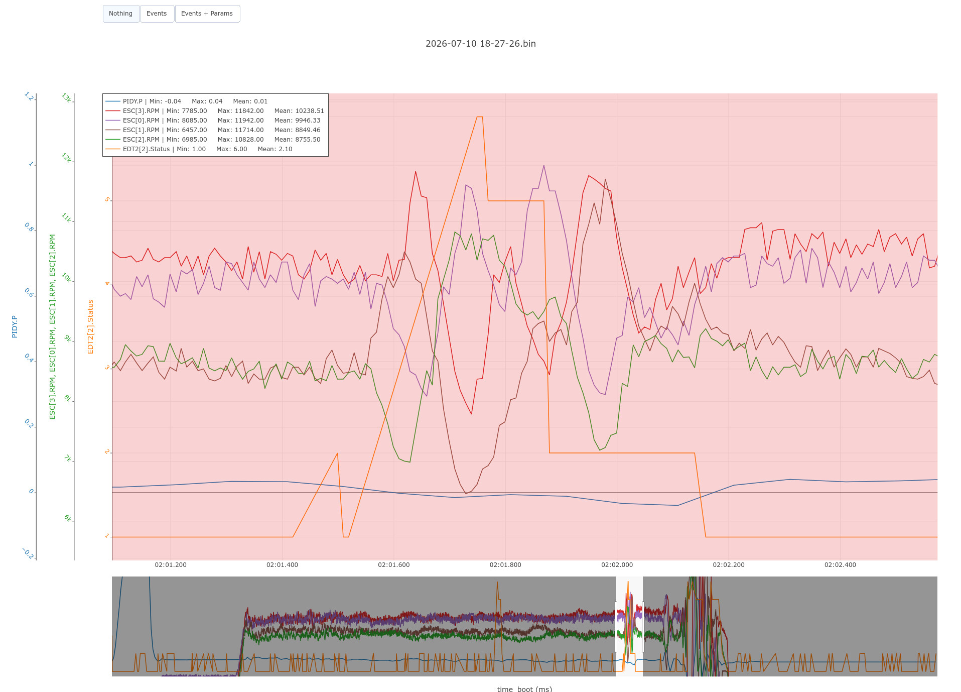

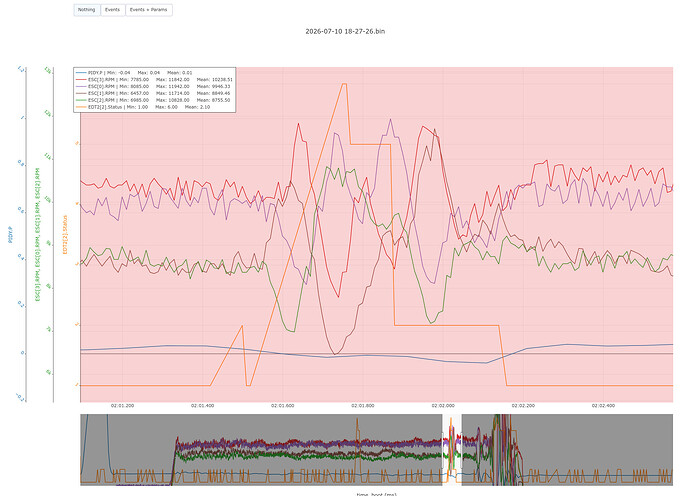

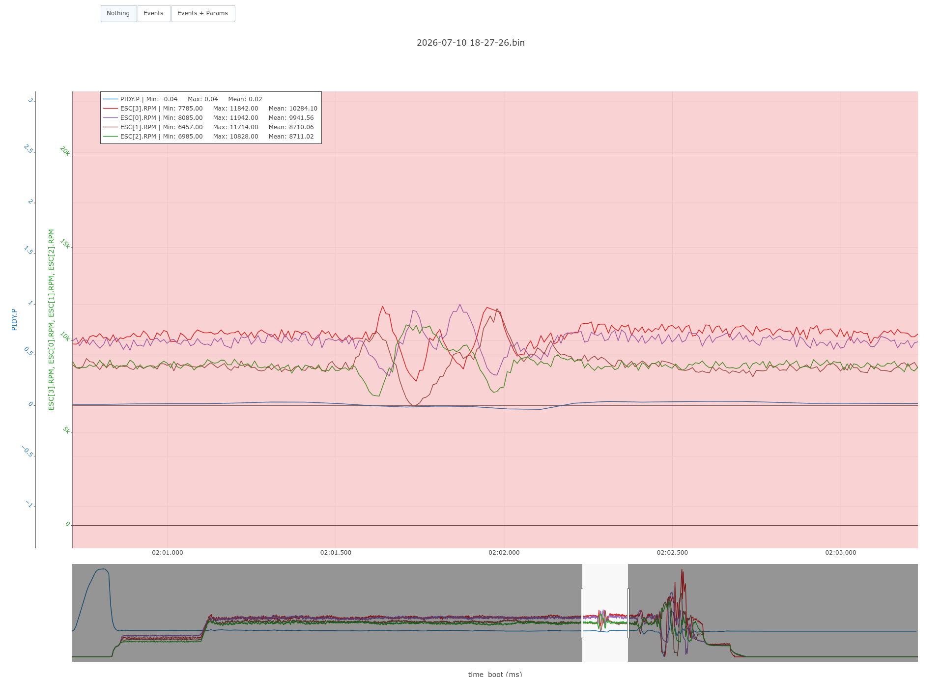

Regarding the crash itself, things are not exactly clear, but there are multiple signs pointing towards a possible ESC failure. In particular, right in the middle of plain hover (Loiter and no inputs) there was a hiccup mostly on pitch, but also affecting yaw, happening out of nowhere between 02:01.5 and 02:02.2.
When looking for the possible causes, I realised that the machine is running Bluejay which provides EDT2 entries for Extended DShot Telemetry v2 (which I happened to introduce support for some years ago), and that at least one ESC (the one corresponding to the forward right motor) experienced an event triggering an Alert bit during this episode.
A different ESC, the one running the forward right motor, is in the Alert state all the time. It’s important to note, however, that this Alert is by itself the lowest problem-indicating bit according to the specs. However, this may indicate some problems, and when we come to the actual crash, we see this:

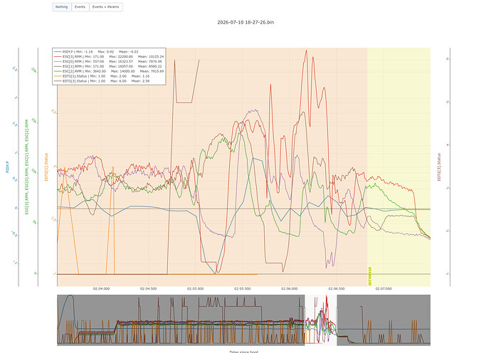

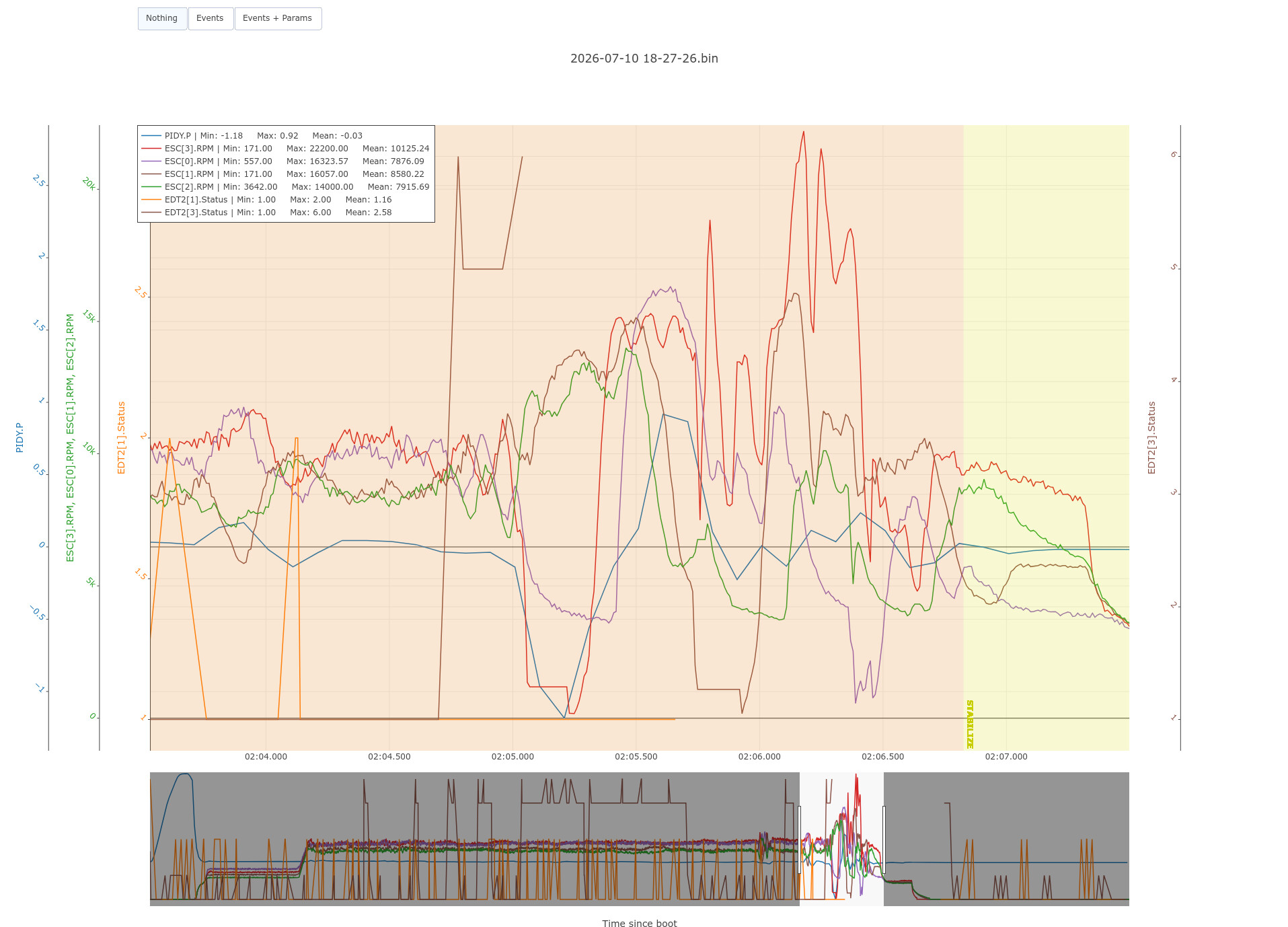

Here, we see that the EDT2 stream stops completely for ESC#2 (forward right) at the same time it goes to near-zero RPM, and that the EDT2 stream stops completely for ESC#1 (rear left) at the same time this one goes to near-zero RPM. This indicates these ESCs are really struggling internally to provide appropriate telemetry. The region of same RPM reported is likely the absence of telemetry as well, so each of these ESCs were offline for at least 0.2 seconds.
Overlaying the corresponding servo outputs (RCOU.C2 => ESC[1], RCOU.C4 => ESC[3], the RCOU indices are one-based and the ESC ones are zero-based), we can see that this low-RPM region was not commanded - although the initial deceleration might have been actually commanded:
All combined, my conjecture is that the cause was some kind of ESC failure. Whether it was simply a desync that was not recovered from, or anything else, I cannot speculate as of now. One other thing worth checking is whether you are running the latest Bluejay, just in case.

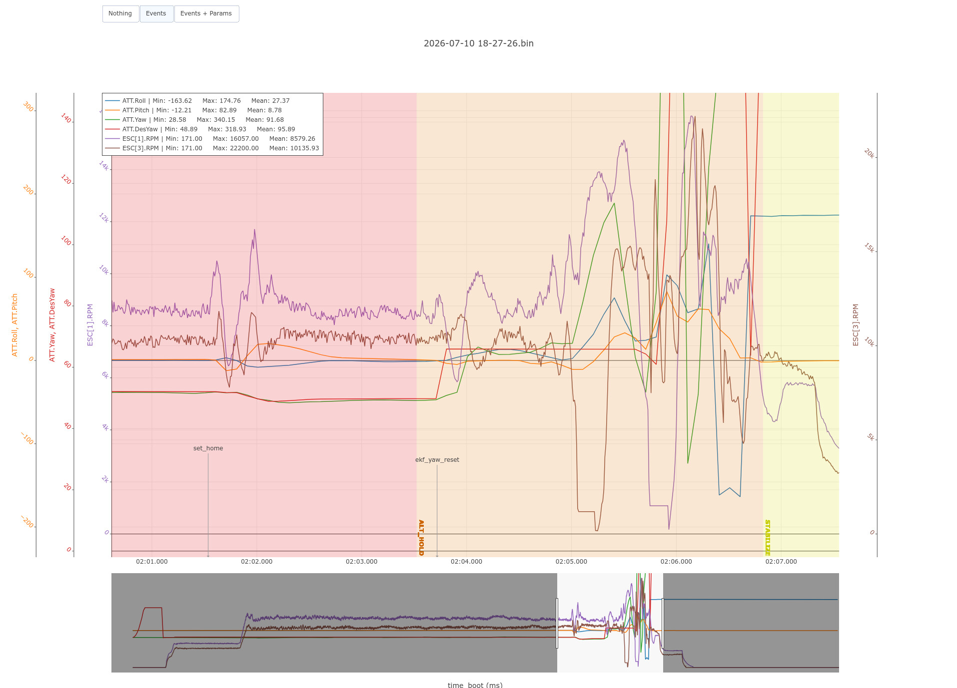

Now I see that the initial “glitch” around 02:01 is caused by setting the home location. At that moment, two coordinate system reset events happened in quick succession, with one setting the destination point a couple of meters away from the current location, and another changing that again, but in an opposite direction. That jumping was likely caused by unreliable GPS reception just before that (HDOP = 2.3 or so, jumping back to 1.1 at the moment of set-home). It’s this event that caused that “glitch”, which was not a low-level glitch at all - just the machine trying to follow quickly changing setpoints.
Then the pilot switched to AltHold (a bit before the second setpoint was reached). Quite at the same time, a EKF yaw reset happened with a change of 15 degrees, and the pilot started to perform inputs on roll and pitch (but not yaw), possibly to get the machine back to its original location.
