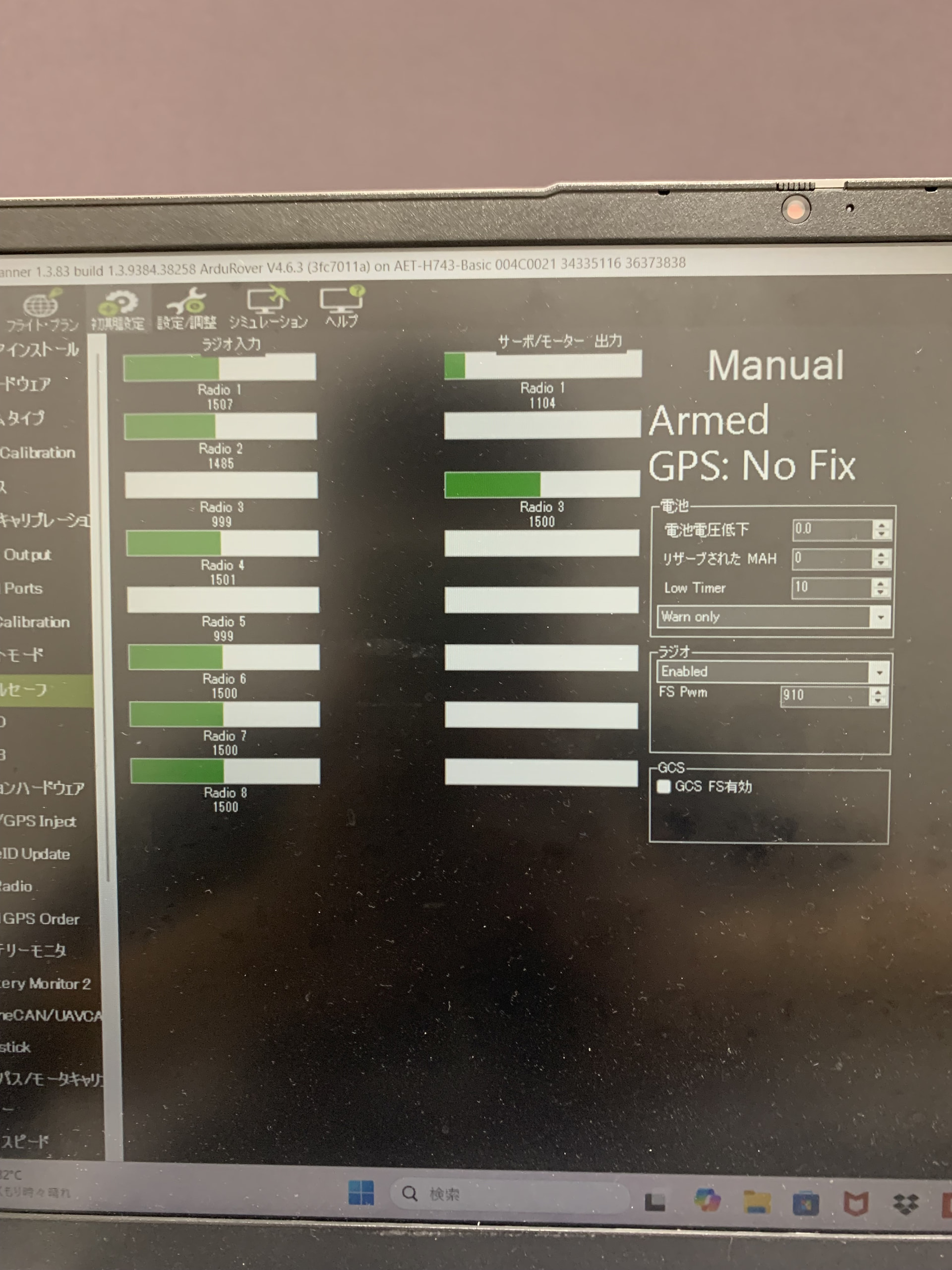

The channel is right, but it doesn't work
If you move left and right, the right side will react, but if you use the control on the left, the drone will not move at all and will remain stationary without moving forward. Please don’t move from the back and the front, please lend me your help.
Which channel moves?
チャンネル1が動く
チャネル3はグラフでは動いているが実際のドローンの方では一切作動しない。チャネル1は実際での動く
Channel 3 only works if the drone is armed and correctly configured. Have you used ArduPilot methodic configurator software (available in Japanese) to correctly configure your vehicle?
Do you mean that you can understand the vehicle settings by looking at the URL you sent me? Is the flight controller I’m using the same with the AET H743?
No, I can not understand your vehicle settings unless you post a .param or a .bin file.
Can you post one?
Did you install the ArduPilot methodic configurator software on your PC?
Did you connect your flight controller to your PC using a USB cable and started the AMC software?
Did you followed it’s japanese instructions?
