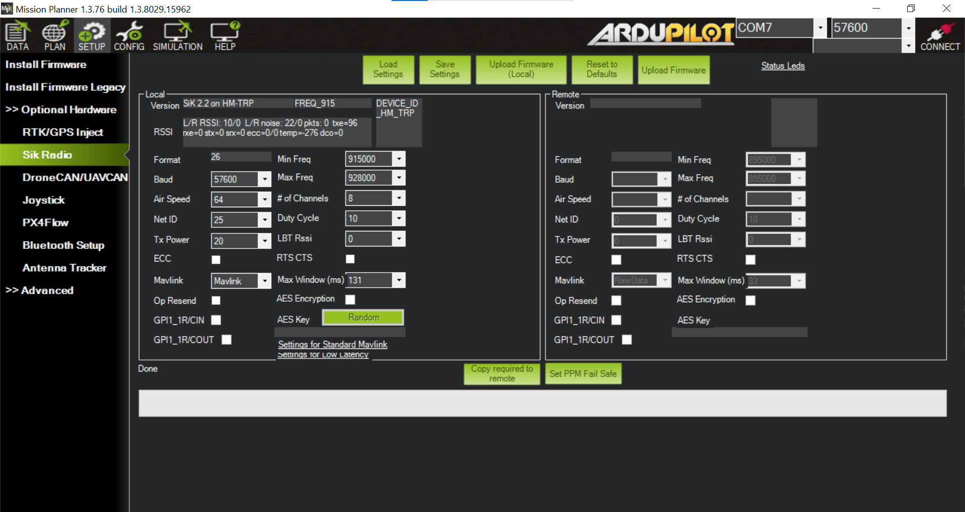

hello everyone. I’ve got two radio telemetry modules. The radio modules are interchangeable,any one can be used as ground or air module. I can individually connect them to mission planner and load the setting. The settings of both look to be the same. But they are not binding to each other. The green light on both modules keeps on blinking. My flight controller is Pixhawk .Any suggestion or help is much appreciated.

Thank you @Allister for replying, I loaded settings of both radios using MissionPlanner v1.3.76, what i did is to plug-in both radios one by one into laptop, and load their settings.

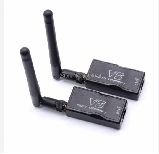

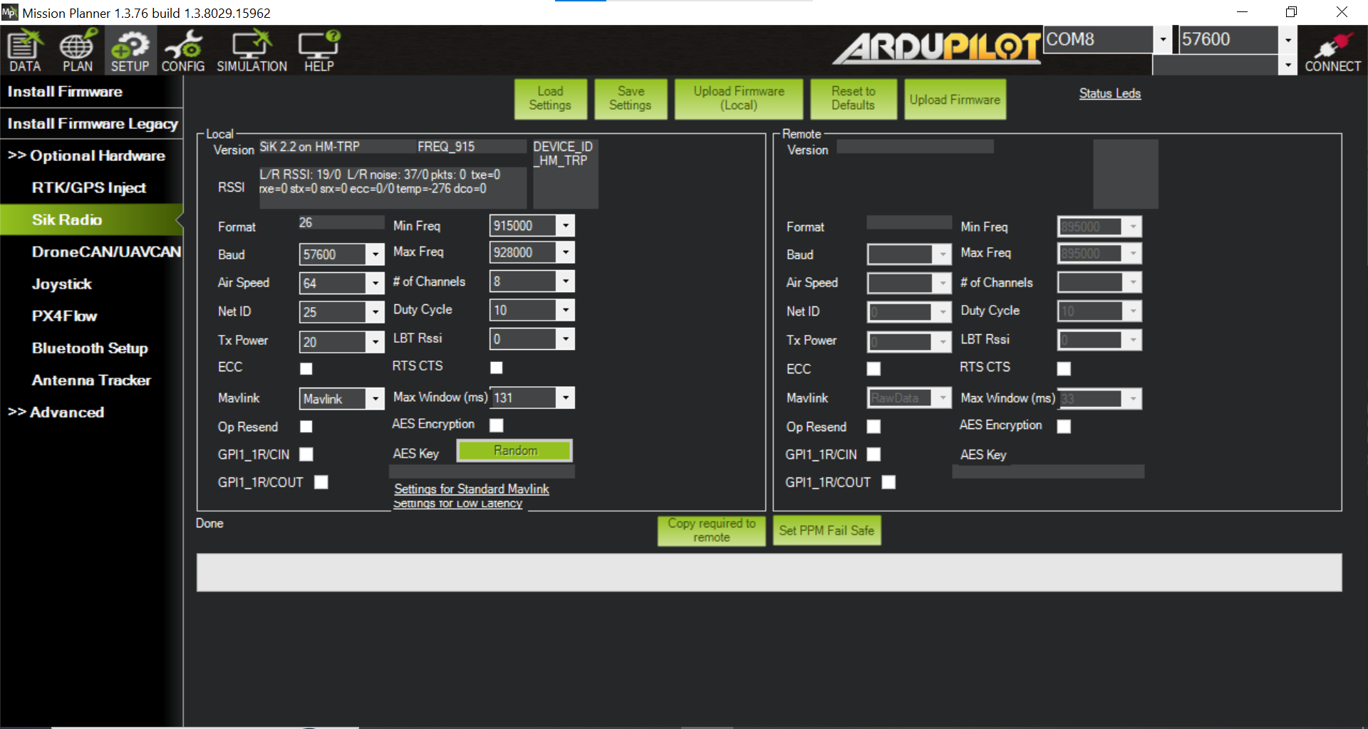

i also attach screenshots for both air and ground unit, as well as the radios that i am using. As shown in laptop, on COM8 i have ground unit, and on COM7 i have air unit settings.
Why such an old version of Mission Planner? Update to latest, then select the com port the radio is connected to the ground station on. Don’t connect, go to the Sik Radio setting page and press the Load Settings button. See if both sides populate.
@dkemxr i have also tried it on Mission Planner v1.3.83. Infact i first tried on MP v1.3.83, when i connect one of the radios to my laptop and other is connected to drone, and i click on load settings, both sides DON’T populate. Only local fields get popuated

Those settings look like the defaults, and that’s good. They should work on that. They look like knock-off radios and those a famous for being junk. Not really sure there’s much to do but see if you can get your money back.
which Sik radios i should use?
can you kindly share details or pic of them? @Allister
Radios from 3DR (Mro) and HolyBro are good. These radios are in the ~$75 range so if you find something selling for $25 or so they will be junk. A lot of Radios claiming 500mw will be junk. There are a couple posts about the Micoair telemetry modules but I have no experience with them.
