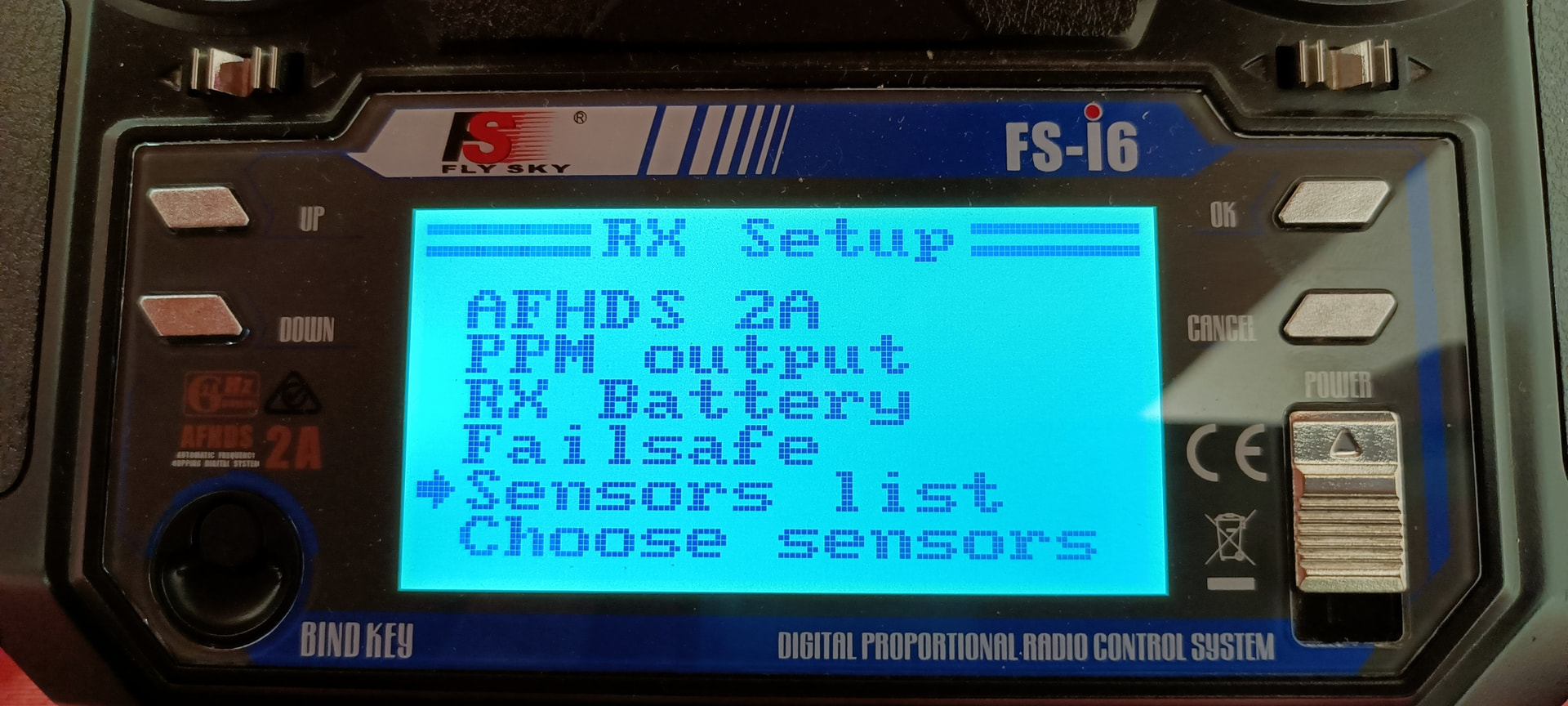

So, i was very happy with my fs i6 and ia6b receiver, until this documentation came in life:
In this, they clearly say that i-bus telemetry is possible in fs i6 transmitter too!
So, i connected a jumper wire from Kakute H7 wing’s T7 (Serial 1, telem1) to the ia6b’s i-bus signal port.
Then i adjusted some parameters as told in the documentation:
”Set the following parameters for the telemetry port used:
  • SERIALx_PROTOCOL = 49
  • SERIALx_OPTIONS = 0 / cleared as the library will set its own options
SERIALX_BAUD doesn’t matter as the library will set its own baud”
And then i rebooted and went to the transmitter to configure for it.

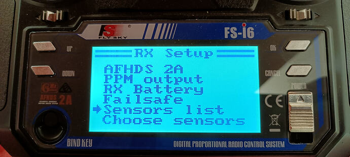

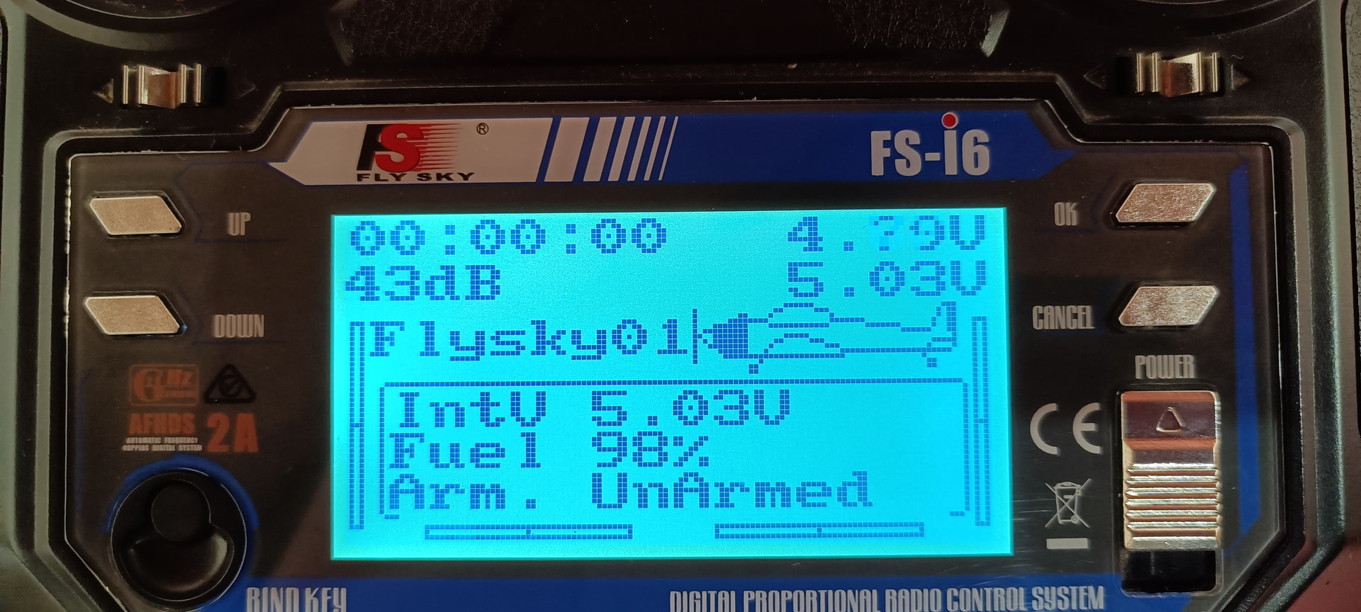

But when i saw in the “RX setup: Sensor list”, Only the default 3 sensors got displayed there?
but docs say first 15 will get displayed, and on the home screen, only a few (in my case, 3) can be displayed:

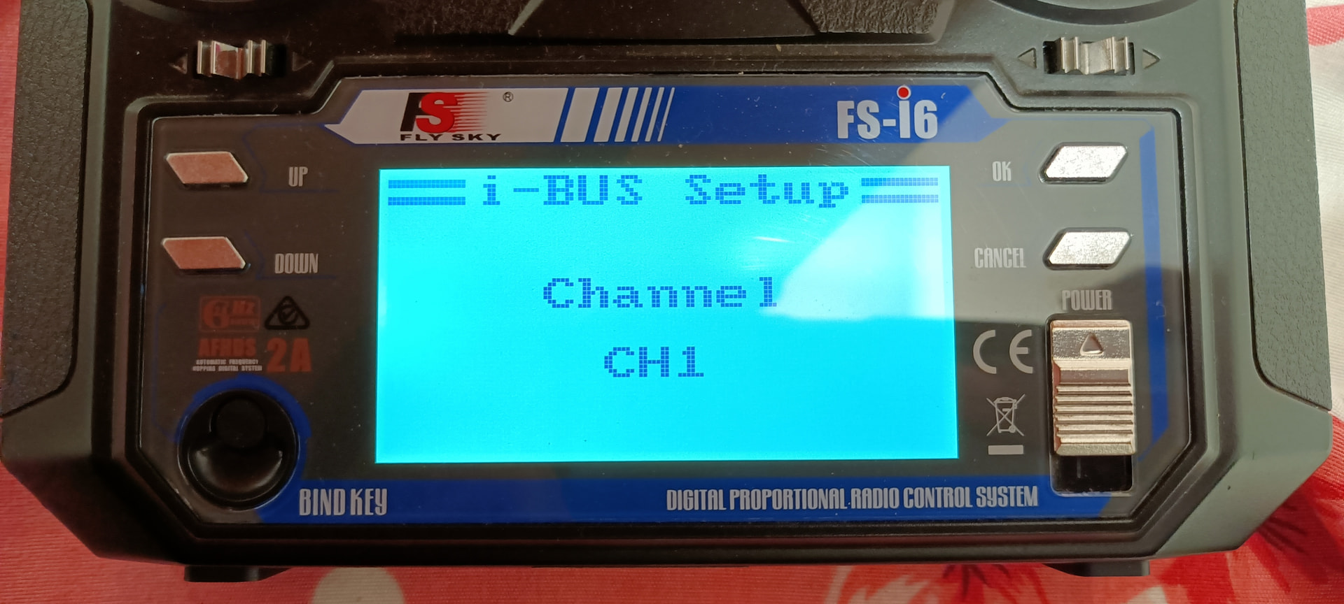

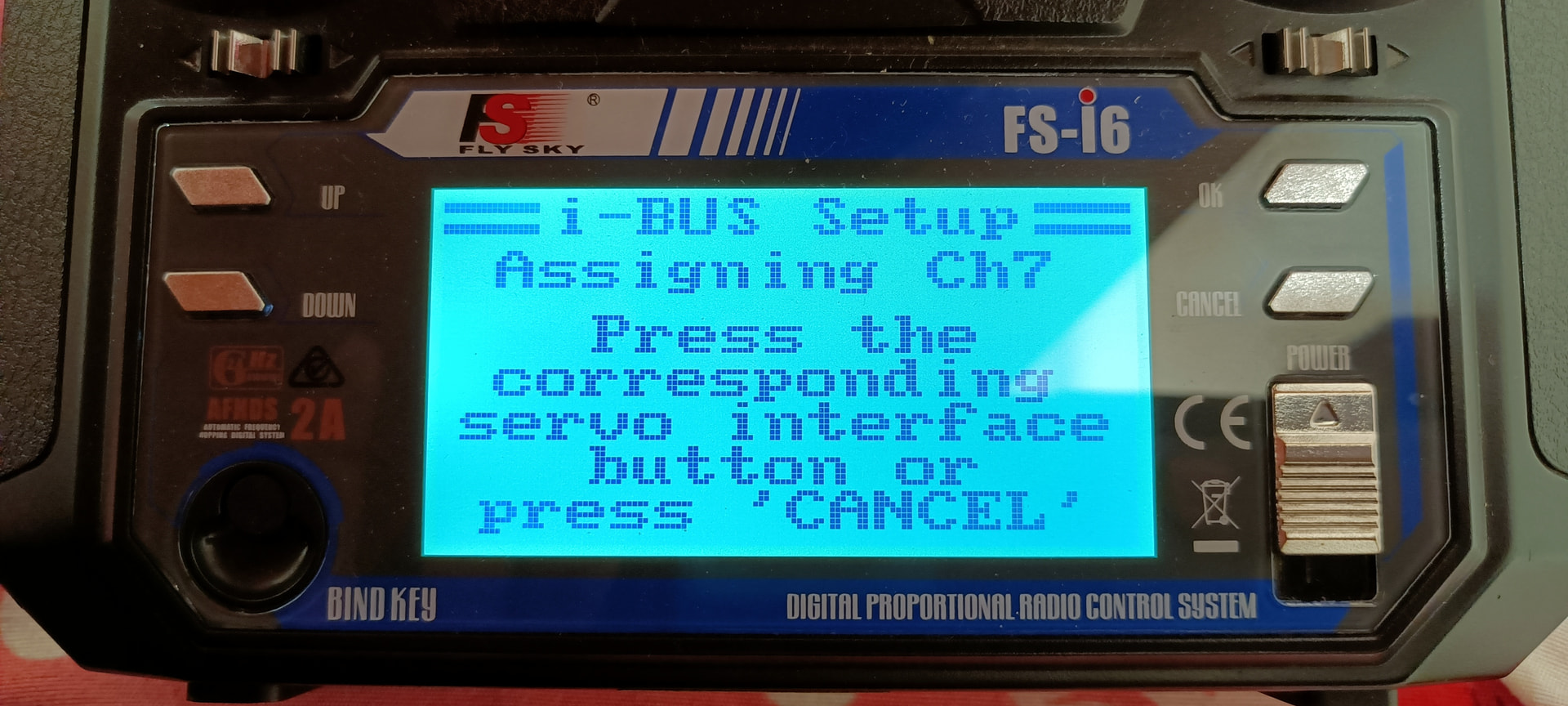

I also went to this “i-bus setup” there. but…
Its asking some kind of channel here. And i really dont understand, what to set here? =>
I tried setting a channel 7 over there, but then it says this:
And i dont understand which button is he saying me to press!? i tried moving the switch A which is assigned to ch7, but nothing happens?

Use the Custom Firmware Builder and enable i-bus telemetry for that board and then flash the flight controller. It’s not enabled by default as you will see.
Before asking any questions go to the Wiki and read it Custom Firmware Builder
And don’t assign any channels, you are on the wrong track there.
Wow sir!
This was a totally new experience for me ! I read that doc given, created a new firmware build with i-bus Telemetry enabled (Yes! It was disabled previously as you said) and then i flashed that .apj file to the Kakute.

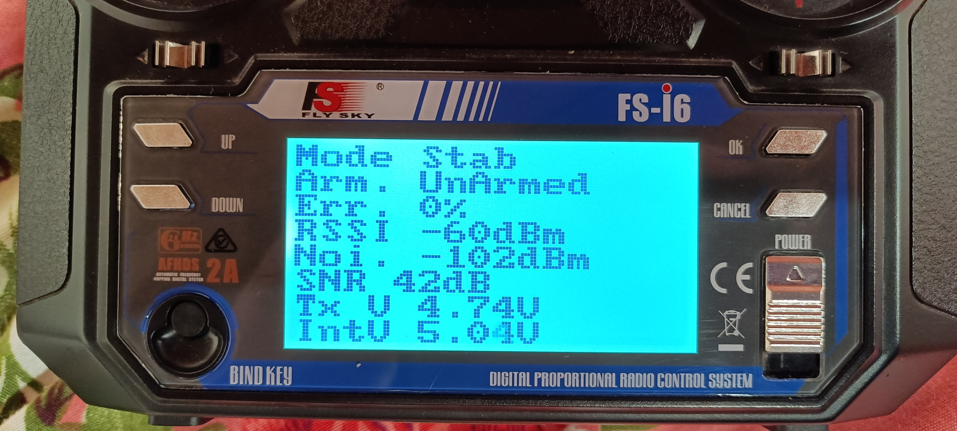

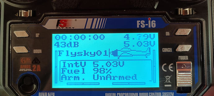

This New firmware enables us to get all the Telemetry data (supports 2 and 4 byte sensors, and can handle upto 28 byte long Telemetry frames!) Directly at the home screen of fs i6, along with the RSSI too!
And 3-4 more pages of lists like this too

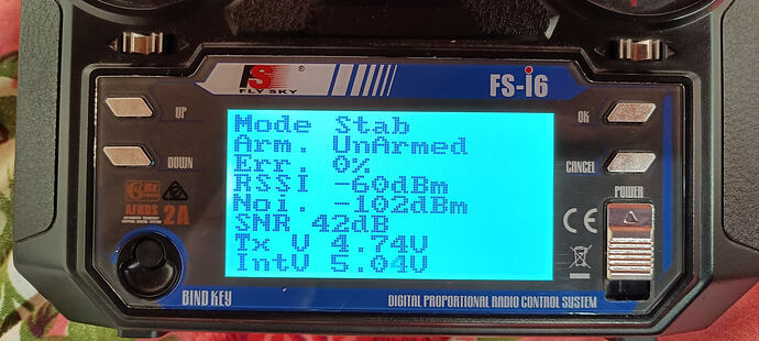

Now, the only problem which lies here, is the Continuous Altitude reset happening on Telemetry altitude.
That is, On the transmitter, The “Alt: “ field is continuously rapidly changing to 0 like: 0.00 to 0.19 to 0.00 to 0.24 to 0.00 to 0.12…
As if, The altitude value is getting set to 0 everytime a new correct altitude reading comes in?!?
Why is such happening?

At that time of writing above post, The drone was not ready to arm. But after continuously working on it, I made it ready to arm. I armed it, And still the transmitter altitude shows correct values for even less than 0.4 seconds and then again shows 0.00, then again correct values comes, then again reset to 0.00.
Why is this happening even after arming ? And for altitude, I have the on board baro, and Micro M10 GNSS also connected.
These all fields are also either showing a fix 0 or are simply blank:
Latitude, Longitude, GAlt, Head, CoG, Cell, Curr, AccX, AccY, AccZ, VSpe, MxAl, some S85 to S90 fields also.
But some of the fields really give accurate data. What is happening and where can i fix it?
I suspect the ibus telemetry implementation on ardupilot predates all the new functions. So it only has the original ivus telemetry values.
But then why are all of these values getting displayed very properly?=>
Arm status:, Flight mode:, GPS status, Distance to home, Drone bat Volt, Drone MCU Temp, Fuel%, Roll, Pitch, Yaw, Rate of Climb, RPM, GPS Speed.
All these above fields show corect values.
I don’t know why but i am having a feel that it’s a Transmitter’s firmware bug. I think it’s mixing the values of “Alt: “ and “GAlt: “ field, In which drone updates GAlt always to 0 m and updates the Alt with correct baro altitude. That’s why It shows correct Baro Alt but soon it changes to 0 ?
I think you might be correct, Its been about 10 years since I last used ibus telemetry and it was on another flight controller firmware. It seems there are a lot of “if’s” for what values you will receive :
