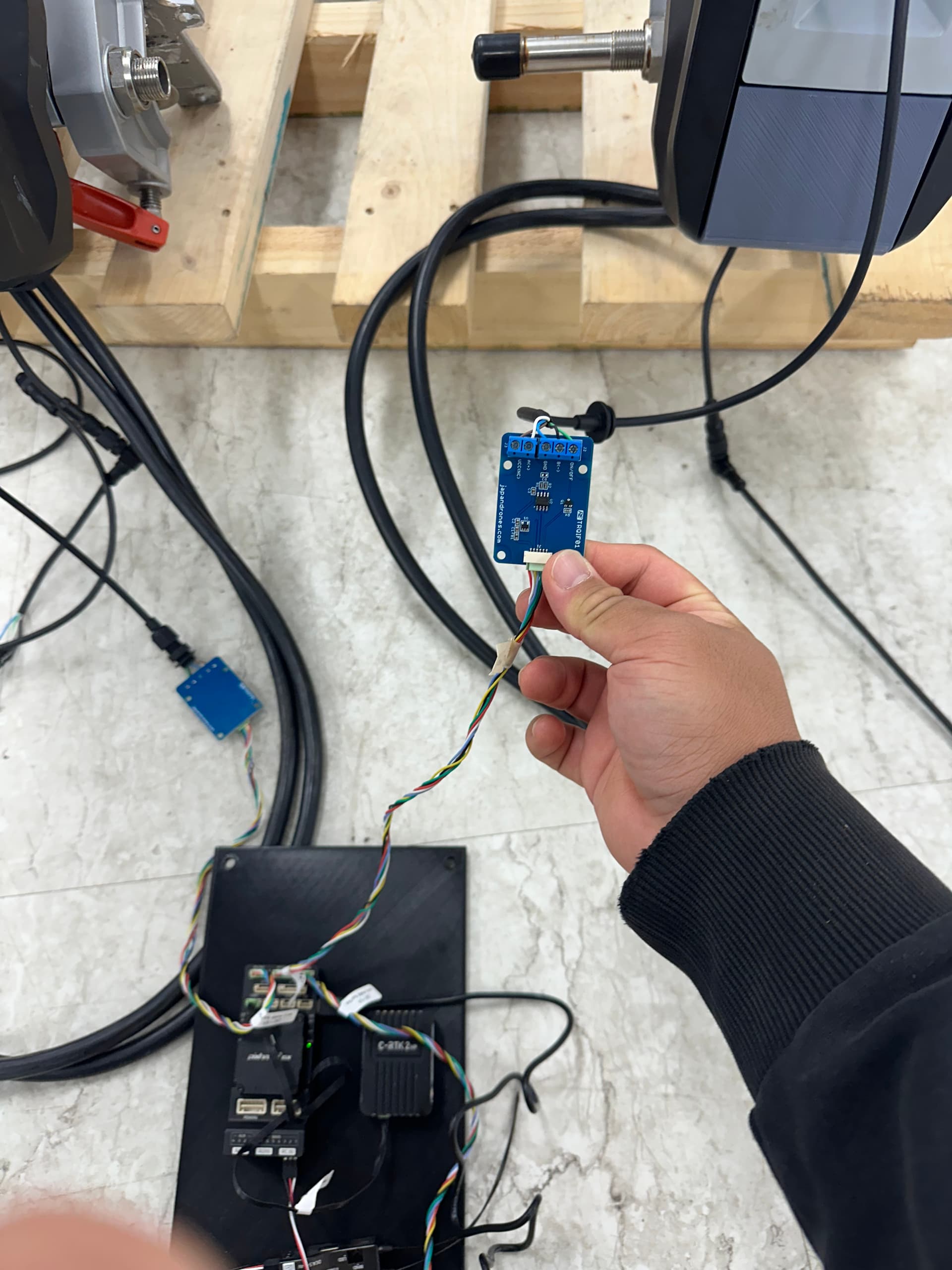

ArduRover 4.6 introduced the very nice feature of controlling two Torqeedo motors, so I decided to give it a try. Unfortunately I can arm the vehicle, but the motors do not respond to RC throttle at all.
Hardware
Holybro Pixhawk 6X (Standard)
2 × Torqeedo Cruise 3.0
Torqeedo 24 V 3500 Wh
I plug the Tiller connector of each Cruise motor into a Japan Drones RS-485 converter board. The converter’s UART is connected to the Pixhawk TELEM port.
![IMG_4720|375x500, 50%]
(upload://ysvPaX4KIRqZmdUfvxkyweyKn6P.jpeg)

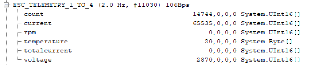

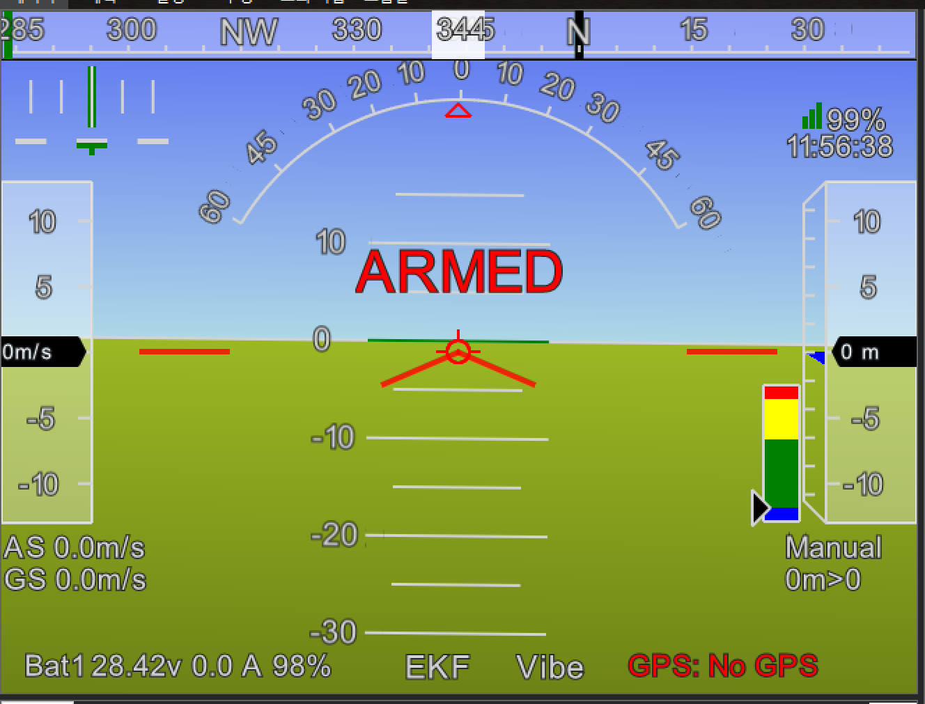

Pixhawk arms without any error messages. When I raise the RC throttle stick, neither motor reacts. ESC / RPM / current values in ESC_TELEMETRY_1_TO_4 dont change.
Addition photo

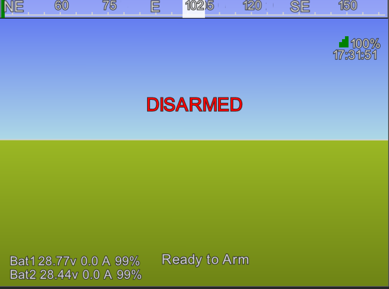

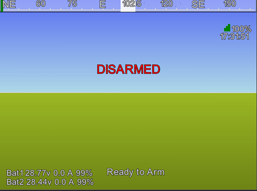

Screenshot of the Mission-Planner status messages

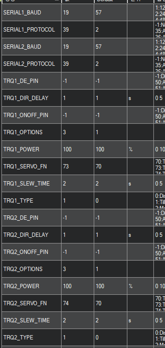

Screenshot of all parameters I have set
Can anyone spot what I am doing wrong, or suggest things to check next?

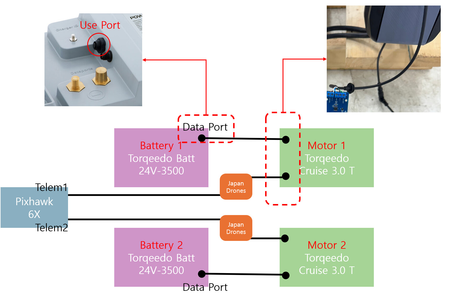

I am attempting to restart my project using ArduPilot Rover to connect two Torqeedo Cruise 3.0 Tiller motors.
I am currently experiencing a similar but different issue and would like to ask for some help.
Problem

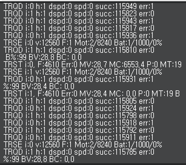

Communication is functioning correctly, but the motors are not working.

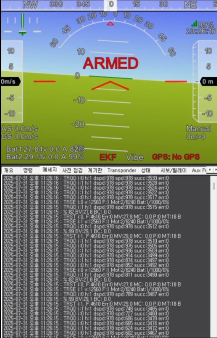

As shown in the picture, communication appears to be normal, and it seems that throttle commands are being sent via the RC. However, the dspd value does not change even when I increase the throttle.
Questions
Why isn’t the dspd value changing?
Are my parameters configured incorrectly?
Is my hardware configured incorrectly?
My current system is configured as shown in the attached diagram. Could this hardware configuration be causing the problem?
Thank you for your help.
