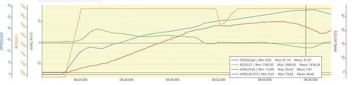

Here is some datas regarding last takeoff sequence

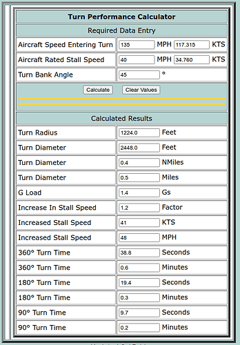

  • In order to take into account air speed and max bank angle impact on loitering:
ROLL_LIMIT_DEG = 45 (conservative value for maiden flight)
WP_RADIUS = 380 ( recommended value with 45° bank angle and 135MPH when entering turn)
Loitering Radius calculated using
Did i miss some relevent settings for such a speedy wing ?

The loiter radius is mathematically correct. However, you must add the maximum wind speed at which you still want to fly. The center of the loiter circles is a fixed point that does not move with the wind (except in CIRCLE mode). On the arc above ground, you fly with the wind at almost airspeed + wind speed, and on the opposite side at airspeed - wind speed.

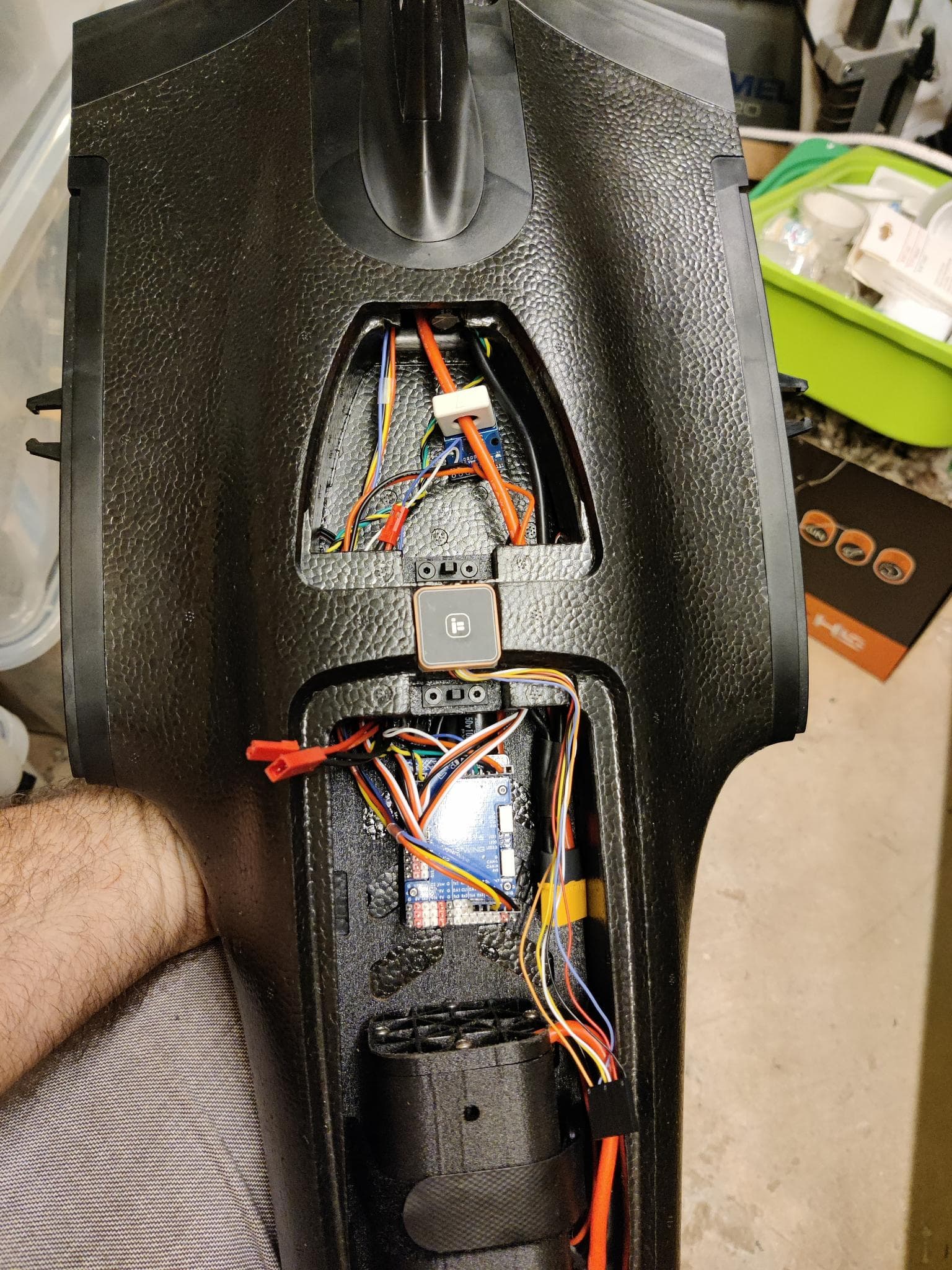

Regarding finding the best location that fit with TBS MOJITO, it is all about the battery size and weight… each build is very different. In my case, it did fit in the frame this way:
The main defect of this implementatio was the GPS+Compass location. I did it a quick and dirty way, but it was too close from other electronic component and too close from ESC power cable…

  1. Emit a alert message to the pilot like : [GROUND/AIR]SPEED ABOVE MAX AIRSPEED, SLOW DOWN TO <AIRSPEED_MAX>
    The idea behind this feature is to notify pilot while flying that loss of control may occur due to speed scaling affecting servo gains.
    Notification may occurs when ground speed (or airspeed if available) is 25% (TBD) above AIRSPEED_MAX
    Another benefit would be to leave a message in bin logs order to ease post processing and highlight the misconfiguration on AIRSPEED_MAX. It would have save me from crashing…
