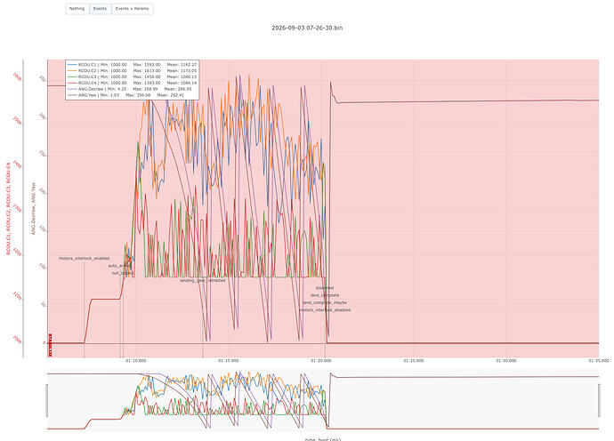

Back home, I ran a motor test. All motors will start running at 6% power except #4 which requires 7%. I don’t know if this is a problem or not. My log can be found here.
Also, here is a video of the motor test: Click here.

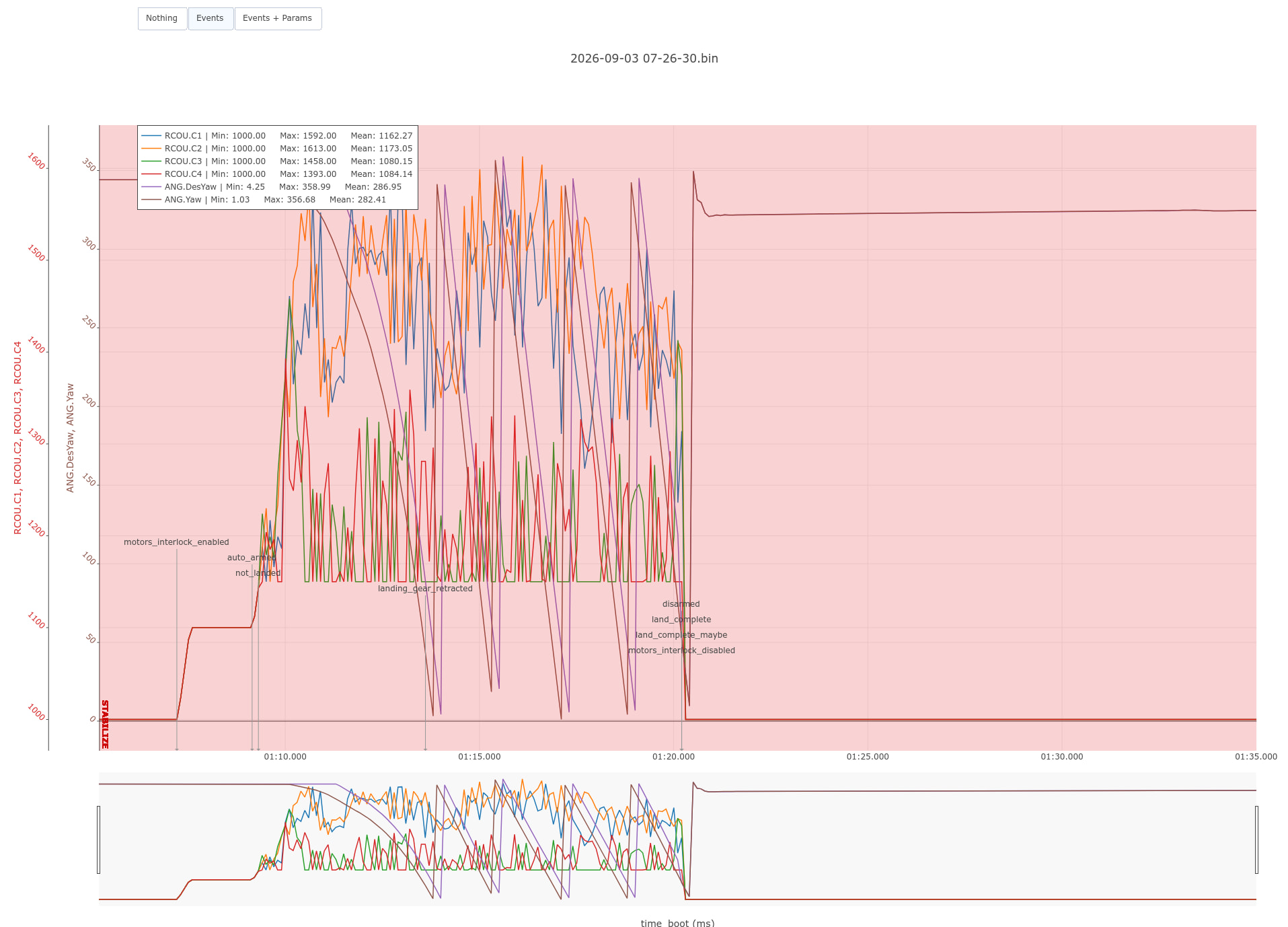

I believe this is the classic yaw imbalance due to motor misalignment on round tubes. Based on the log, this has nothing to do with the landing gear, yaw started to drift immediately after lift-off. Clockwise motors 3 and 4 cannot be made smaller than min RPM, so the machine cannot keep yaw and altitude at the same time.
What @MaxBuzz identified is the major problem and the tune on this craft is poor. Rate PID’s at default, MOT_SPIN_MIN at default and no Notch filter configuration are contributing factors. Looks like you missed some basic tuning steps.

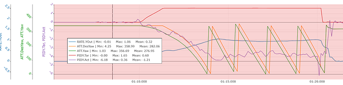

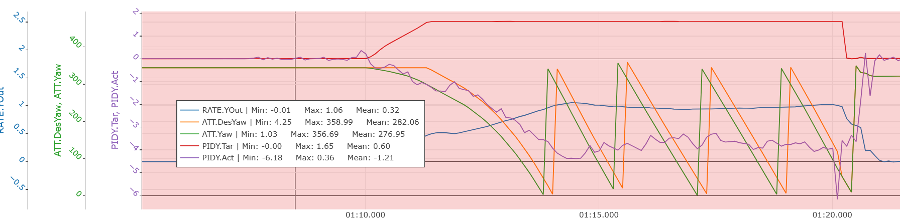

That’s easy to see with RATE.YOut, it’s fully saturated (close to 1) while still not enough to keep yaw steady.
But I’m not 100% sure about it, are the props rotates in correct direction (target have other sign than actual)?
