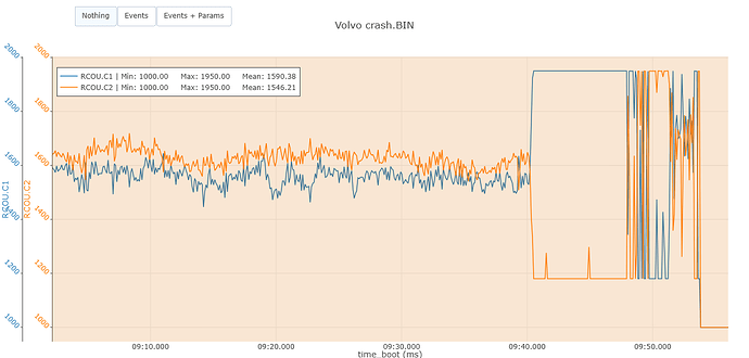

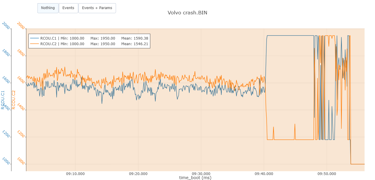

Hi All, what might be the reason for this crash? It was a tarot 690 with TMotor MN4006 KV380 paired with EMAX bullet series 35A ESC. It was on a BVLOS mission of 100m altitude during crash. I found that PWM of C1 motor raised to max while C2 motor dropped to minimum. I have attached the bin for your reference.
Thrust loss on Motor 1, Motor 2 dropped to stabilize and down it goes.

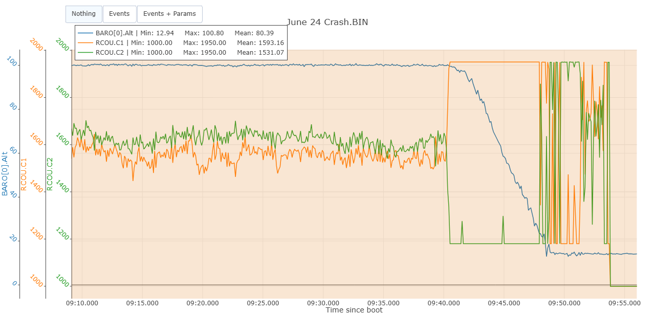

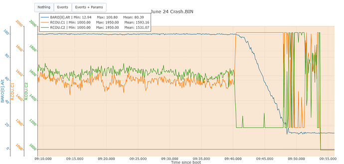

That’s easy to determine. Add Barometer altitude to the Rcout graph. Where was it when thrust was lost?
That answers your question. Thrust loss on Motor 1, Motor 2 dropped to stabilize and down it goes.
It was directly soldered to the ESC pads and no bullet connectors were used. To mention, motors came with a single core solid conductor. Even the soldering was good without any cold joint. The wire broke between the solder pad and the wire sleeve. We assume it may be due to cyclic fatigue. Have a look - https://www.youtube.com/shorts/uBWI4NnA7EQ
