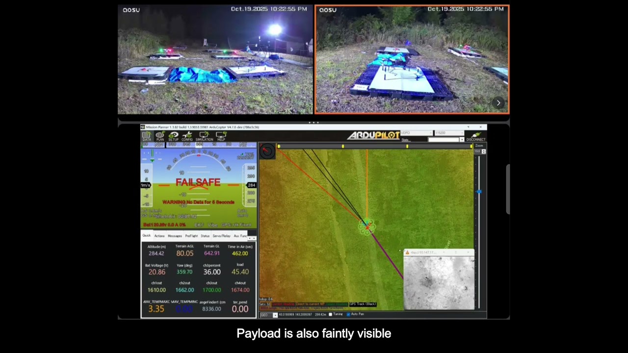

    a) live streaming video from the Siyi ZT6s on our search and delivery copters which made it even easier to find the mannequin quickly. Below is a screenshot from the 2nd day’s delivery attempt. We could see the mannequin (shown in red) and also see the payload (see green arrow) giving us confidence and potentially allowing us to manually adjust where the payload was placed.
