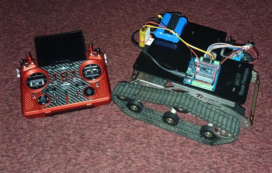

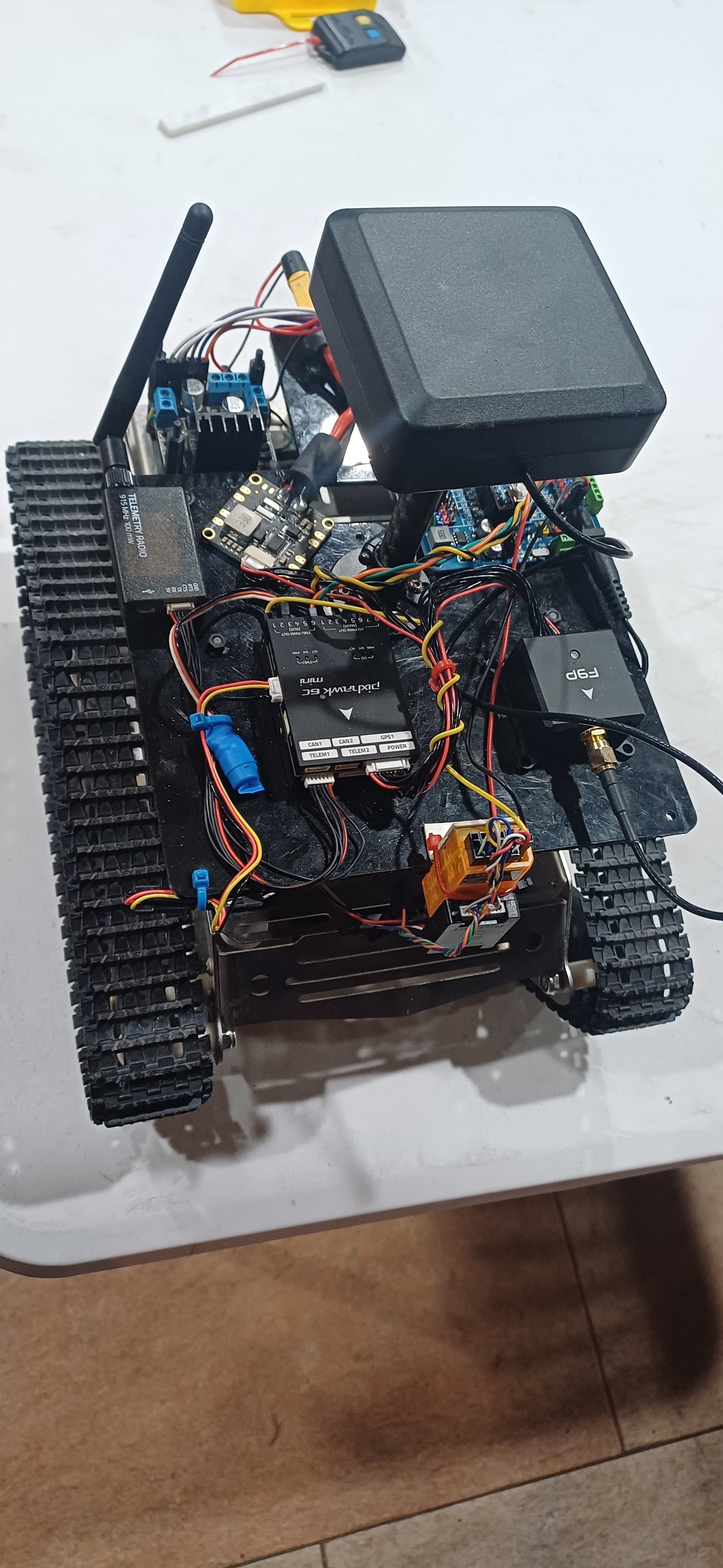

All Tests in my lab will be done on a tracked vehicle that I have in my Arduino arsenal. I have configured this prototype to respond exactly as does our AMD R120.

Testing will be near useless unless you use the autopilot on the smaller test vehicle as well.
Yes, absolutely! Test vehicle will be outfitted with everything i plan to use on the mower.

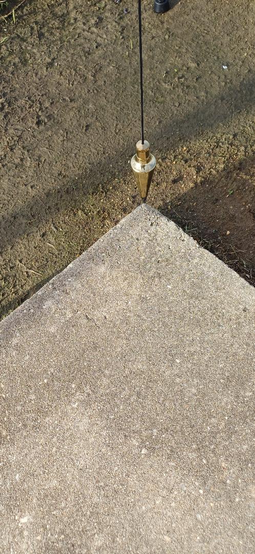

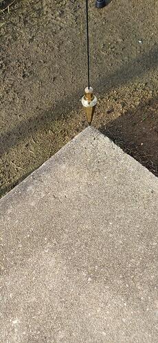

Some pics of our testing yesterday. Went quite well, a few bugs and challenges to work out, but here are a few pics:

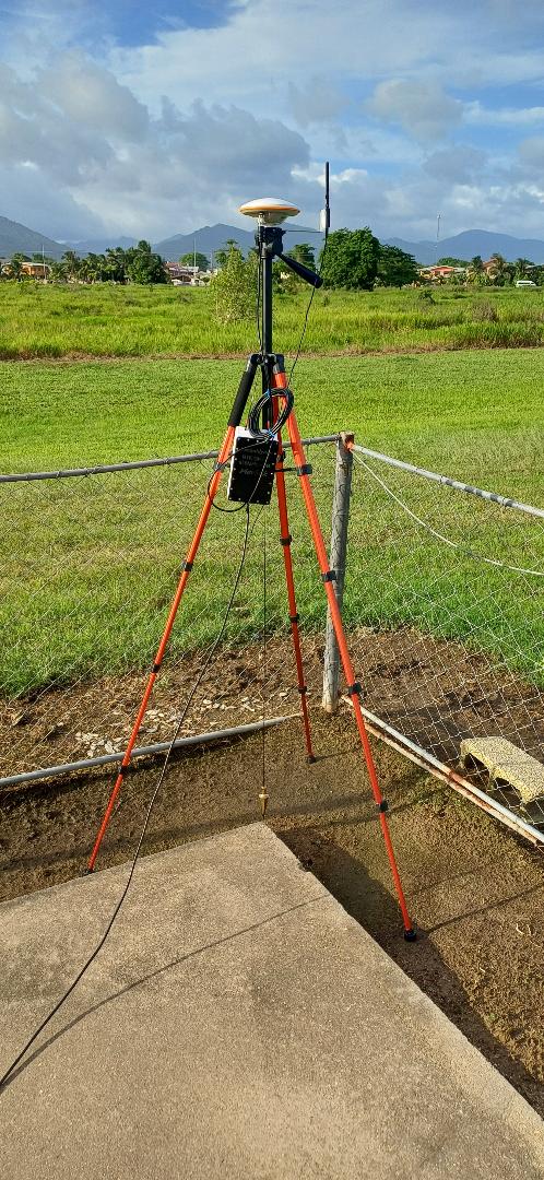

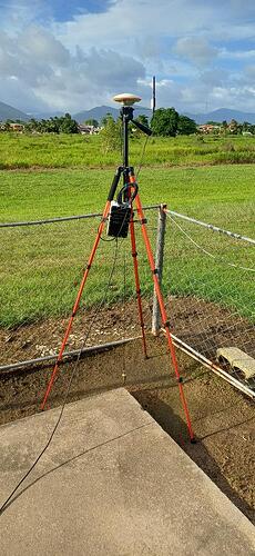

We established our reference location at the field
Lat 10.66110117 Lon -61.4014045

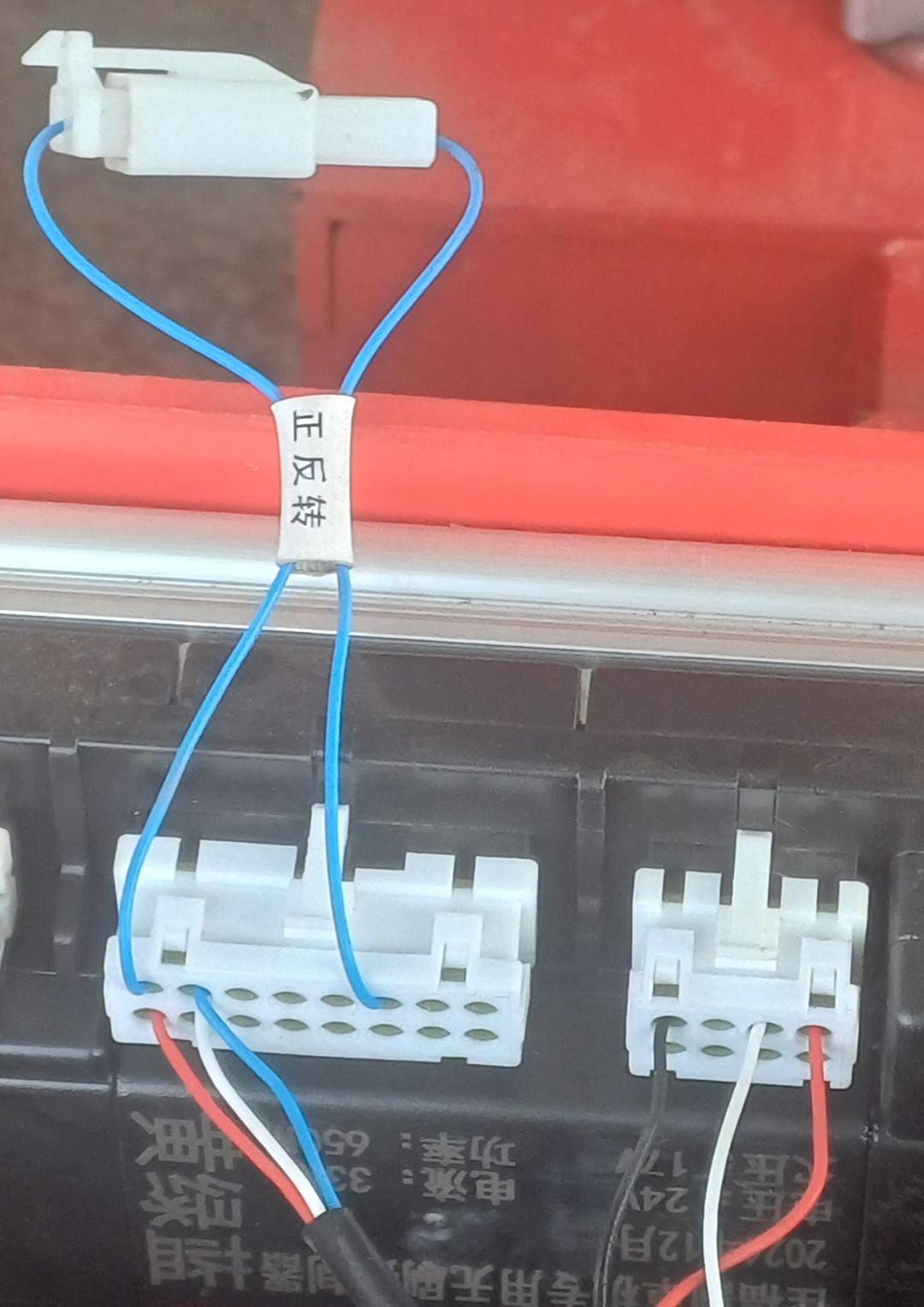

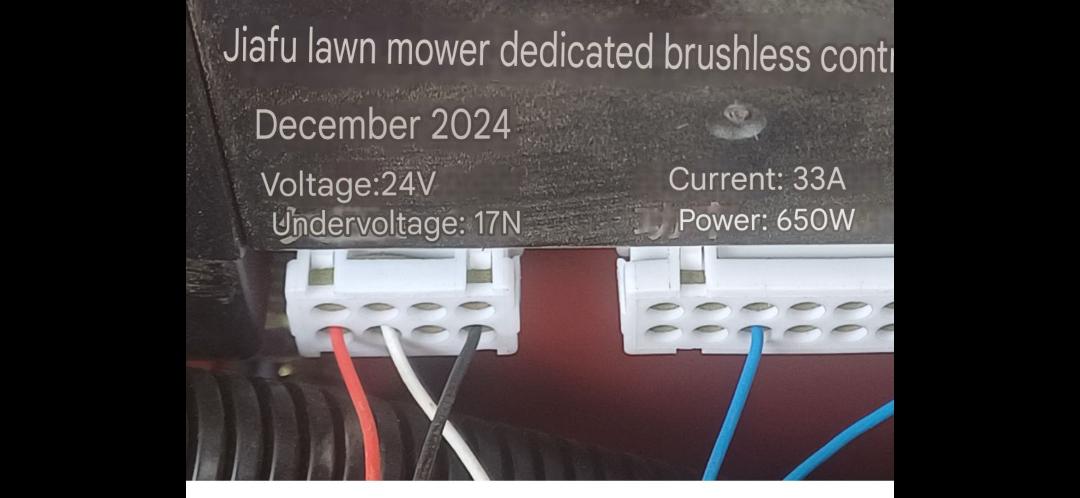

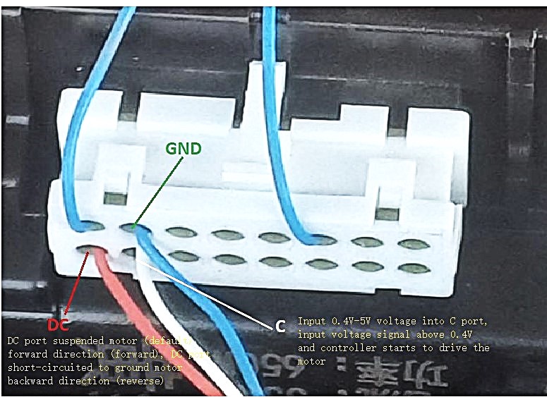

Any assistance finding the pinouts for these two connectors, would be greatly appreciated. I suspect it’s a typical e-bike BLDC controller, but all the pinouts I can find show the harness end, not the connector pinouts.
The chinese translation for the markings on the box says very little:

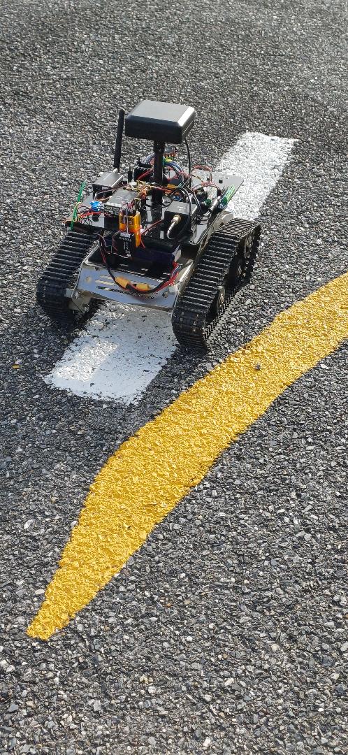

Did some basic waypoints and RTL on our runway yesterday. Went well, but as expected a few bugs to iron out.

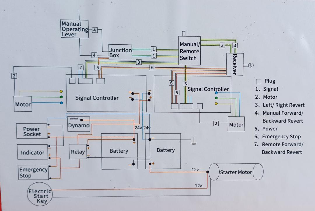

Chinese Salesperson and factory engineer came through and I got all the pinout and board layout info I need to proceed. Going with native Pixhawk skid-steer control, a 4PDT slide switch will be implemented to easily revert the mower to original configuration. A bunch of safety features will be implemented as well, including a dedicated 433Mhz “kill-switch” transmission link.
After Google Chinese to English Translation:
AMD_R120 ESC Pinout.pdf (96.7 KB)
Schematic as supplied with the AMD R120 Flail Mower
A serious concern is the automation hardware needs to be readily removable/deployable as we have had issues of theft/vandalism over the years. That being a given everything is being built as a quick disconnect plug-n-play system and a simple switch and connector is being considered for interfacing the automation/FPV rig and reverting it to normal RC operation.
So I think this solves my plug-n-play situation. A 4PDT switch toggles the system between Original configuration and Autonomous and a multi-contact aircraft style connector makes the system Plug n play. The hardware easily aligns and affixes mechanically to the roll-cage on the machine.:

Their BLDC motor controller:

I don’t get it. The BLDC ESC I’m using needs 0 - 5V with center as 0V, it also needs a Logic LOW sent to a pin, when the stick is “pulled back” in order to initiate reverse.
Please clarify?
Only way I know to do that is write some code. There’s no mixing, the tracks run independently (seperate channels) and the mixing is native to pixhawk/mission planner, not in my code.
