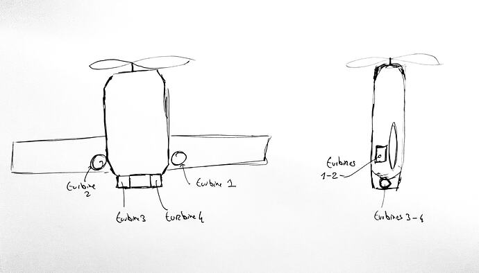

Hello Ardupilot community,
I am a beginner with Ardupilot.
I am developing a tailsitter with the following configuration:
> 1 front propeller
During vertical take-off
turbines 1&2 : for torque control → to balance the torque induced by the propeller
turbines 3-4 : for yaw control
pitch control: with Elevon
During horizontal flight
turbines 1,2,3,4 are off, just propeller & elevon are active.
Landing:
Parachute
My question is about the best type of standard configuration I should use and how to adapt it to obtain my own configuration:
Best type of standard configuration I should use:
I started with a Tailsitter Plane, the basic configuration. It feels natural but maybe a more experienced person will recommend something else ?
How to adapt it to obtain my own configuration:
I need to add turbines 1,2,3,4 and make the controller understand that during vertical take off, it has to use them to control the airplane. Do I have to adapt the code of the firmware and make my own ?
if yes how ?
Any help is really welcome !
Thank you very much !
