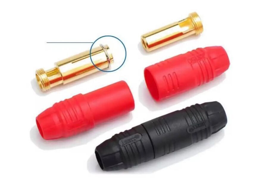

what about AS150 7mm Connector system with anti spark. and
or something like this would help ?

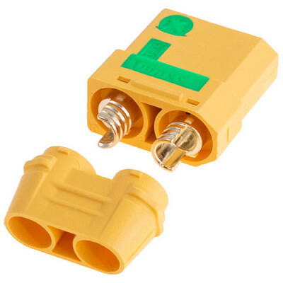

You can use antispark xt90s, they have resistor built in.
Or AS150 anti spark version
