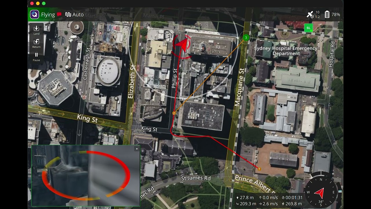

**How it started — a backup camera that got ideas above its station**
This whole thing began as a virtual camera for QGroundControl. I wanted a synthetic 3D view rendered from cached Google 3D Tiles — basically a “what the drone sees” window in the GCS using the mesh data downloaded. Just a nice-to-have backup perspective for situational awareness, night flying or fog flying.
Then one evening it hit me: if I can render the 3D world from the drone’s point of view, I can cast rays into it. And if I can cast rays, I can generate OBSTACLE_DISTANCE messages. And if I can do that… I can feed BendyRuler.
So that’s what I did. Probably should have thought harder about whether I *should* before I figured out that I *could*.
**What it actually is**
**Balliyang** (Bat in Wiradjuri tradition) is a QGroundControl custom build plugin that:
  1. Downloads and caches Google 3D Tiles for any area, or you can add your own mesh
  2. Renders them in an offscreen OpenGL context
  3. Casts 36 rays at 4Hz across multiple pitch layers (level, ±30°, ±60°) from the drone’s position through the cached mesh
  4. Sends the results as MAVLink OBSTACLE_DISTANCE messages back to the flight controller
  5. ArduPilot’s BendyRuler then uses this data for path planning
The virtual camera feed shows up as a small 3D window in the fly view, and there’s a elliptical proximity HUD overlaid on it.
Pros:
  • Runs on the flight controller — no companion computer dependency, no single point of failure, no expensive heavy Lidar.
  • a great way to tune behavior for real lidar without risking it.
  • Works in AUTO, GUIDED, and STABILISED/LOITER modes
  • Pre-cached mesh means no internet required in flight
  • Lightweight — 36 rays at 4Hz is trivial compute
  • Uses standard MAVLink OBSTACLE_DISTANCE — no ArduPilot core changes needed
  • Works anywhere Google 3D Tiles has coverage (most cities worldwide) you can provide your own Mesh for wares it does not have.
  • Provides collision prevention even for manual flight
Cons:
  • Mesh is only as current as the last download — new construction or temporary obstacles won’t be there
  • Trees and vegetation are captured in the mesh but their shapes are approximate
  • This is NOT a replacement for real sensors — it’s a supplement for known, static, mapped obstacles

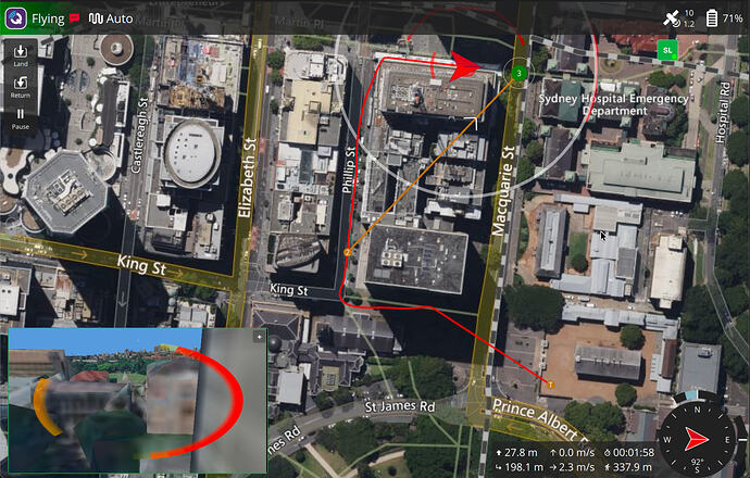

**The video**

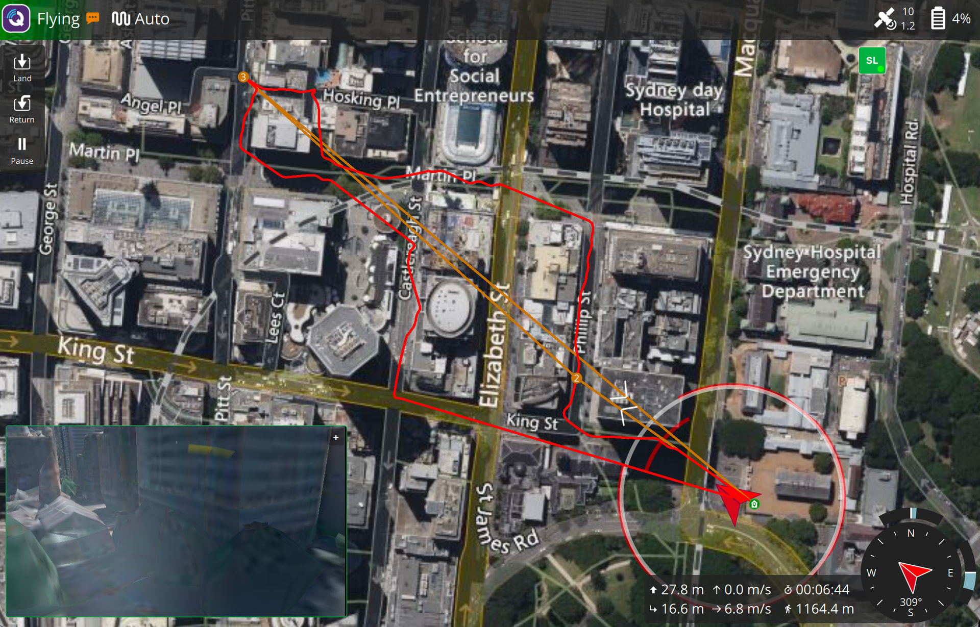

This is the drone navigating a mission through Sydney CBD — from Hyde Park through the streets around Macquarie Street to Sydney Hospital and back. Three waypoints through urban corridors. No manual intervention once the mission starts. It’s not perfect — you’ll see it hesitate at the first building approach and there’s some oscillation in tight spots — but it completes the route without hitting anything, which is more than I expected when I started this.

Some more progress, it now knows when it’s stuck in a corridor and can back out and find another way.

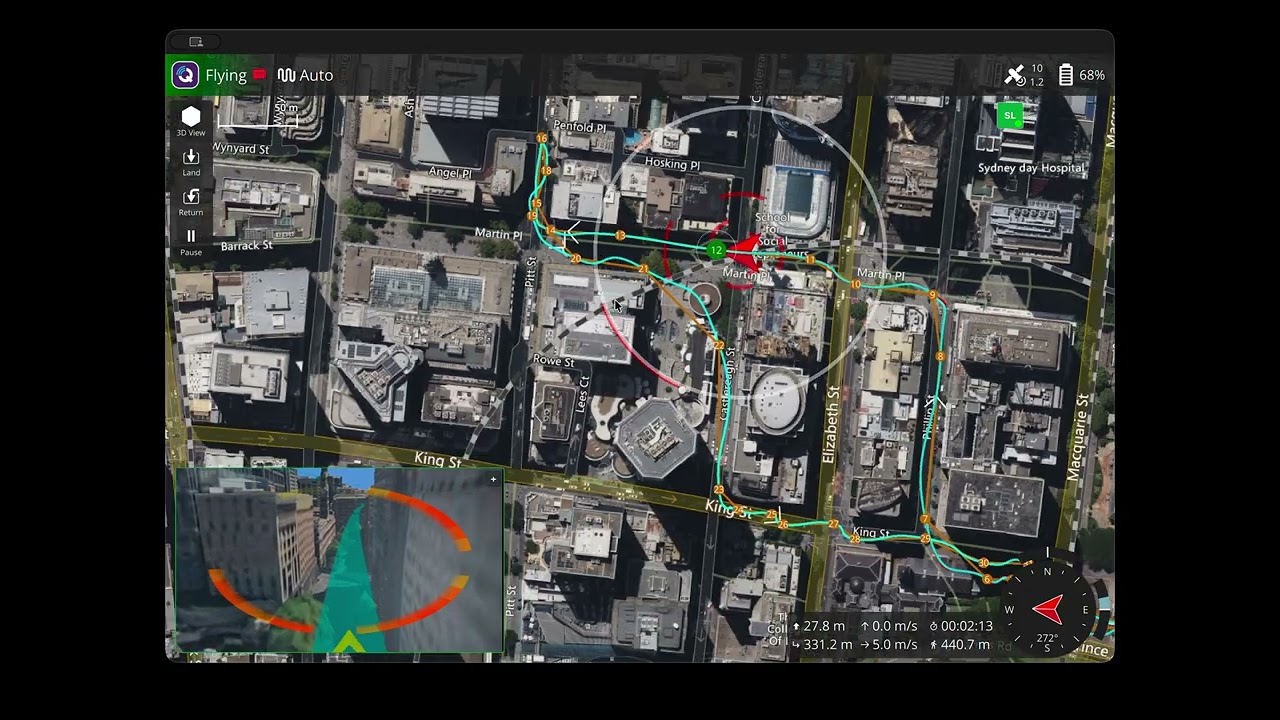

### 3D Path Planning in QGC
The big one. Balliyang now plans obstacle-avoiding paths through the cached 3D mesh and uploads them as spline waypoint missions — all automatically from inside QGC. I plan to make a Misstionplanner plugin at some point.
The workflow:
1. Load the 3D tiles (Google Photorealistic 3D Tiles, or your mesh)
2. Upload your mission
3. Synthetic LiDAR detects the mission, validates it against the mesh
4. If obstacles are in the way → plans around them using A* grid search with clearance-weighted corridors
5. Uploads the refined mission with `NAV_SPLINE_WAYPOINT` items
6. Drone flies smooth curves through the city
The path planner uses the same BVH ray-casting engine that drives the proximity scanner — proven, fast, no separate process needed. It runs on a background thread so QGC stays responsive.
The cyan path shows up in both the 3D world view (as a ribbon with direction chevrons) and on the 2D fly map.

### QGC Spline Curve Display
QGC shows straight lines between spline waypoints, even though ArduPilot flies smooth curves. Added a Catmull-Rom interpolation overlay to the fly map that shows the approximate spline curve. Small thing, but makes it much easier to see what the drone will actually fly.
**PR submitted**: [QGC #14433]( FlyView: display Catmull-Rom curve for spline waypoints by leonfliesthings-dev · Pull Request #14433 · mavlink/qgroundcontrol · GitHub )
