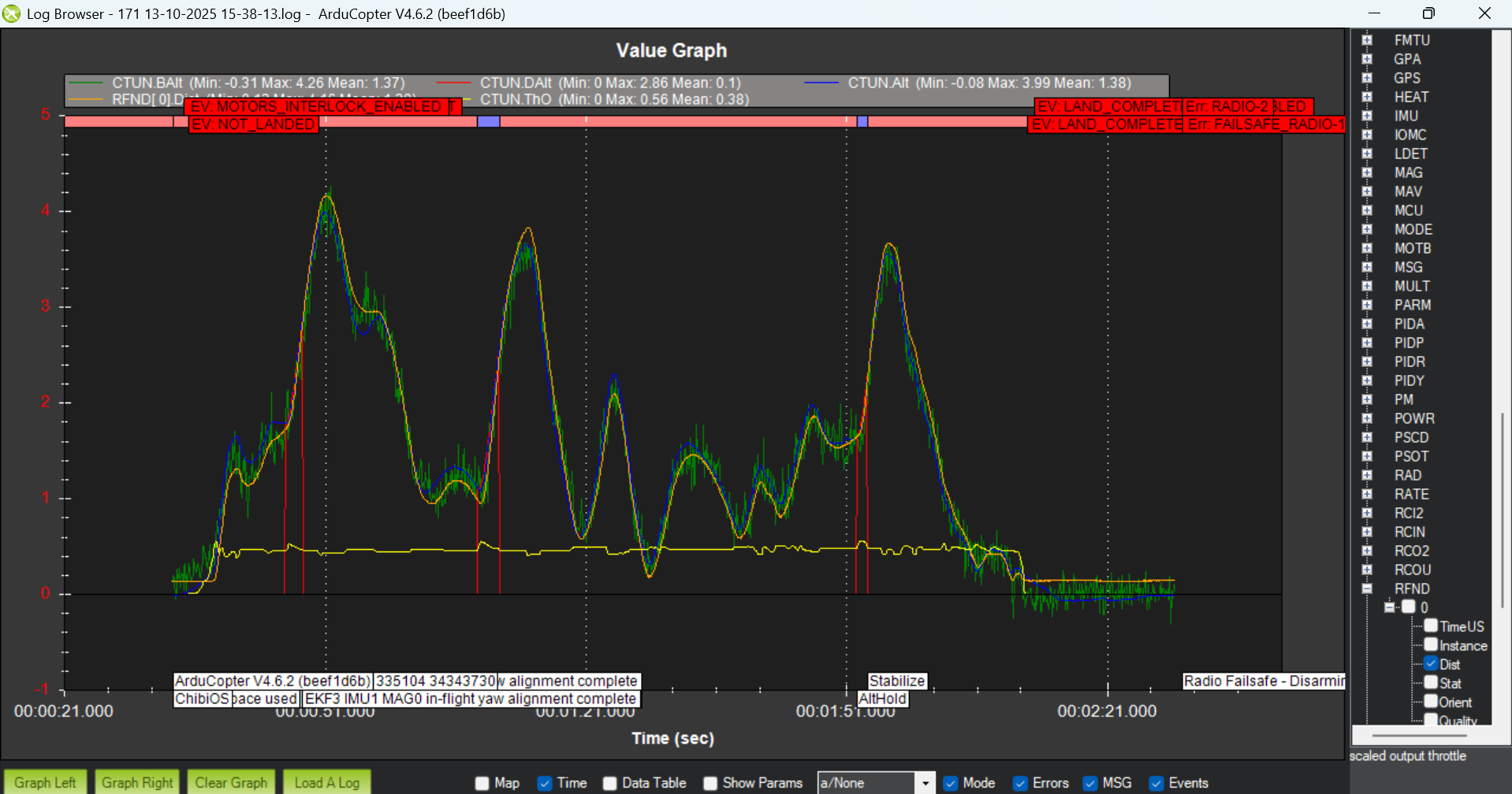

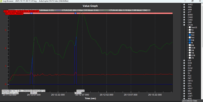

Switching to AutoHold results in abrupt and continous climb after flashing latest dev build

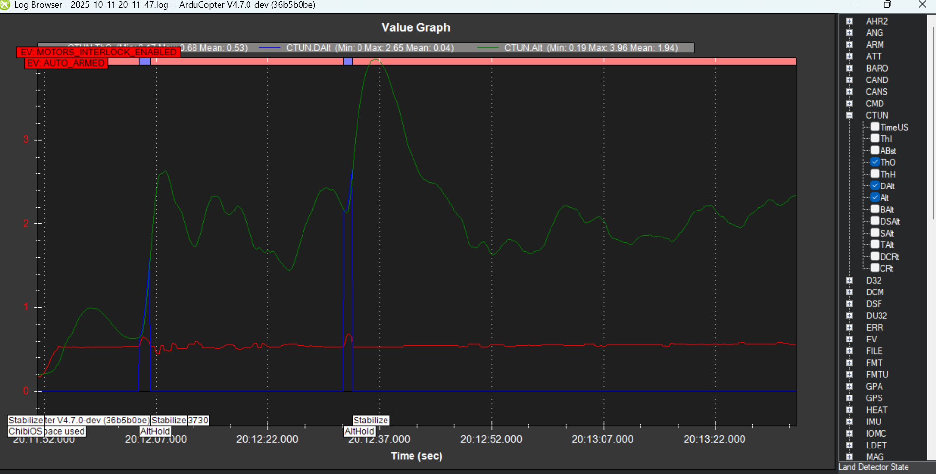

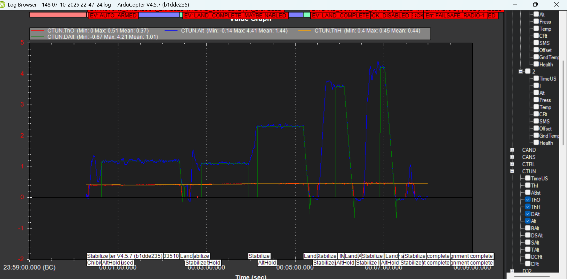

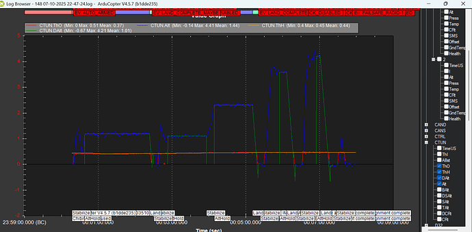

The following snapshot corresponds to stable Altmode switch in OctaQuad-X configuration with older build V4.5.7. Here CTUN’s alt and CTUN’s Balt are in line and CTUN’s DAlt switches to flying altitude the moment AltHold is enabled

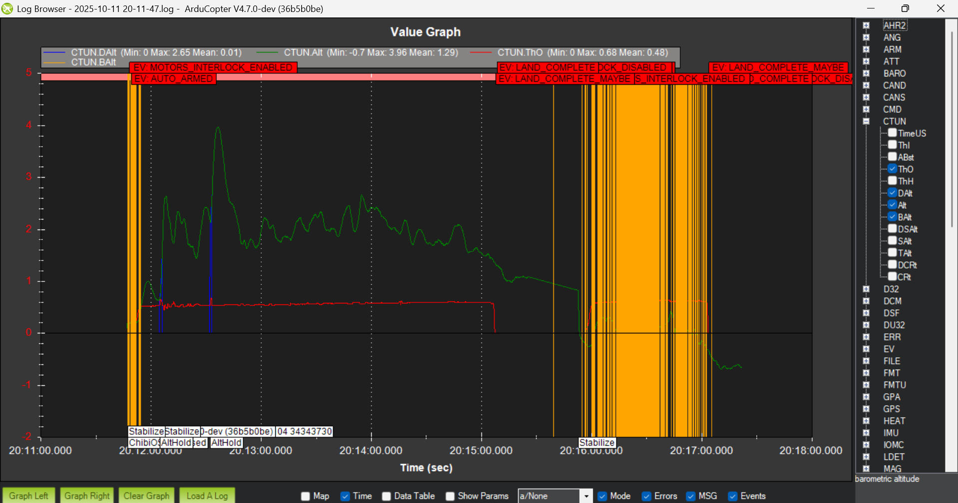

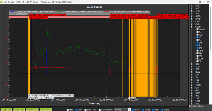

I recently took latest master (v4.7.0) changes and with that custom build AltMode is having issues.
There are three barometers. One external and 2 internal (Cube Orange). Barometer’s Alt is reporting within acceptable range
Whereas CTUN BAlt is 6 order of mangitude higher and when FlightMode is switched from Stablize to AltHold. DAlt is lineary increasing may to catch with with CTUN’s BAlt. What could be the issue. Also with this build have enabled TF02 RangeFinder and RPLidar A2M12 and hence Parameters changes related to enable and read relevant values have been changed. Can this Cause CTUN BAlt’s reading to be so high.
Even with unplugged range-finder and lidar CTUN’s BAlt is in the range of 10^6.
https://drive.google.com/file/d/1JN6zPUhqSaP3nNLSaVoJ0Xixqjlk7llw/view?usp=sharing Log file attached
You are using unstable development firmware somewhat blindly. Revert back to 4.6.2 stable and report back if problems persist.
I do not think it is a good idea to disable the Arming Checks at this stage and during operation.

The main reason i took is to have RPLIDAR A2M12 support which was added a few weeks back. will try to reproduce the issue in stable build

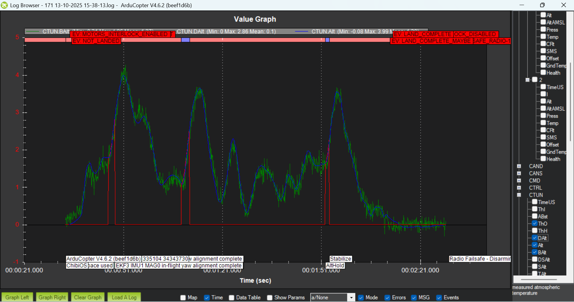

In Stable build 4.6.2 built locally. CTUN’s DAlt still raises when AltHold is enabled but CTUN’s BAlt now tracks that of Baro’s Alt. What could be the issue in configuration. Please note, have added TF02 RF with this setup.
Logs are at https://drive.google.com/file/d/1ufCmF1dJ3xxbHOZjmUG89KilI3WBeGeP/view?usp=sharing

Please note in build 4.5.7 Copter was flying stable in AltMode, PosHold
Even the newly added RangeFinder’s Distance to ground tracks well with that of Baro’s and THO is around 45% to 50%. So AltHold should work as it was working in my previous build.
What do I need to tune further?
