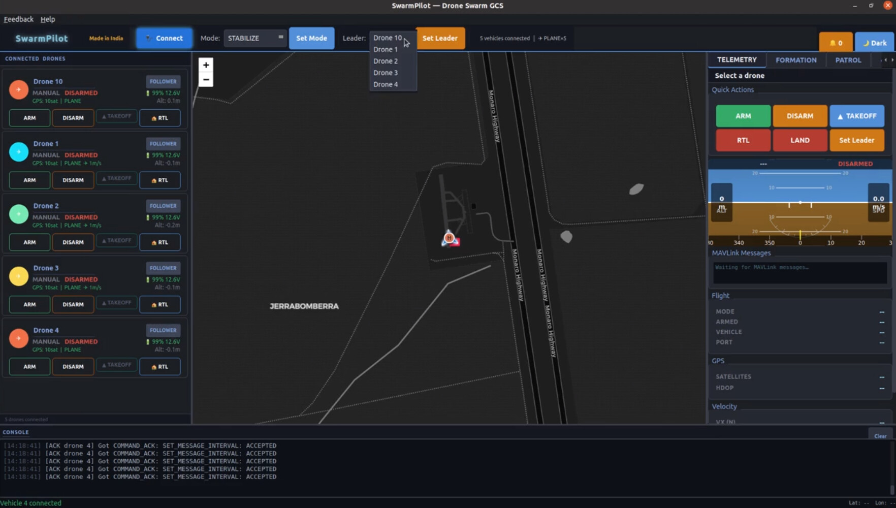

Hi everyone,
I’ve been working on SwarmPilot, a ground control system focused on simplifying multi-vehicle coordination using ArduPilot, and I’m excited to share v1.1.0.

→ Takeoff in guided.
→ Switch to “Swarm mode” with leader in Loiter.
→ Crash the leader with freefall since no radio
→ Followers dive on ground
–> Is fun once. Rm the app.
​Hi @khancyr
​Thank you for testing the application and sharing your feedback.
​In hindsight, the behavior you experienced is the intended logic outlined in the documentation: when a leader is assigned, the leader vehicle automatically switches to Loiter while the followers transition to Guided mode. The rationale behind forcing Loiter for the leader was to ensure the physical pilot retains manual positioning control during the operation.
However, I completely take your point. I realize that not every user will dive deep into the docs before flying, and the sudden mode change can be unexpected.Moving forward, I’m considering two ways to make this more intuitive:
  • ​Implementing a safety prompt to confirm the mode switch before it executes.
  • ​Removing the automatic switch entirely to keep the leader in its current state.
​I appreciate you helping me refine the user experience, your input is definitely going to influence the next update.
