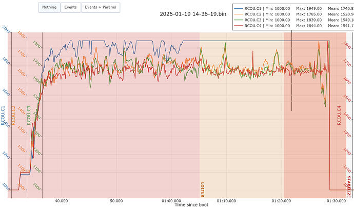

I am building a drone that works mostly fine with less weight but I suspect one motor/esc is under performing. I have been checking the bin files of my lasts flights and in RCout, C1 is Maxed out while the other motors are approximately between 50-80% of power.
Correct me if I’m wrong, I know my drone might be a bit heavy for the motors but it is inside specs, it should be able to fly right? (motors of mavic 3 and weight 1.3kg).
I already re-calibrated the ESC with dShoot300, PWM and even changed the motor but with the same results (I use a 4 in 1 ESC 60amp). What steps do you recommend to continue my troubleshooting?

You are wrong. This craft is way underpowered overweight. I don’t know what you mean by “inside spec” but the thrust:weight should be 2:1 or greater. Meaning the average motor output is ~1500µs or less at hover.

Check the C of G is correct. Look for bad solder or other wiring issues to that motor. Verify the prop is good. Also check the other motors/props. One of them may be under performing in some way and this one is maxing to make up the difference. Very unlikely that any settings would cause one motor to be that far off the others.

thankyou for commenting, I understand it is not 2:1 thrust to weight, but I have seen youtube videos of the mavic 3 carrying up to 1.5kg of total weight without descending, an this are the same motors. so it would be able to fly at 1.3kg (sluggish and slow but possible) and I have the feeling that the malfunction of one the C1 motos transaltes in overpowering the rest of the motors to try to compensate. Again this is a hypothesis I am not sure.
I disarmed the drone and saw that the ESC of motor1 was working but with no torque compared to the other 3. and the drone struggling to fly is the main reason I havent done initial tune parameters.

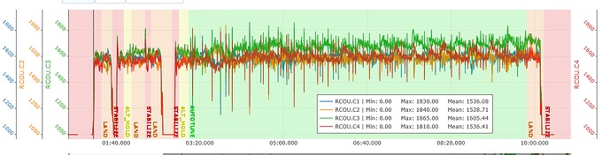

Just to keep it on the record, it was indeed a faulty ESC in the 4in1 ESC stack. even though its a heavy drone its managing very nice:
this image was in Autotune, thats why its has a lot of peaks. Thanks for your comments and recommendations
